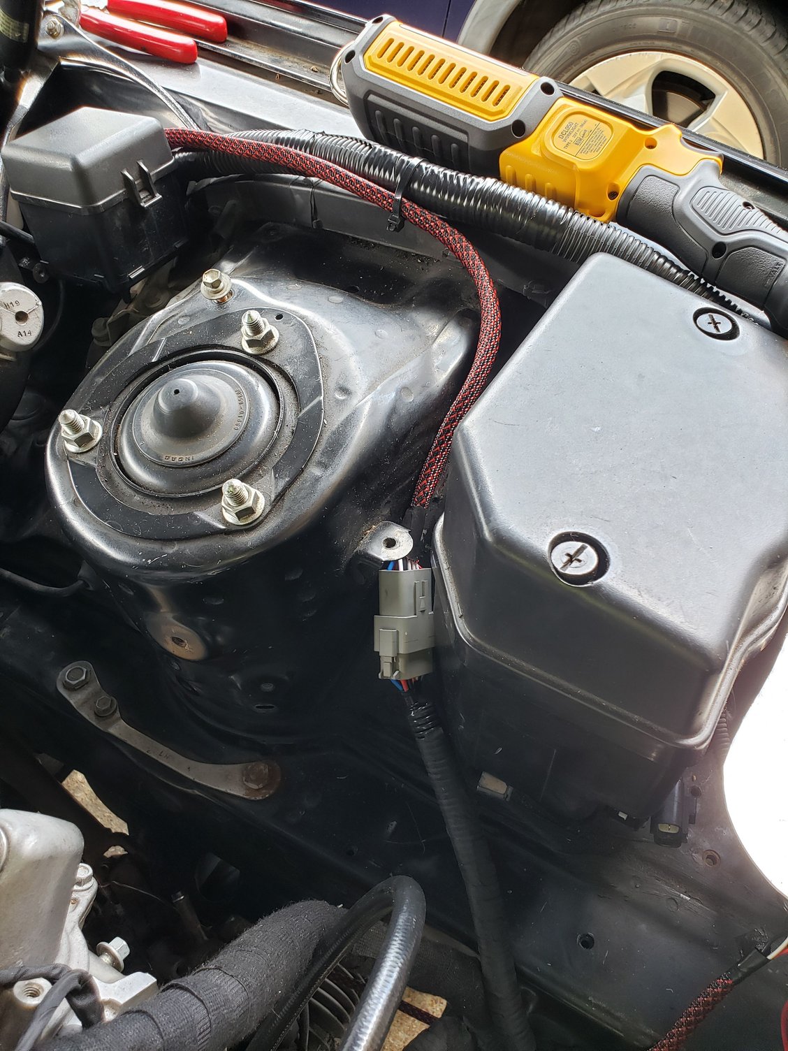

Update pics. New mount bushings, they're f250 front leveling kit bushings at 1.99" thick to replace the hockey pucks. Installed my e85 sensor, pump relay, and circuit breakers then powered up car just to check for fuel leaks. Decided to switch the plans around for accessories and going with an L84 water pump and custom ps bracket for a gm type 2 pump.
Trunk spaghetti
Water pump mock-up
Accessories and intake mock-up
Close up, the steam pipe will need slight bending no biggie. I read I needed a different cam phaser magnet sensor to clock the connection for clearance but that was not the case. L83 cam phaser cleared fine.

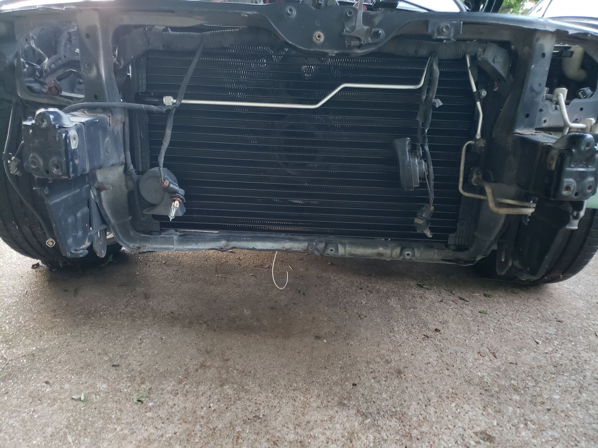

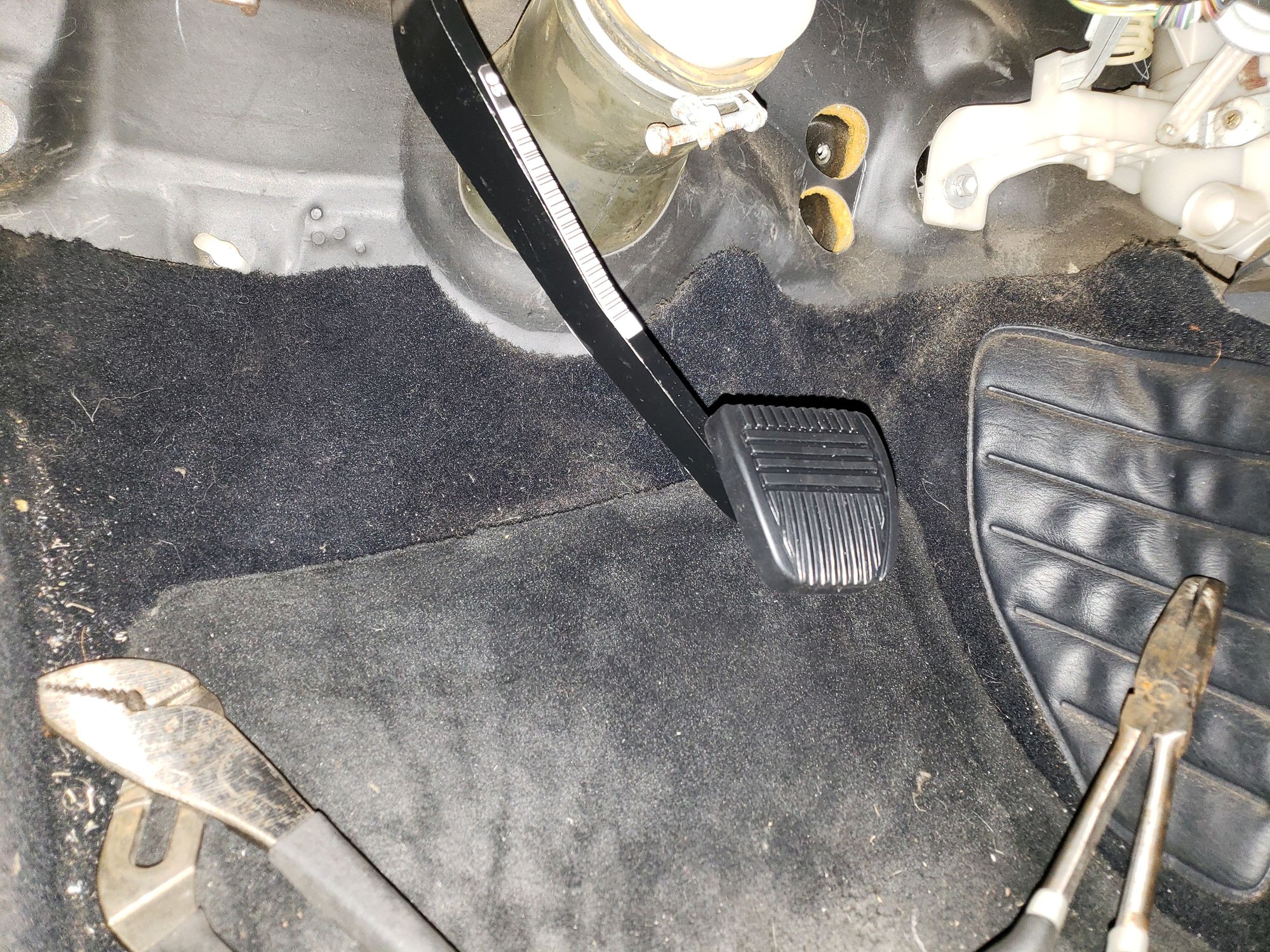

Manual brake pedal is on, and changed out the ac condenser too. For my clutch line, I'm using a -3an line to a m10x1.0 to 3/16 adapter then a 3/16 to -4an adapter to connect to my tilton throw out bearing.

87 land cruiser clutch master
E85 sensor
Pedals after instal

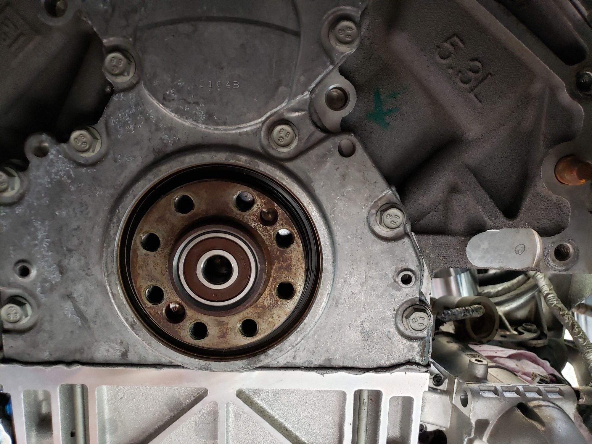

You have to slightly brake hone the crank bore to fit a 2010 camaro pilot bearing. From 1.69 to 1.70 inches

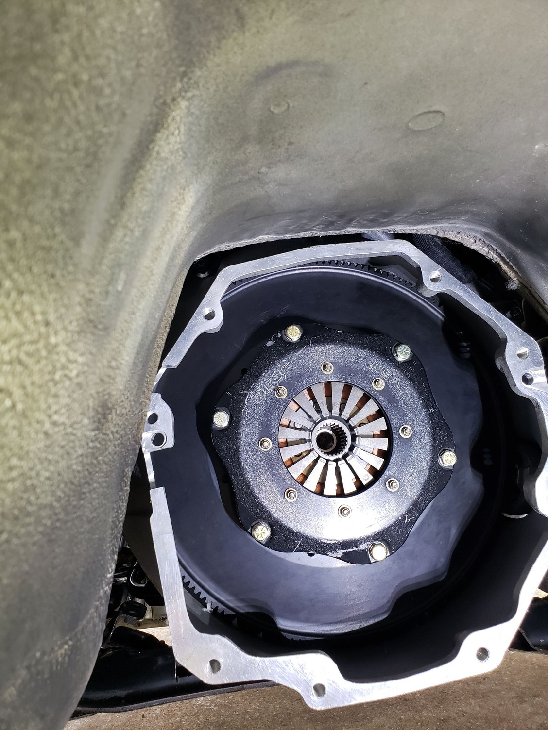

Tilton flywheel
Nascar clutch

Bellhousing fitment was not working. Pulled motor and had mounts machined down about a 1/4" also beat the firewall some more.

Still looks tight after trying to install. Going to use a hydraulic tool to expand the tunnel and going down another 1/4" on the engine mounts.
Had the input shaft machined to fit in the L83 crank flange. Pilot bearing interferes about 0.33 inches. Then dialed in the pilot bearing distance
Tight towards the top and interferes on the left side.
