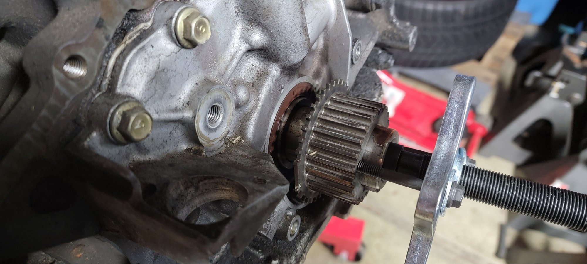

Had to buy another pulley removal kit; I got some parts off but ended up not being able to remove the lower timing belt gear because I didn't have any M6x1.0 bolts. Also still waiting on my oil pump, debating whether I should have it sent out to be modified.

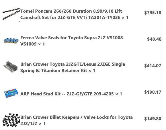

So at this point I feel like I should yank the head off to do a new oem HG and ARP studs and valve stem seals. But so much of me is saying If I'm in there I might as well do valve spring and retainer upgrade; and if I'm upgrading valve springs and seals so I can rev out to 8k.. stock cams wont be making power past 6800-7200 so I'm wondering if I should do some kelford V202-C cams, BC springs/ti retainers/billet keepers and supertech exhaust/intake stem seals. Additional cost is ~ 2k but I really want my head "re-freshened"
Then apart of me is saying, well.. This bottom end is ~ 120-140k miles; stock GTE rods have been known to bend on ethanol small turbo ball bearing turbo setups, and vvt-i would only shift that power earlier.. Should I do rods/pistons/billet mains/ARP everything? I would be atleast 4k total in parts and easily another 2k for a machine shop to tear down the short block/head and probably be safe and do a small overbore to 68.25 or 68.5 with all new bearings/line hone.. and finding a place with a torque plate which is necessary in my opinion.
Another part of me feels like I should just have the head re-done; and then I could use my current baltics' 2jzge as a spare which I have upgraded/machined "for when it happens". But then I'm torn between Do it right the first time.. Or upgrade the head and let her eat? Apart of me feels like without the ball bearing turbo, and running pump gas this bottom end would hold and last me for years; and I could save a lot of money for other endeavors or investments. But if I wanted to run ethanol or race gas and up the boost in combination with throwing a new G30-900 or EFR8474 it would need to be all upgraded.

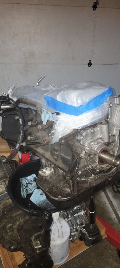

Picked up some M6x1.00 grade 10.9's and was able to pull the timing belt gear off quite easily, got all the oil pump bolts out and remembered that the pan has to come off first. But front main seal looked good after 8 years; didn't really see any indication of leakage from it.
And lastly I talked with a machine shop who does 2jz's here and they are currently only taking head work; which has me leaning more toward upgrading cams/springs/cam seals/HG/studs. Also been looking into shimless buckets because that seems like the most logical thing to do if i'm having it done at a machine shop. I will have to talk with them and see if they have the equipment to setup shimless buckets so I can order the right ones.

Decided to go for the head refresh, think I will be happy with being able to safely run 20+ lbs of boost and 7500-8k rpm

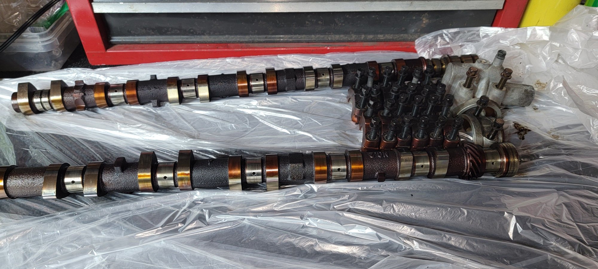

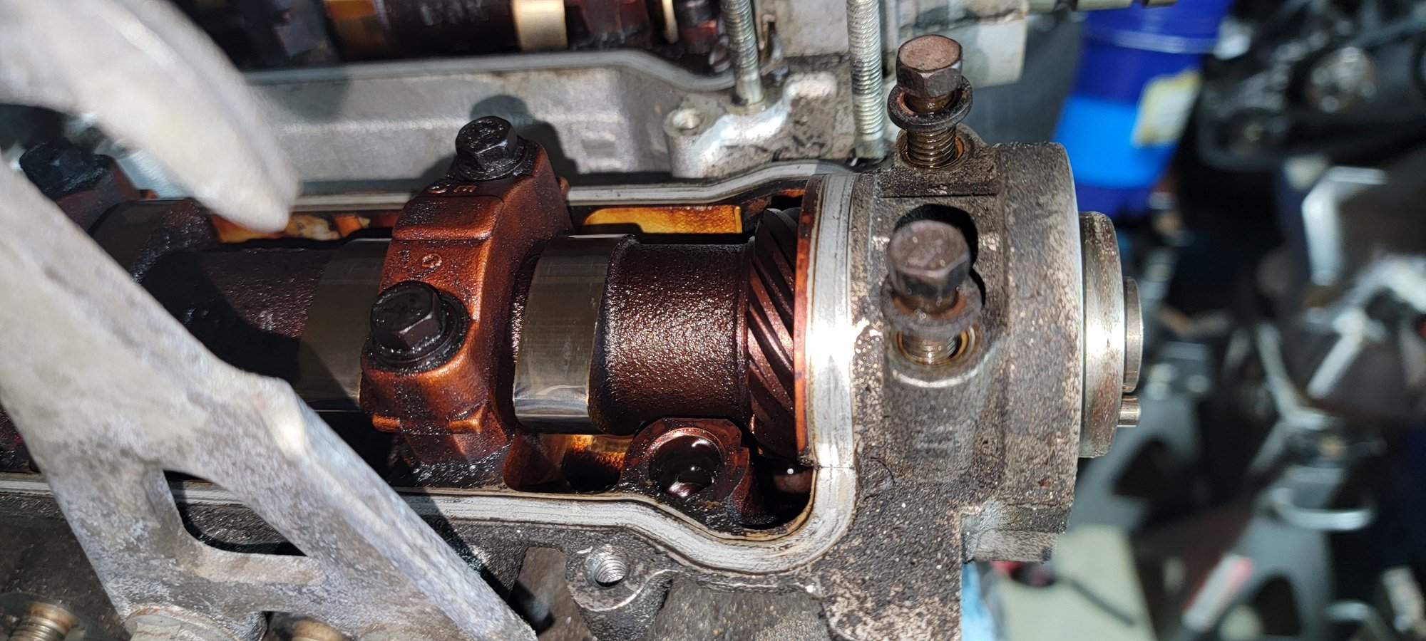

Started the process of stripping it down, my exhaust and most the valve train parts have shipped out; cams are expected to be shipped next week which is good news that the supplier i ordered from already had an incoming shipment. Really glad I decided to do this after seeing how disgusting the head is. On the other hand, the cylinder walls look great; tops of pistons look great. but sludge everywhere. Has me slightly concerned about the bottom end, but being that I'm having the head refreshed and new oil pan + pickup the rest of the internals shouldn't be very bad.

Tomei 252/260 poncams and ferrea valve stem seals arrived so I just need to drop the head off at a machine shop with the parts. My PHR 4" exhaust arrived, but the muffler was damaged by shipping, and after trying to fix it the damage to the burns muffler would be an eye sore every time I looked at the back of the car; and ultimately I would always be let down with its appearance. Lance @ PHR paid for return shipping on the muffler itself and offered a replacement. Excited to get that in, but the rest of the exhaust and oil breather is excellent finish and quality. I did have to buy a rivet tool to install the logo which had pre-drilled holes, kind of forcing me to install the logo which I thought was strange they didn't attach. Didn't bother me though because I wanted a riveter and it came out nice.
