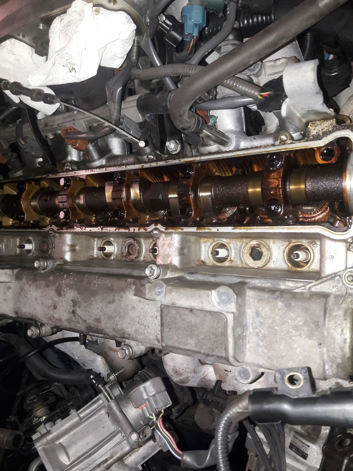

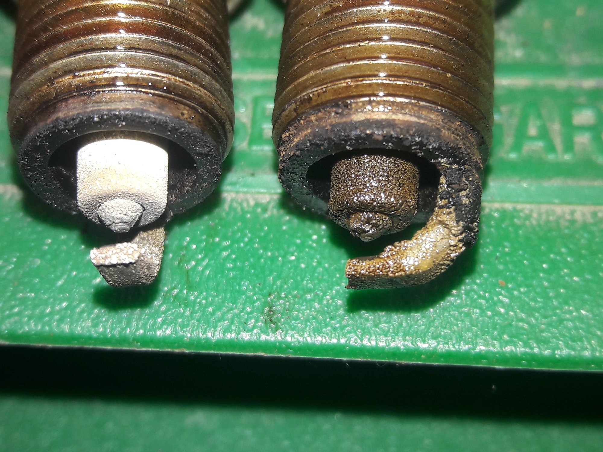

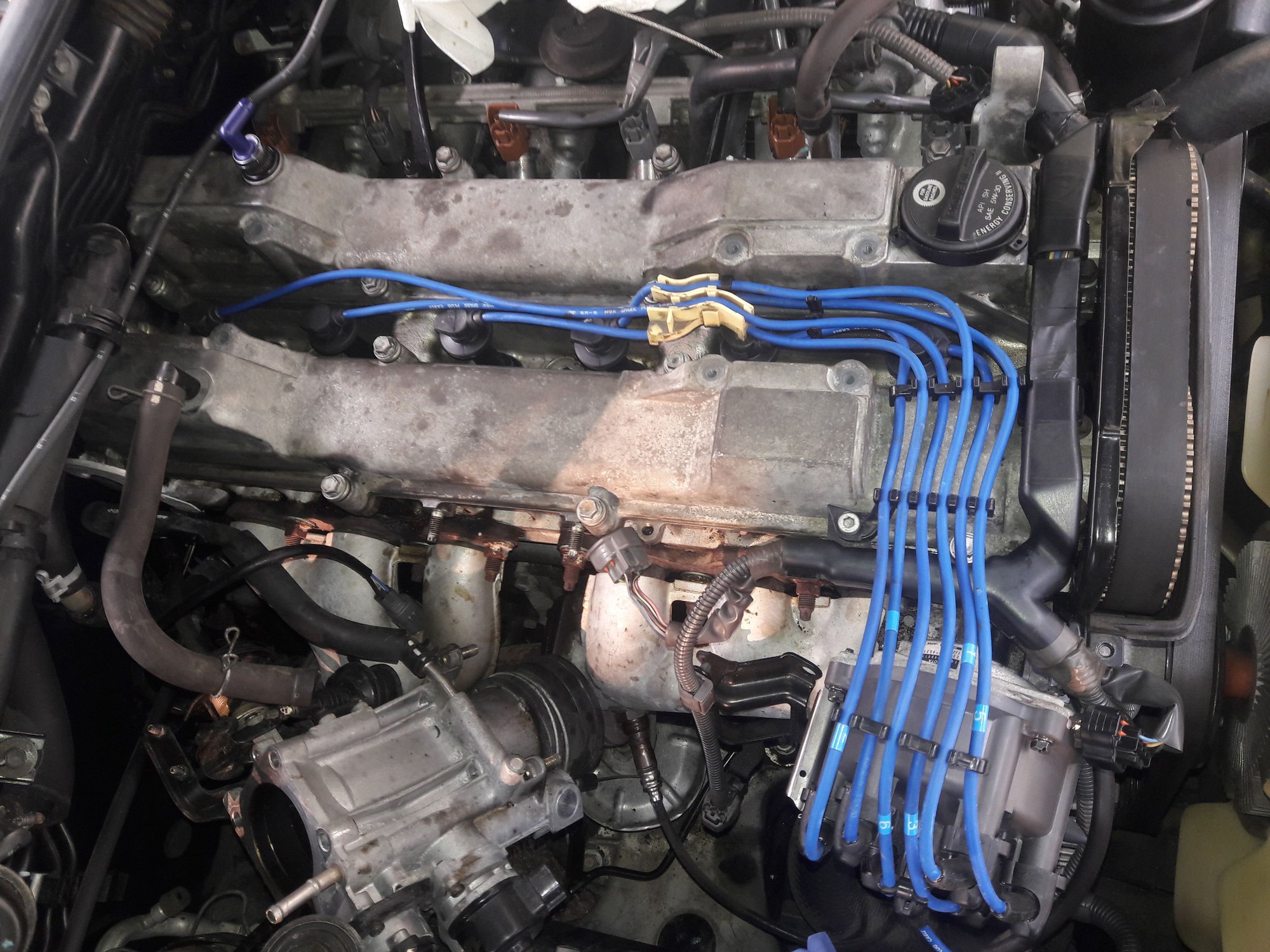

Another 2-3 hours in and both valve cover gaskets are done, new grommets; fipg on the cam corners, spark plugs, wires, cap/rotor, pcv valve/grommet. Should just take one more day to finish putting it all together. You can really tell number 6 wasn't firing well with the nasty electrode, and I'm not sure if these were OEM plugs or not. Took out denso double platinums (PK16R11) and put in denso iridiums (SK16R11)

throttle body water hose was a pain to put on. I feel like I needed some 7" bent needle nose pliers to do it correctly but its' all back together. Also changed my vacuum hose routing a little bit so I didn't have to use any caps, rear throttle body vacuum source is going to the ACIS valve under the intake mnaifold, and the heater control valve is connected to the top throttle body port, and then I looped two sets of ports. Runs great, idles so smooth you can't even tell the car is turned on when you're inside it.

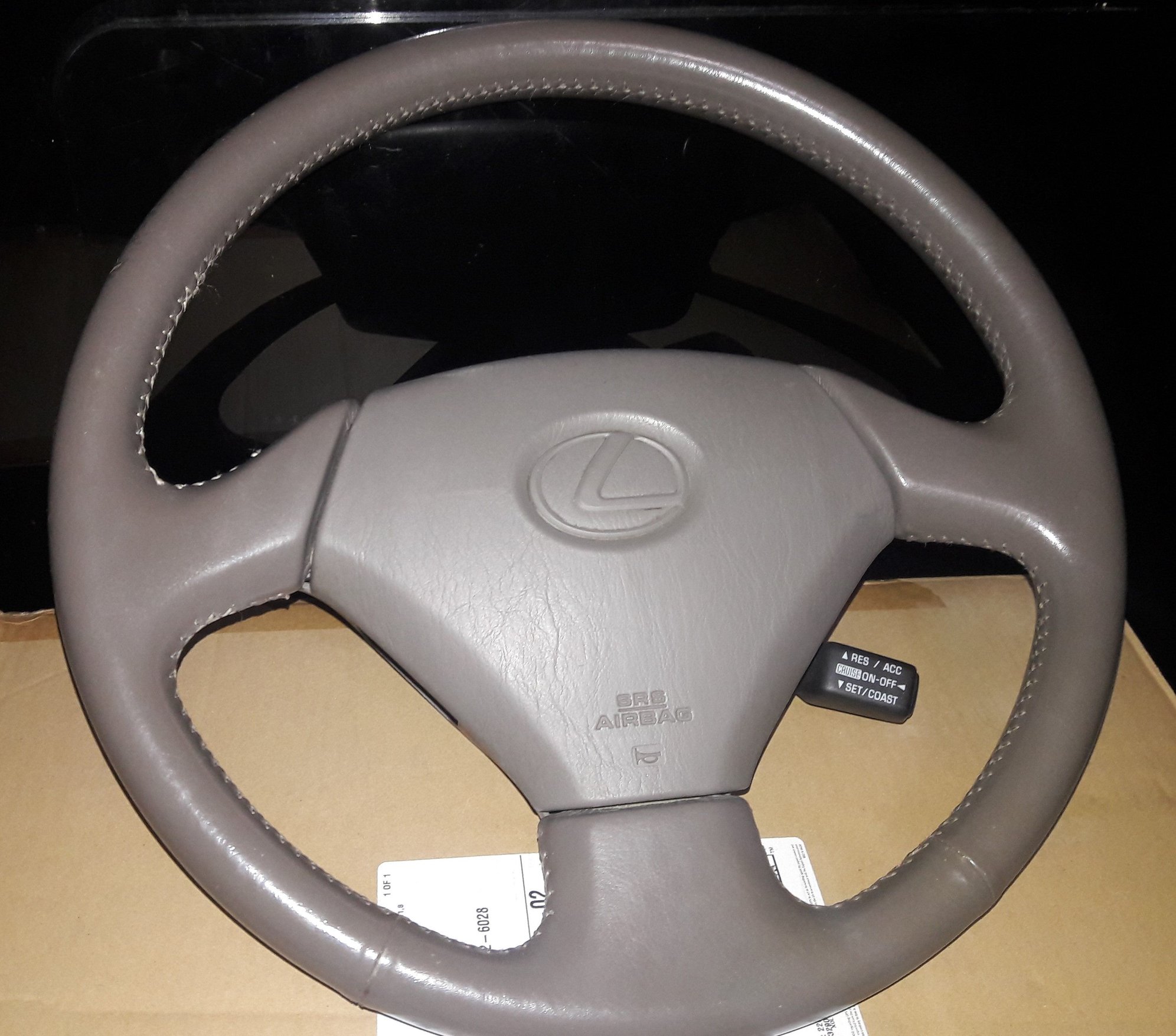

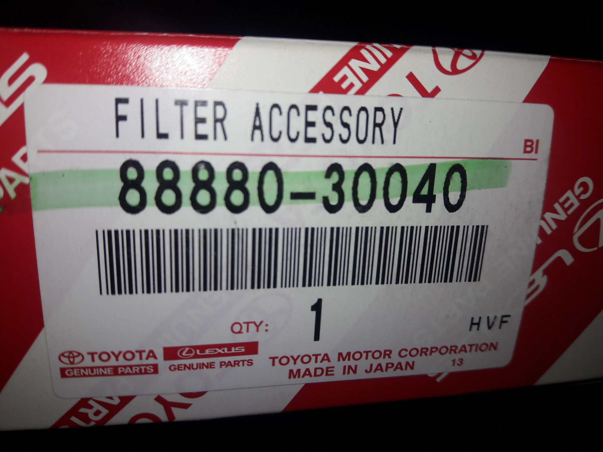

Cabin air filters were so easy to install, no tools needed and only took me about 2-3 minutes. None previously in there, and a lot of pine needles. Also my new 99-00 RX300 steering wheel came. Waiting for the adapter harness to come in from japan in a few days.

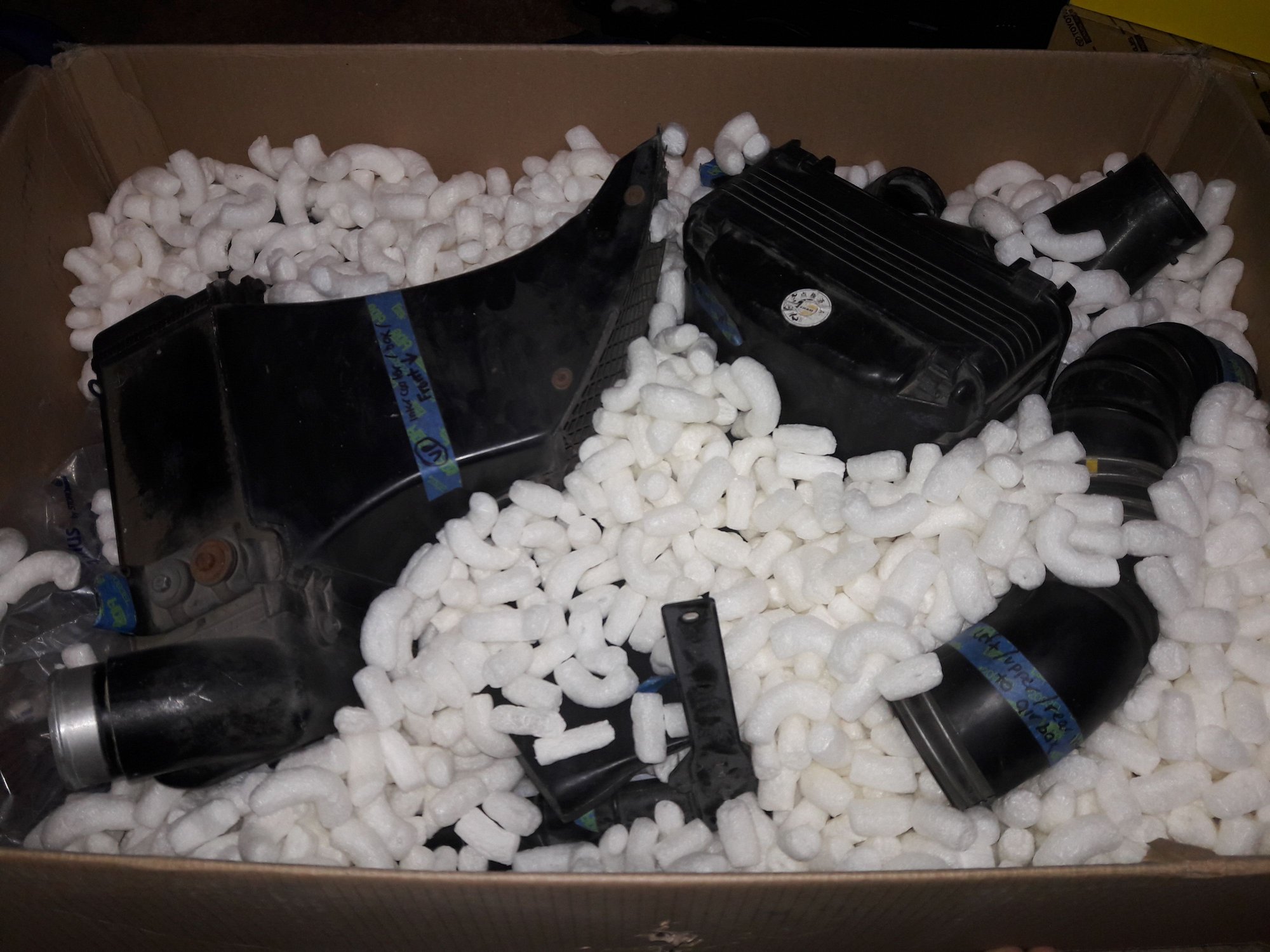

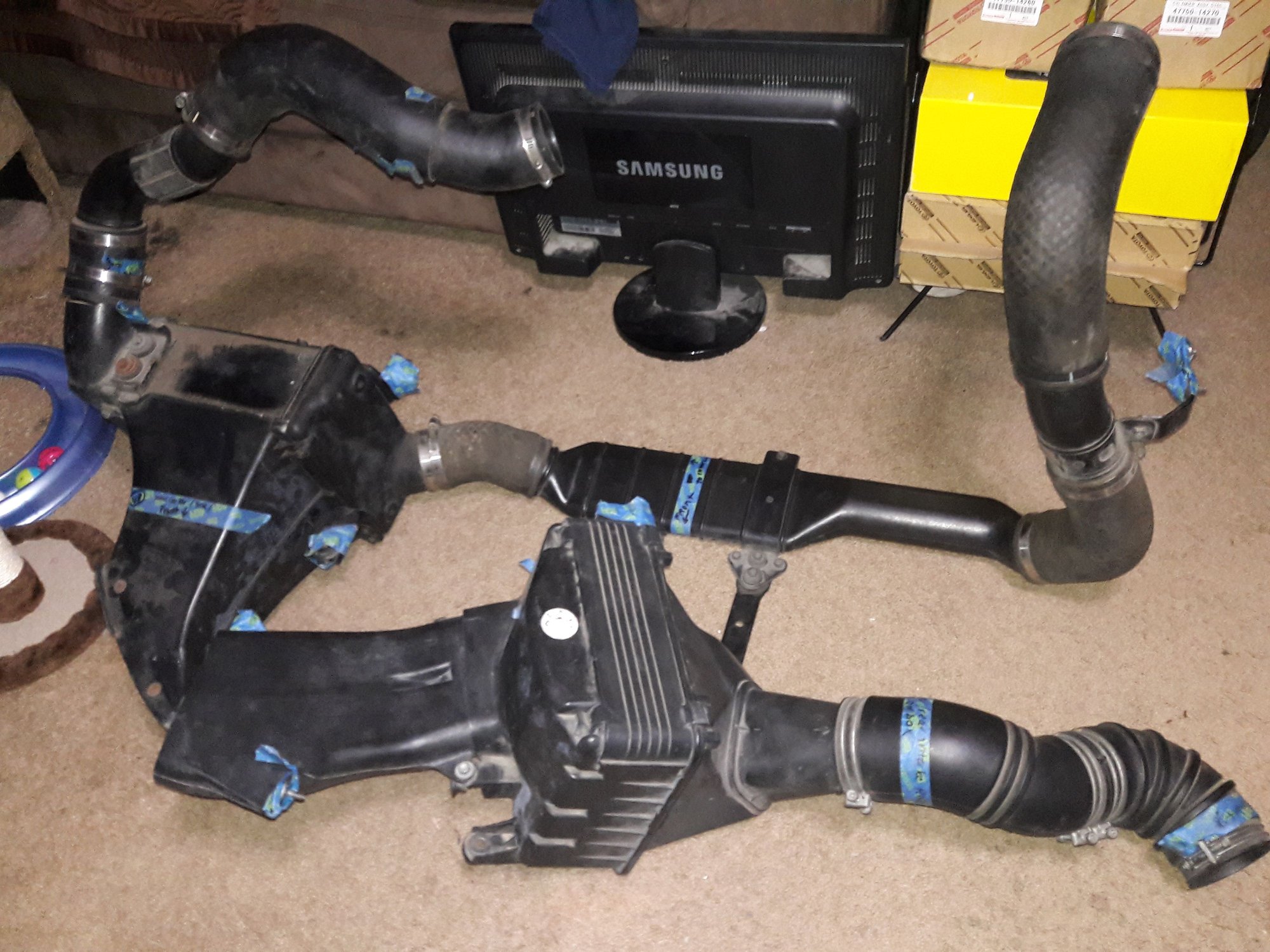

With how complete everything is up front I'm not in the biggest mood to cut it up to try and fit a large FMIC; especially with no goals in the immediate future beyond 400-450. So I decided to jump on a 91-95 SMIC setup from a soarer for real cheap. Just need to clean it up and probably replace the couplers with some new silicone. Also comes with the air filter box which looks like it will work perfect with my modified vvt-i intake w/ MAF on my 2jzgte.

To my surprise it came with all the hoses, just missing one or two hose clamps and maybe a few bolts. Nothing appears broken which is sweet. Will allow me to easily retain the oem undercovers and not have to mess with A/C lines or P/S cooler
