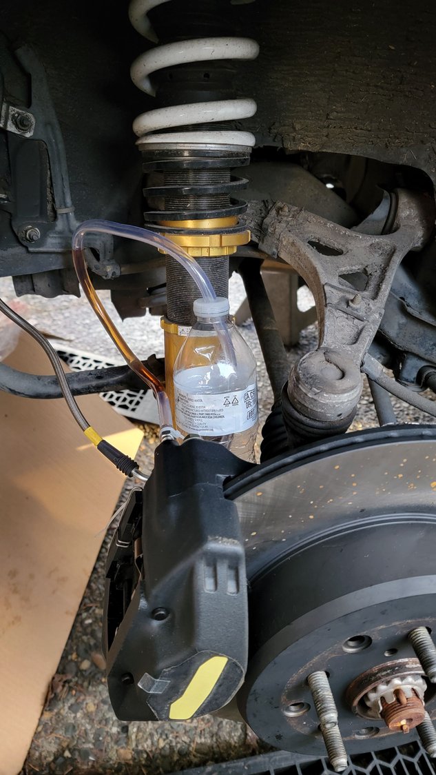

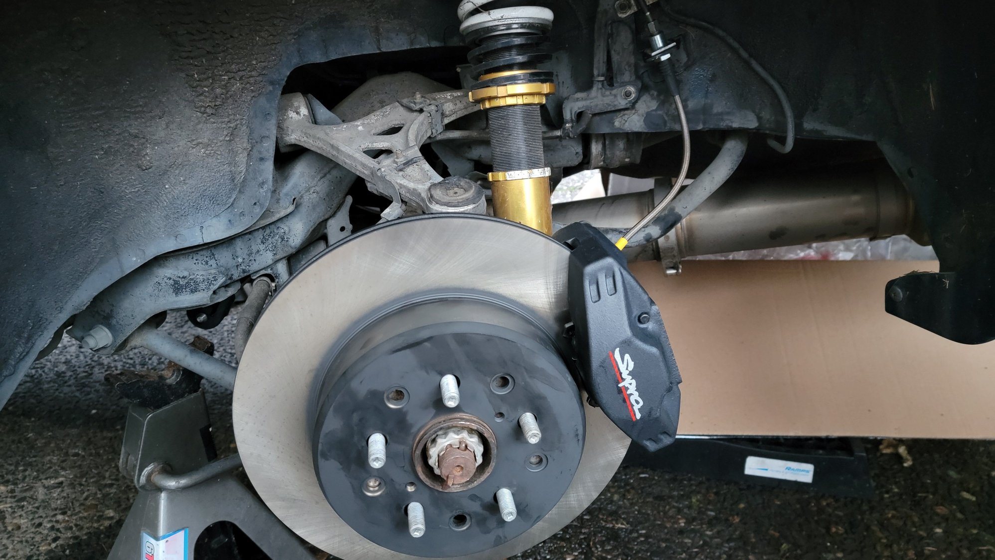

Long work week, but ended up getting the rear started last week, the passenger side went pretty well; but when doing my driver-side I should have first tried to loosen the brake shoe but it ended up getting stuck coming off; and one of the alignment pins popped off. Everything looked relatively good still, didn't really feel the need to change pads so I got new pins and retainers/locators; and had to wait for a matco toyota brake tool to come in allowing me to compress the spring with the retainer and then turn it onto the alignment pin to lock into place. A specialized tool makes this so much easier. Also put new studs in the driver-side, bled both sides, passenger; driver-side, then passenger again. Nice new fluid coming through with no bubbles. I will probably go bed in the brakes tomorrow after putting my new wideband O2 in.

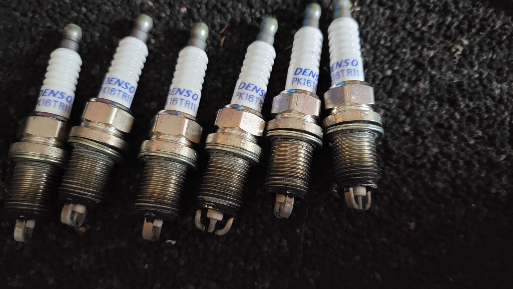

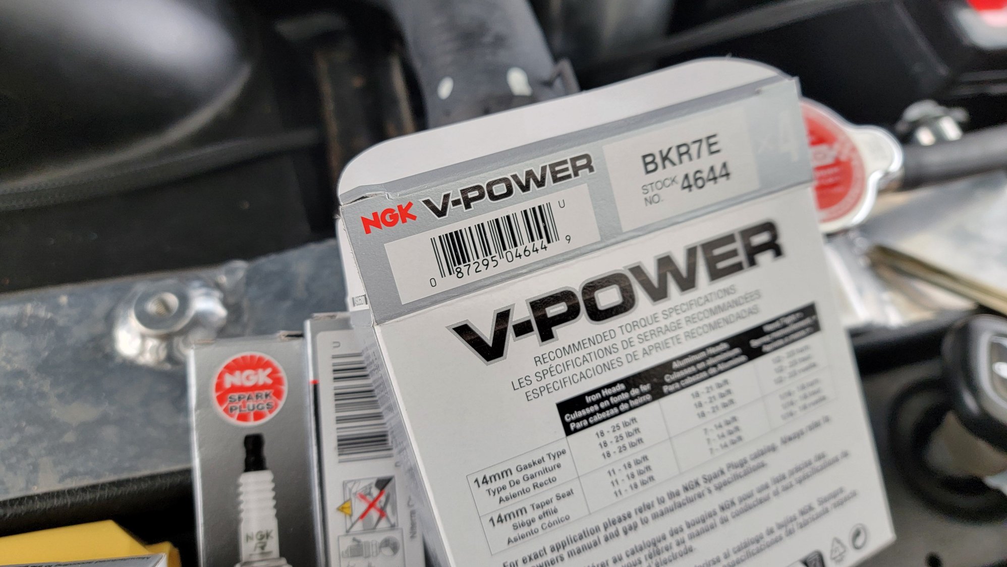

Small update, and some step backs. New plugs installed, found out the previous plugs i put in were denso PK16's, heat range 5 on the NGK scale so SUPER hot; pretty much an OEM 2jzge vvti plug and I don't know why I did that. OEM 2jzgte should have been a denso PK/IK20 (heat range 6) and most people with single turbos and boost over 13-15 psi they run PK/IK22's (heat range 7).
Ended up buying five sets of NGK 4644's (BKR7E) Heat range 7 v-power copper plugs, this actually did help my car run better; both idle and boost when fully warmed up so I think I was overheating the previous denso PK16's contributing to my misfire under boost, but more-so.. now that I have 500 miles on the car, I realized in my new logs that I'm hitting an ignition cut soft limit due to hitting a map limit set that began around ~17.5psi; and the couple times I did 3rd gear pulls I was creeping up to this causing my timing to get pulled 20-30% and my RPM/boost would drop during these engine cuts making me think it was just a spark plug misfire. You can see that here, I hit 20psi in a 3rd gear pull causing a 26% ignition cut. Although my self tune looks pretty good so far, this is clearly an issue and I cannot get tuned while I am unable to control boost.

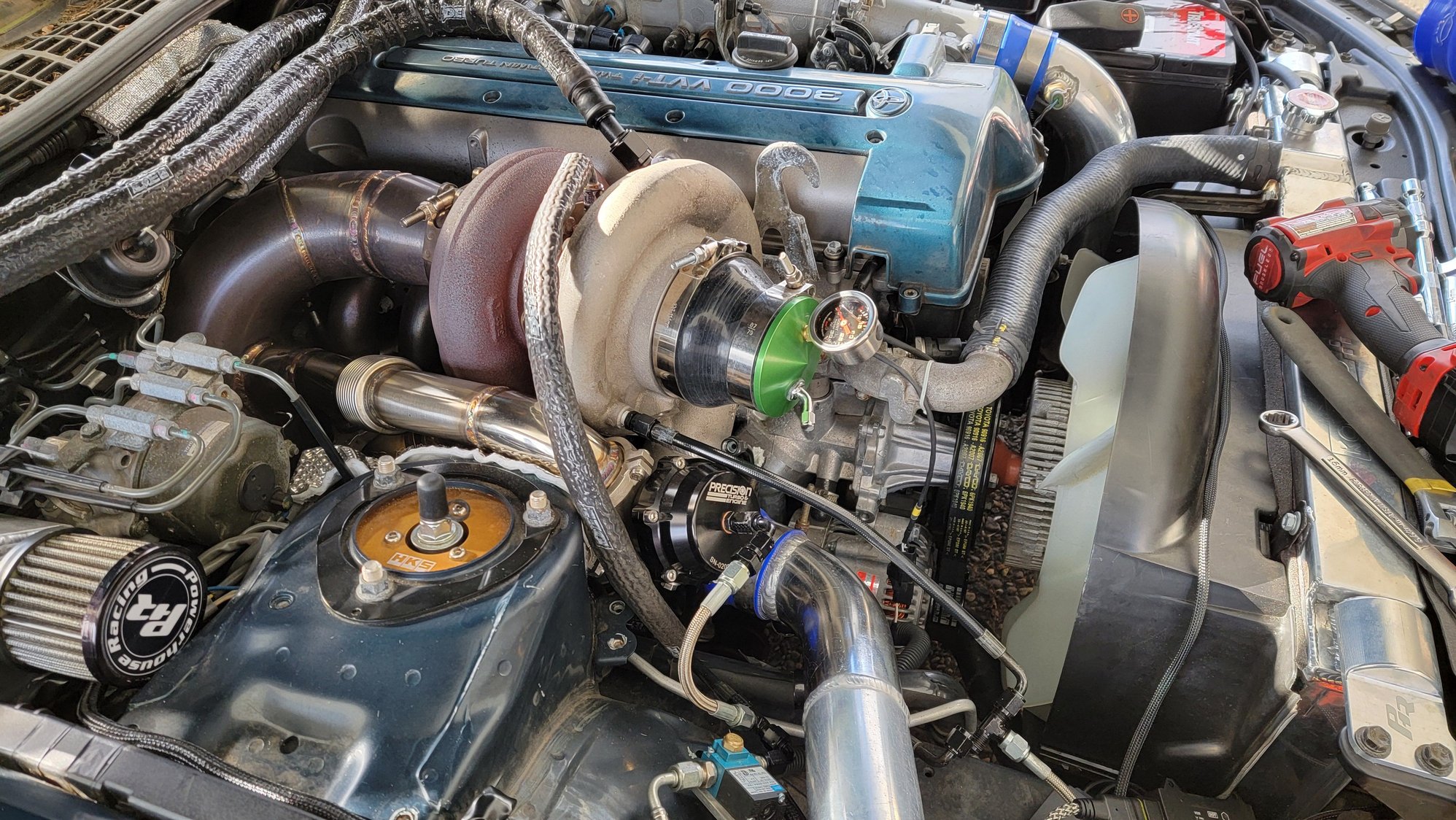

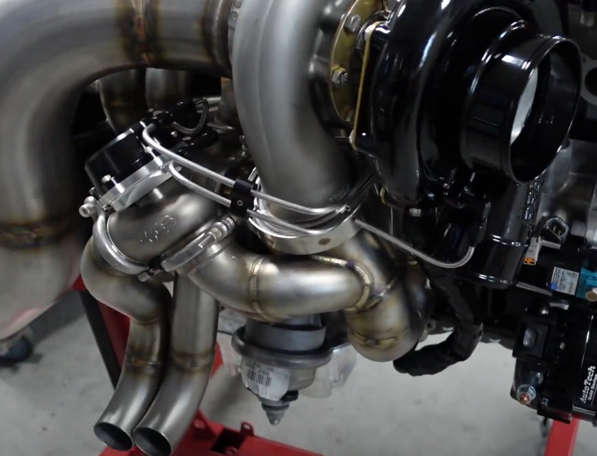

Took off the front wastegate, It seemed to be opening, wasn't leaking out of the clamps, I can see movement from the shaft and I pressed down on the valve and can open it smoothly, but it definitely feels like 10lb springs.
I put it back on, and then decided that perhaps my boost reference lines are too small, and too long. These were all -4AN lines, so I removed the lines from the top of the wastegate and left them open to atmosphere, as this should give me just spring pressure when supplying boost reference to the lower port, aka "the lowest boost you can make". These precision PW46 wastegates come with banjo's with 6mm ID vacuum line barbs; which brings my boost reference from ~ .21" ID on the 4AN to ~ .25" on the 6mm ID; marginal but this allowed me to test to see if my gates weren't opening due to boost reference.
So I went for another test drive, still hit 17/18psi in 3rd; but it did feel a little more more peppy in 2nd, spinning tires at 45 on dry roads. I think this is a multifaceted issue, the main issue is the wastegates coming off the manifold at a 90 degree angle on either side. With twin gates it still can't divert and bleed enough pressure off to prevent boost creep as RPM raises. Second, I believe my timing map has my timing under boost a little retarded as a safegard to prevent knock; as from what I've read a higher ignition timing under boost will increase cylinder pressure, make more power, but require more fuel to prevent knock/detonation. A retarded (lower) ignition timing under boost raises EGT's and will cause faster/increased boost. Although I am not wanting to mess with the timing map, I will leave that to the professional once he sets up my knock control but I believe he can reduce the amount of boost creep to a certain degree. Other than that, I don't really think I can set up the boost controller to make any MORE until I have a bottom end built, upgraded fuel system for E85 (twin pumps + fuel lines); and at that point I will have the manifold re-done to prioritize wastegates more so I can have better boost control.
Another option is to remove both wastegates and drop the spring pressure from 9.4psi to either the red 5.6 or a red/natural for 6.9 and see if having the gates open earlier will help decrease overall boost. Although it may just delay how fast I reach that point and not necessarily lower the end number. If I'm not having the electronic boost controller hooked up I can drop just the front gate pressure down to have them open at different times. Not sure if this would work.

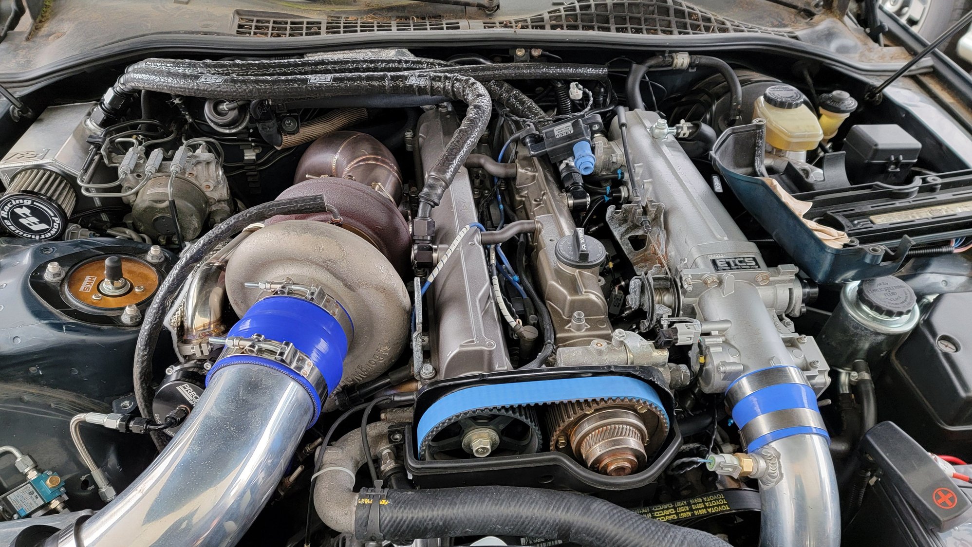

Turbine was causing my hood lining to burn up a little, so I decided it was time for a turbine blanket. Found a good rated one that said it fit S300 borg warner 16CM^2 housings and installed it with some safety wire. Little tight fit due to my valve cover fitting and wastegate pipe but its on, went for a test drive and happy with performance/looks! Top of my hood is cold after hour drive.

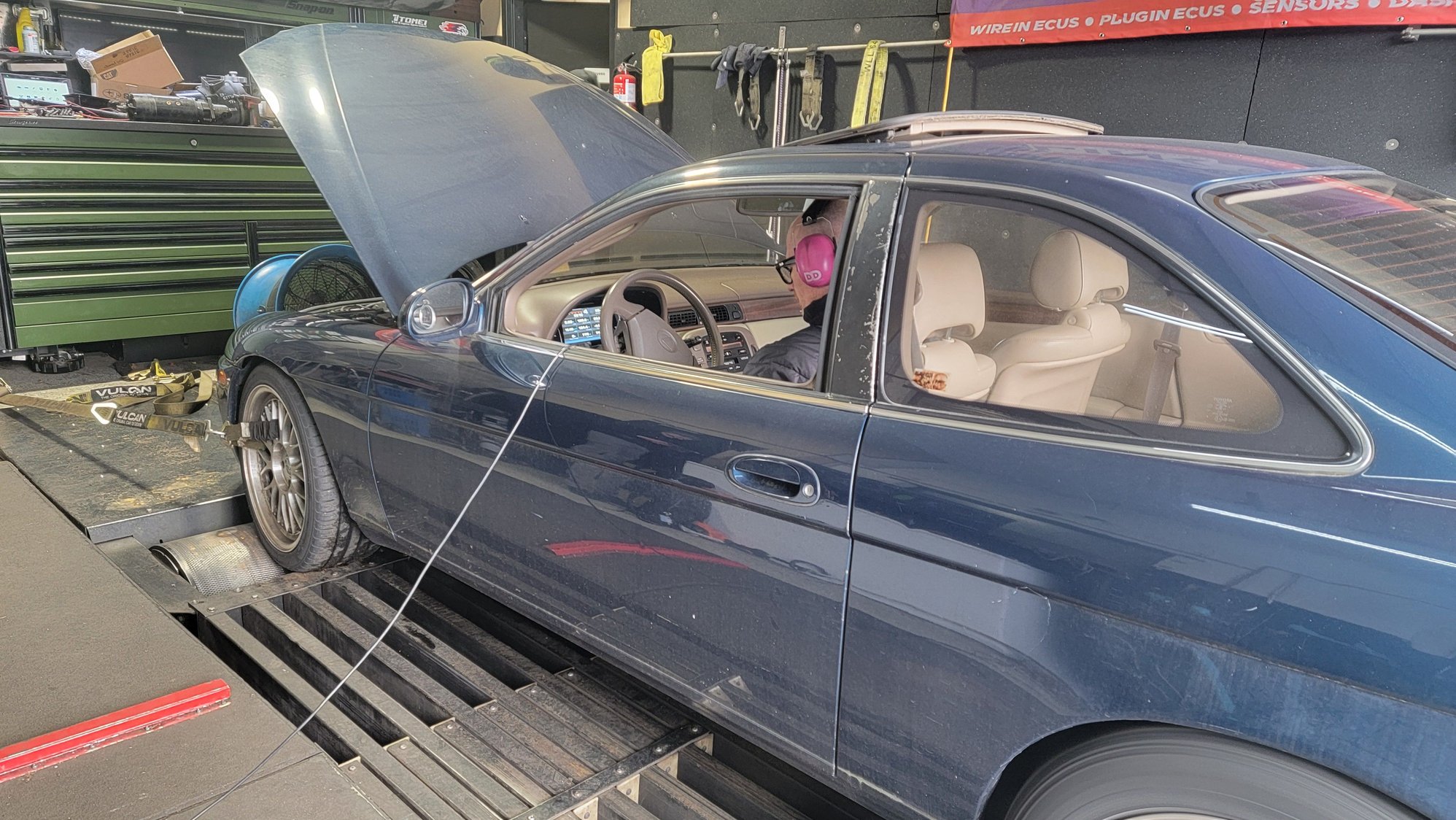

Went and had an hour on the dyno with Jason from Link ECU.
For the most part things went well, and met my expectations and also confirmed my suspicions. I knew I was having trouble controlling boost, so I removed my boost controller and ran straight spring pressure on both gates with the tops open to atmospheric and put 9lb springs in both to help limit. In 1st/2nd gear with little load it'll hit 13-14psi but 3rd/4th, as RPM increases so does boost; and I was seeing 18-20psi at redline in 3rd, and 4th on the dyno he was cutting off before 6500rpm due to boost creep hitting ~19 at the top.
The reality of this is the guy who designed the manifold did an extremely poor design of wastegate placement in how the air is allowed to escape. This is commonly known as wastegate priority as when the gates open, the air should go the path of least resistance, but when you have a 90 degree corner to turn, the air preferentially wants to go into the turbo rather than escaping the wastegate and into the exhaust, which may be seeing too high of back pressure. The recirculation of the gates only makes this worse, and I would probably be better off from the get go having them dump to atmosphere. I could also try to put a larger rear housing on the turbo, I'm currently running an .88 A/R; but I think the 90 degree exits of the wastegates is my issue. If I can fix this issue and use the boost controller; the tuner could of ramped in boost much earlier and held 17-18psi throughout the run making WAY more power/torque mid-range.
The next problem is he couldn't get my knock sensors to work, which may be a wiring issue? Will have to look into this more as I thought I was certain the studs were torqued to spec and the knock sensors plugged and clipped in. We ended the hour at 469 hp / 387ft lbs torque at 6300rpm with boost going from 13psi to 18/19psi on the top end on 92 octane pump.

I've talked with my welder and we're looking at August for me to rip the hot side apart so we can re-do the wastegates on the manifold. I wont have a wastegate facing forward any more, We're planning to have both of them facing upward toward the rear side by side like I have seen on some other builds; which should make plumbing them a lot easier, have better wastegate priority and also less backpressure with the gates dumping straight down. An example I plan to emulate is PHR's setup as shown here on Pure Functions build
