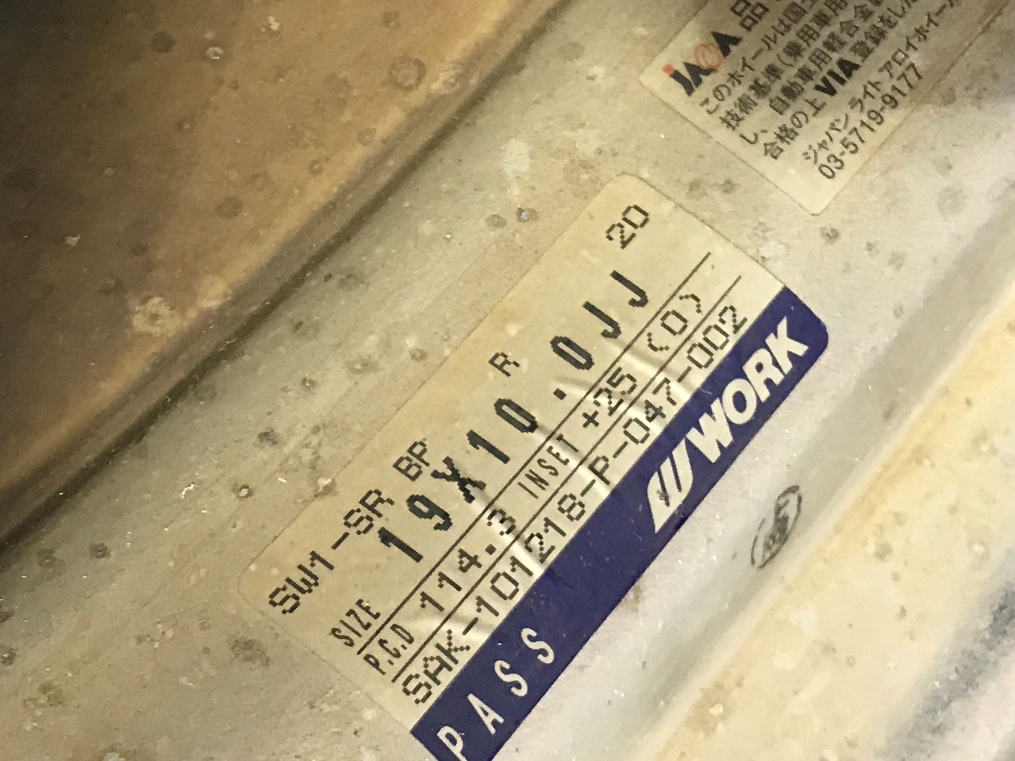

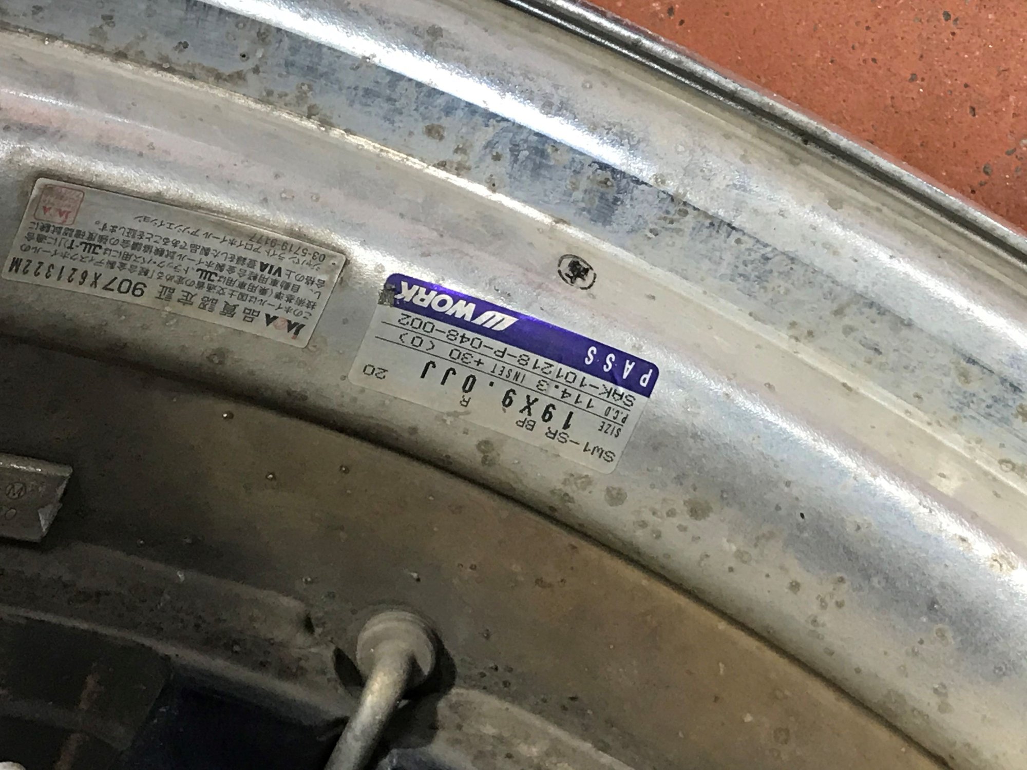

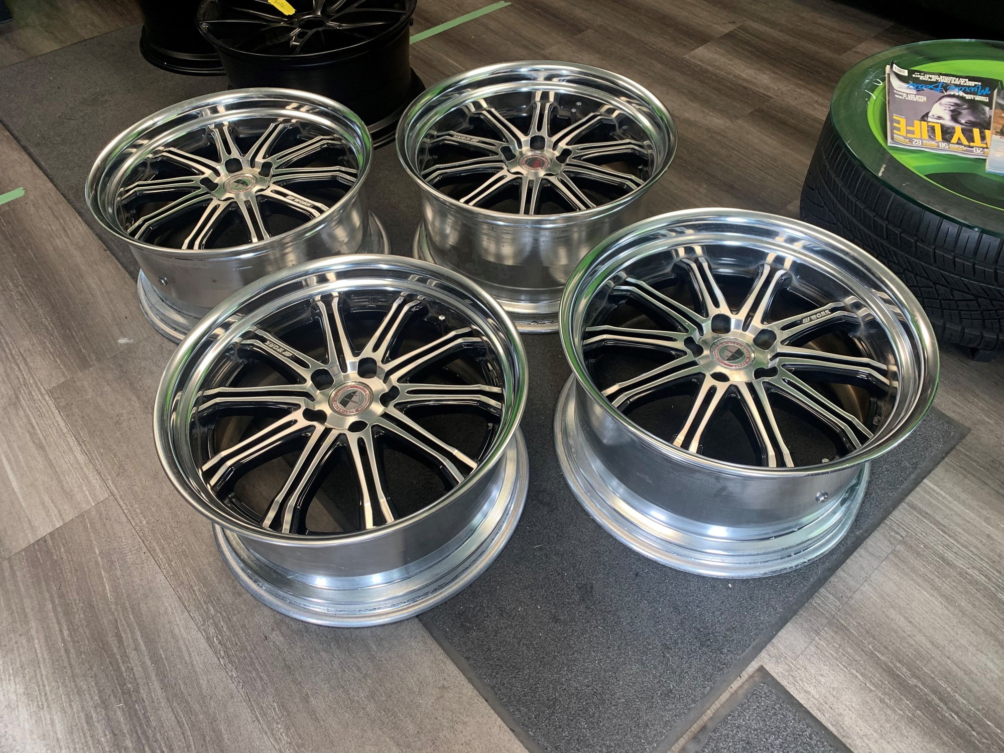

Hey guys I need a bit of help choosing tires for my current wheels. Vehicle is a 1991 Soarer with adjustable coilovers.
Wheel Specs:
Front 19x9 +30
Rear 19x10 +25
Can someone advise what are the optimal tires to use for this setup? Also if someone could post photos of their soarer/sc with the same(or similar) offset, that would be greatly appreciated!

I ran a set of SSR’s with similar specs but they were 18 inch wheels. I ran 235/4018 up front and 275/35/18 in the rear. I had to shave my rear fenders and roll the front fenders.
I have a set of 19 inch wheels currently that I fit the same width tires on but my wheels are 19x10/19x11 instead. I didn’t have any rubbing issues. I later switched to 265/35/19 up front and 305/35/19, but the rear rubs a lot.
You could safely run 235/35/19 and 275/35/19 without any trouble

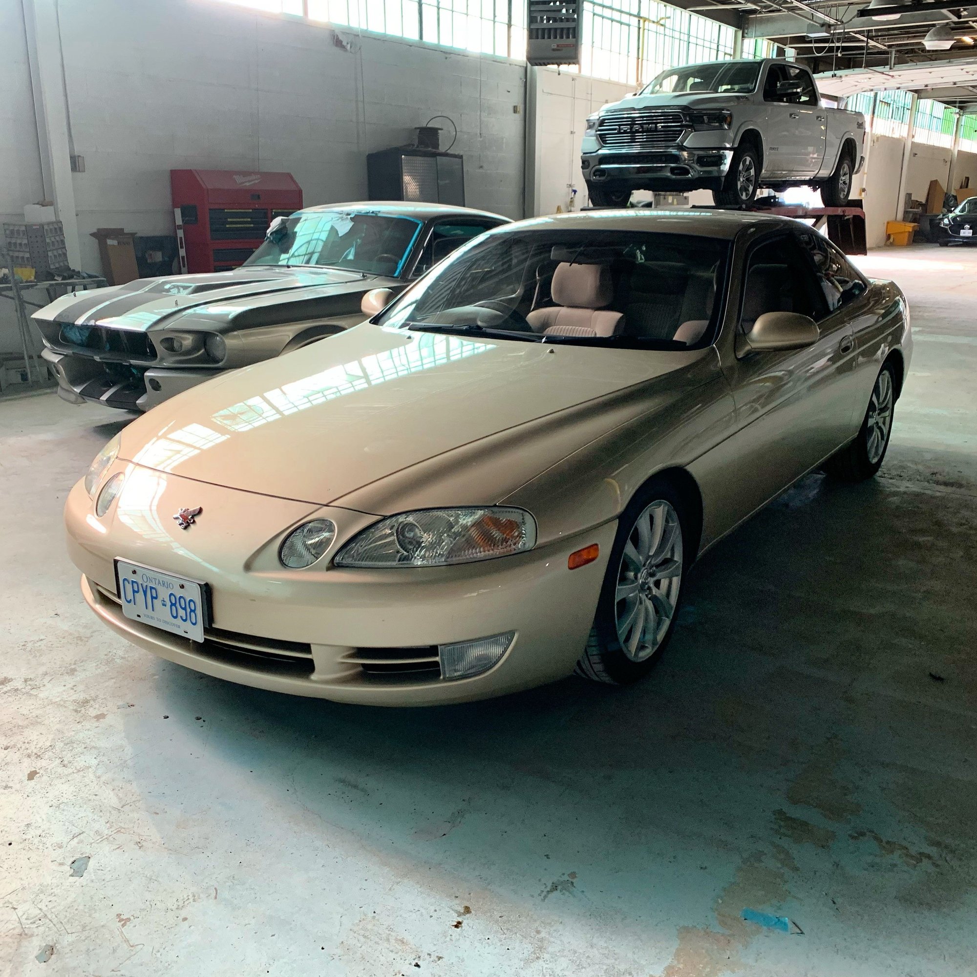

are we just going to ignore the mustang 'elenor' replica sitting in the back? WANT
I noticed that in the background too. It looks really nice.
