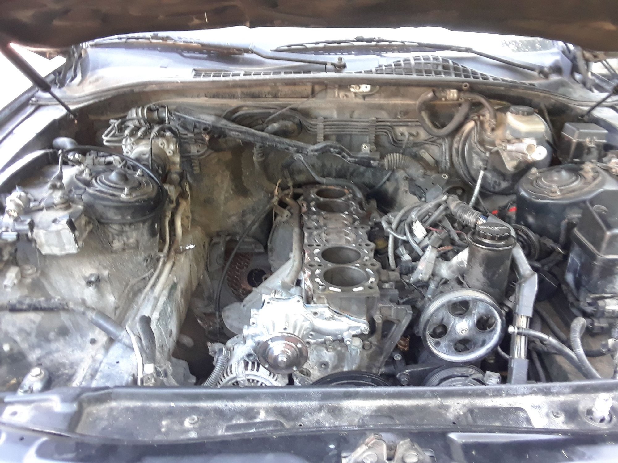

I just bought a 1993 Lexus SC300 for $300. The head was blown, a little interior is missing and the exhaust obviously needs work! haha.
Im just curious as to how you guys would go about building this motor. its the 2JZ-GE correct? the GTE for the supra only stands for turbo, other than that everything else is identical from what I read, but I would love to hear yall's input regarding how to fix this motor back up; I'm more of the 8cyl type but I've LOVED the 2JZ, for the obvious F&F reasons, ever since I was a young boy. the outside is in great condition, hoods got some obvious wear from the sun, gas cover is missing as well. I wasn't given the head, and from what the prev. owner said i wouldn't have wanted it anyway(was that a mistake?)
What would it take to build a decent head to later support a turbo, what turbo should I use( yes yes i know, use the search bar) what problems should I look for fixing this car up, whats in store for me on this build, etc etc... I really want to do this car right, I dont want to rice it out, lowering with some awesome wheels( great user input of which wheels to look at or even sites/links to the wheels would be great), what suspension parts should I upgrade for lowering, which parts, etc etc on this one...
but mainly, where should I start on rebuilding a head, or where should I find one first of all? Like i said, I do want to build it for later turboing when I have the money for it! lol

It shouldn't be too difficult to locate another 92-97 GE cylinder head and intake parts to get it all going again. If you're already at this point with it it's a perfect time to pull the entire engine for a refresh and turbo build.
We're here to help you with details, recommendations and many of the ins and outs of these cars. First thing is to think about and decide how you realistically want to use the car. I agree with - V - that even a mere 350-400hp setup will be plenty to completely transform the car and would even be perfect as a daily driver if set up well.
What you've heard about the GE vs GTE engines is partly right but it's more like this: the GTE engines were developed first and *then* Toyota developed the naturally aspirated GE engines from them. Thus, all the turbo specific parts were not included on the non turbo variants and a different intake system was used in order to increase low end naturally aspirated torque, plus a simpler and more common (for the early 90's) distributor ignition was used vs the coil on plug ignitions on all GTE's.
What did not change from the GTE spec other than the GE's factory 10.0:1 compression ratio and lack of piston oil squirters was the strong turbo-ready forged crankshaft, tough as nails cast iron block, turbo-ready connecting rods and strong turbo-capable pistons and rings. 1998-2005 VVT-i 2JZ-GE's got weaker rods, pistons and rings but those are upgraded in turbo builds all the time. Your car does not cover the VVT-i years anyway being a 1993 so you already have the strong rods, pistons and rings.
Just switching to a 2JZ-GTE OEM head gasket over the GE head gasket will bring that compression ratio down to about 9.2:1-9.3:1 or so. Strong ARP head studs are recommended.
There are many details to get you into reliable turbo territory but the bottom line is that the GE engines from 92-97 are very turbo ready if their compression and leak down test numbers are all good. Several supporting modifications are required of course but the GE engines themselves are built for turbocharging even though they didn't come that way stock. If you're a V8 guy and like power you will not be dissatisfied with a well set up NA-T 2JZ-GE or a swapped in 1JZ-GTE or 2JZ-GTE.

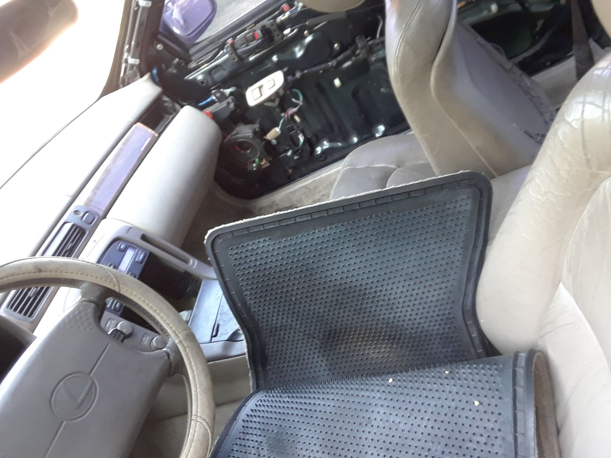

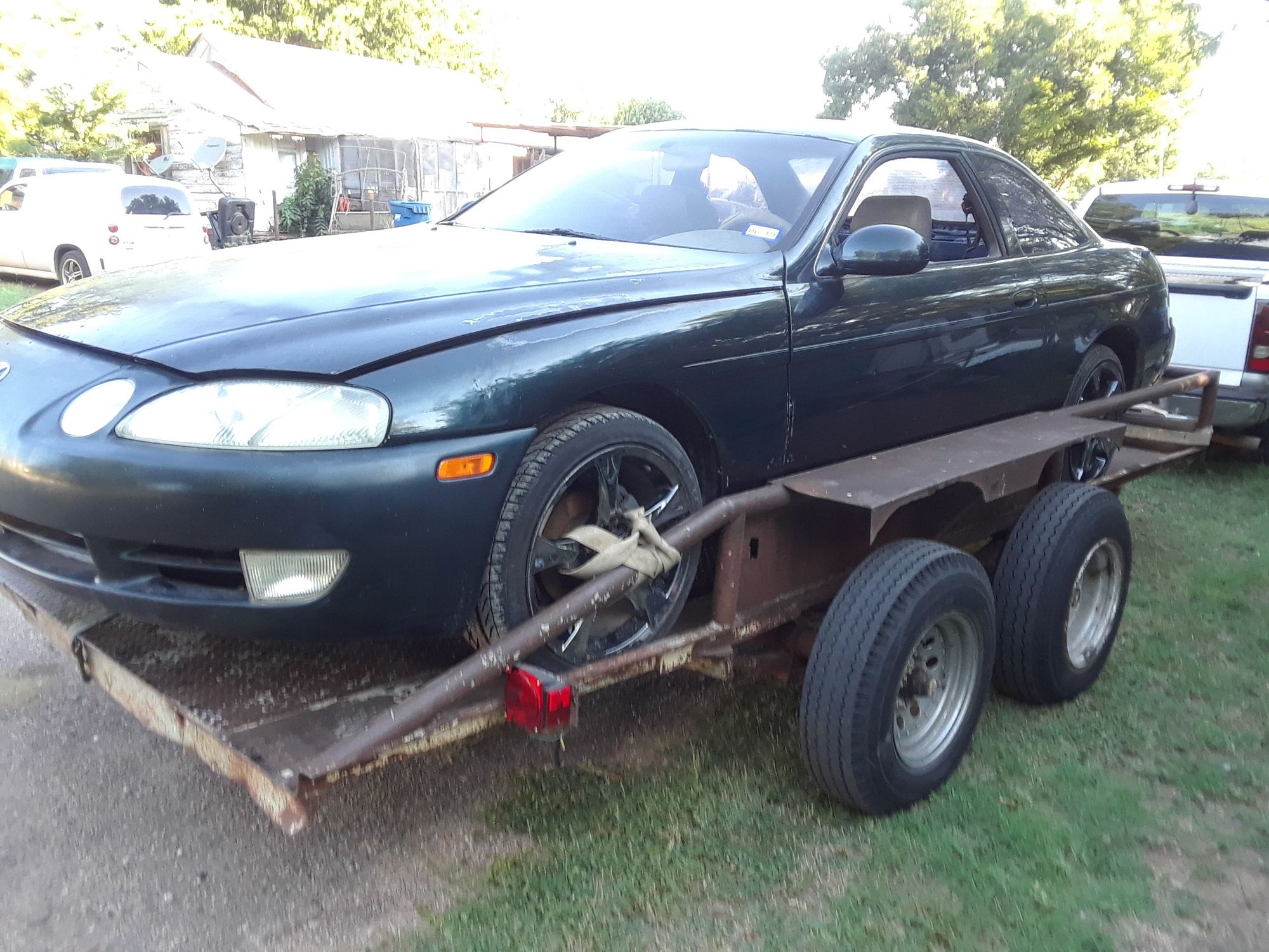

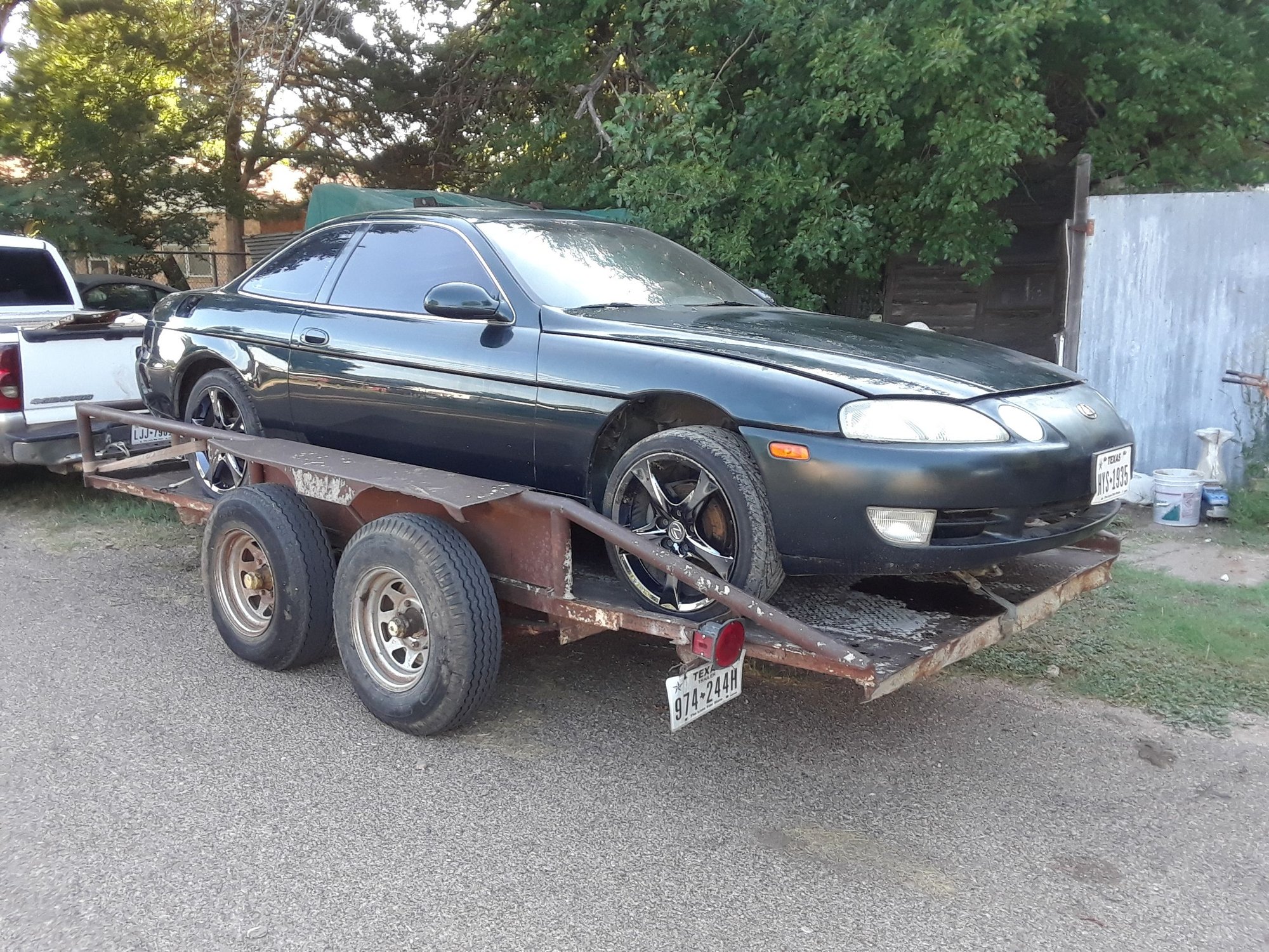

performance wise, i'm not looking for anything crazy- i want to make sure the car's in working order first- starting with the head to make it strong. nothing stupid expensive, but i do want to build aftermarket into it. i have no idea what shape the transmission is in but they had said it was fine, which is a spectrum all the time. a new fuel system would be nice too since its obviously gotta have plenty of fuel, haha. whatever turbo you guys recommend building into would determine how solid i'd go on head parts/rear end parts for sure, but im sure ya'll have the best information to build something around the turbo. that said, anything over 400hp would be nice- it only being strictly a street car (with some fun play in it) 650 tops before things start breaking and more money needs to be sunk into it.
suspension wise- i love a great cornering car. this model looks pretty slick lowered, so that'd be something else i'd love to do. again, nothing super crazy. i mean just a little tuck if that- maybe bigger wheels to an inch, or inch n a half- may have to look at what drops are what on these cars. brakes will be taken care of as well- i have cross/slotted on both my other cars and i do enjoy those.
interior would be the last thing to take care of, some diy carpet, buckets and put the bells n whistles back together on the car as the unit is gone as well as the back interior/passenger door panel.
the car wont be going anytime soon so if i can save here and there to get a few things or a thing at a time i think it'd be a fun project. thanks again yall for commenting and asking- here's a few pictures of what I got!

All of your goals are very doable. 400hp and excellent handling are well within the capabilities of this chassis. For its size once it is set up well it drives like a slightly smaller car than it actually is. Lexus set them up a bit cushy and slow from the factory but all of that is easily corrected.
I am not the most well versed on the latest and greatest in the NA-T world but a good 2JZ-GE head, a Treadstone turbo manifold and a small modern 57mm-62mm Precision turbo will probably do an excellent job to achieving what you want. Many other options out there as well. Injectors choices aside you can probably get away with wiring in Aristo 2JZGTE non-VVT-i ECU and oil pack ignition using the GE distributor as the cam sensor trigger. A crank angle sensor signal can be had by swapping in a new 1996+ SC300 Aisin oil pump which has the factory crank angle sensor location on it (works the same for GE's and GTE's).
You'll need to pull the engine and pull off the oil pan to tap for the turbo oil drain anyway so it would be a perfect time to install the newer style GE oil pump with the crank sensor location on it.
