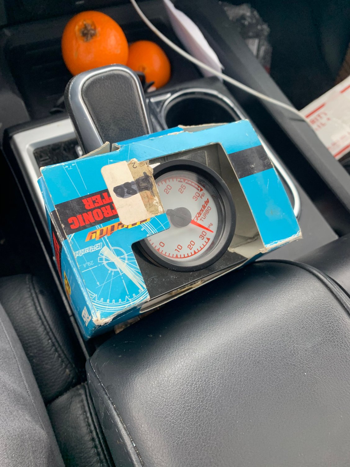

More parts have arrived! I got a Greddy boost gauge (reads in psi), a clear timing cover
and my Ecumaster EMU Black!

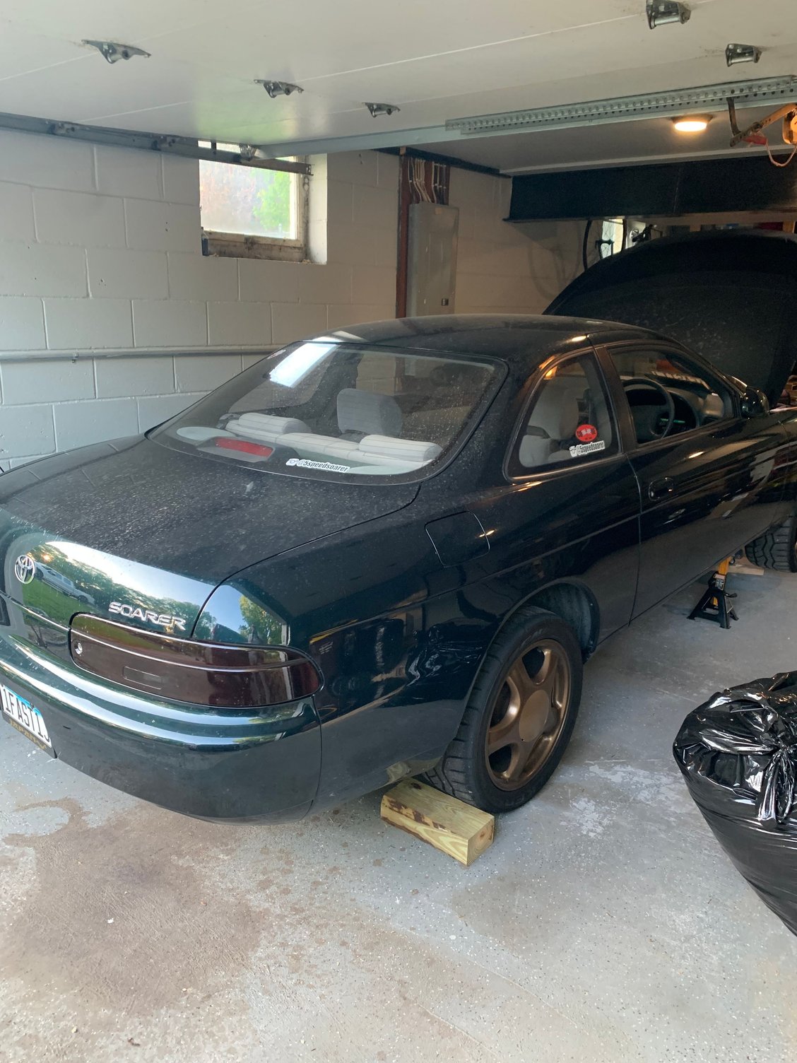

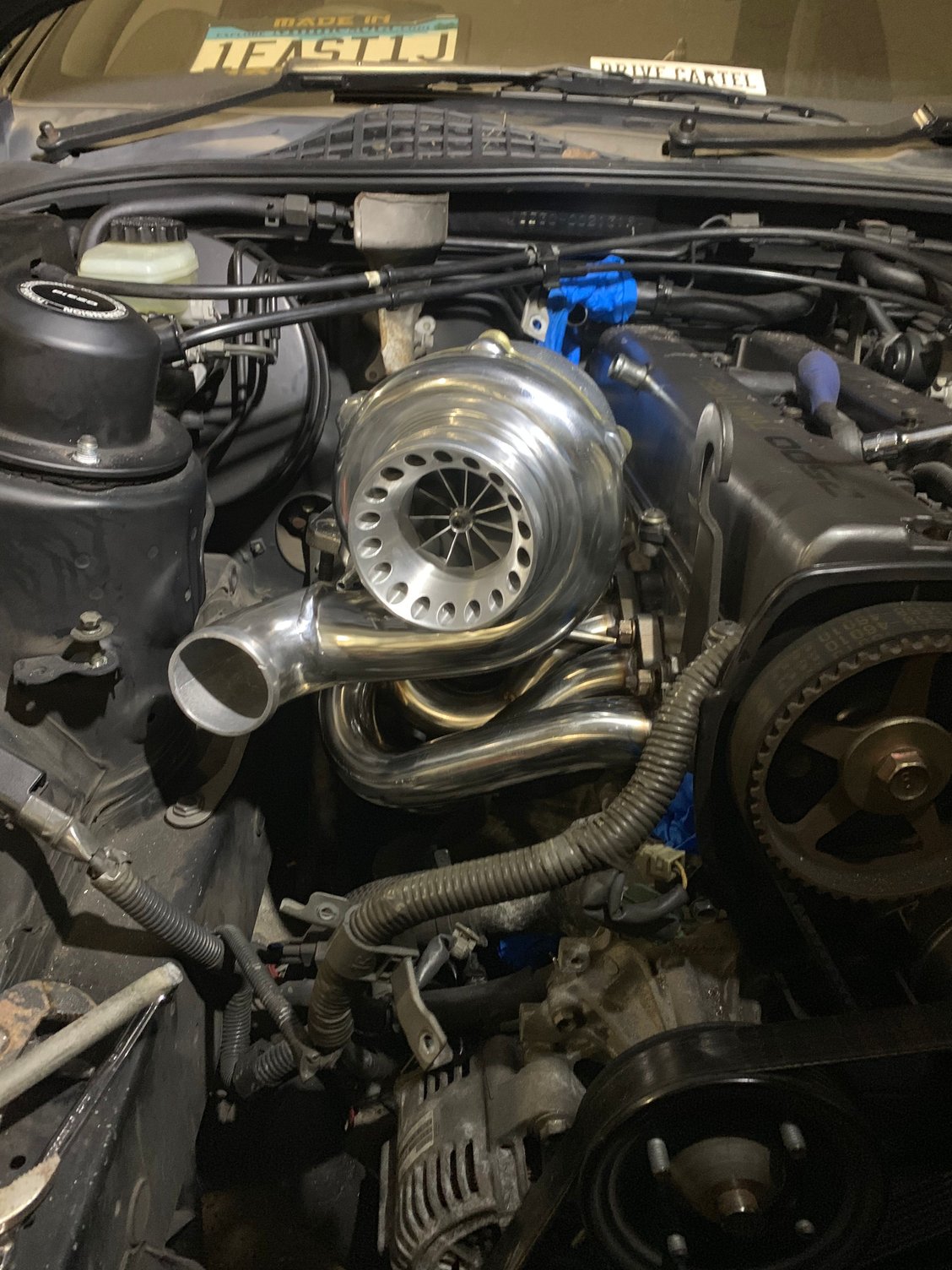

Well I FINALLY got the stock twins setup off and since it was so late just mocked up the turbo and manifold. Boy does she look pretty!

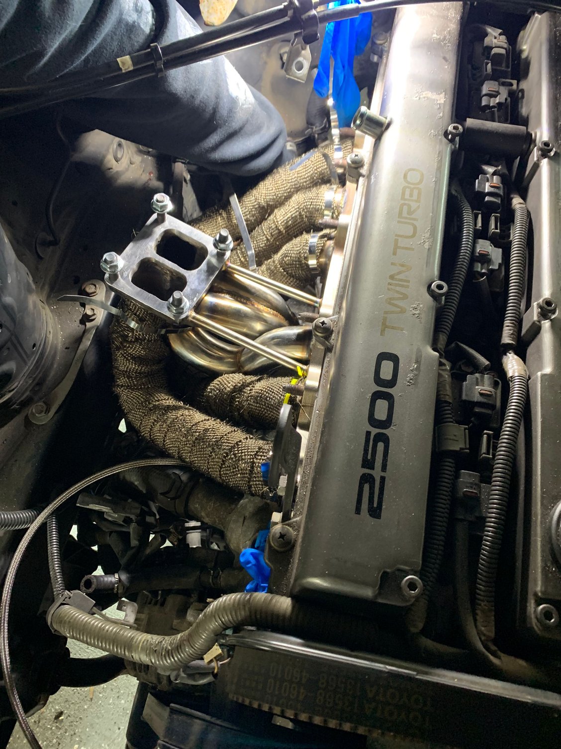

Good progress yesterday. All I can say is this DM kit is awesome. The only thing it didn’t come with was a way to plug two coolant lines from the stock twins setup (so far). A couple pics to follow.
Old Mar 28, 2019 | 09:16 PM
MNtyler's Avatar
MNtyler
Joined: May 2018
Posts: 58
From: MN

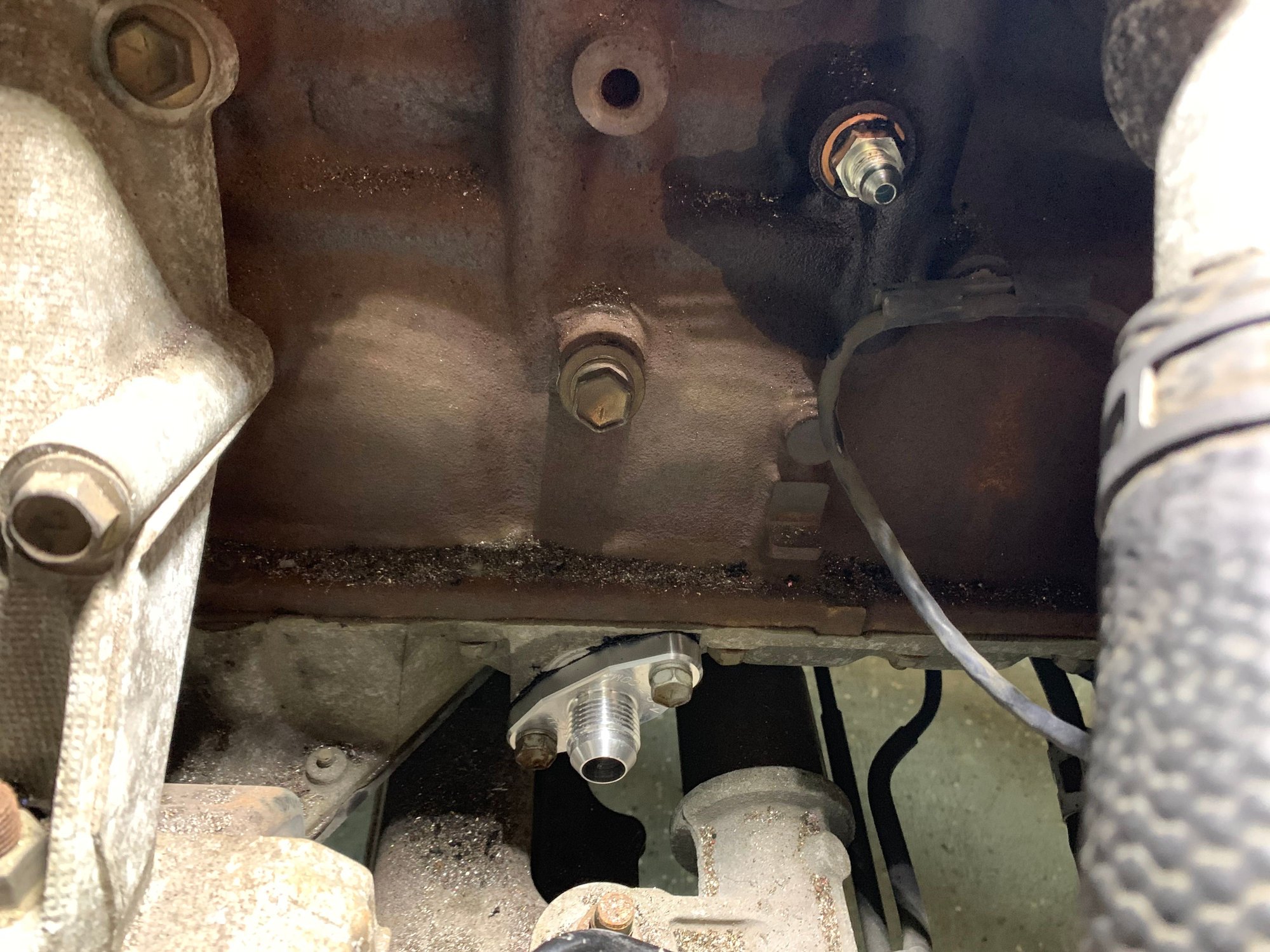

Fittings go in nice and easy.
Comes -6 and -10 line for the oil lines.
Wrapped the accessible parts of the manifold lol.

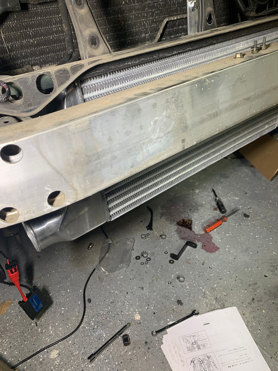

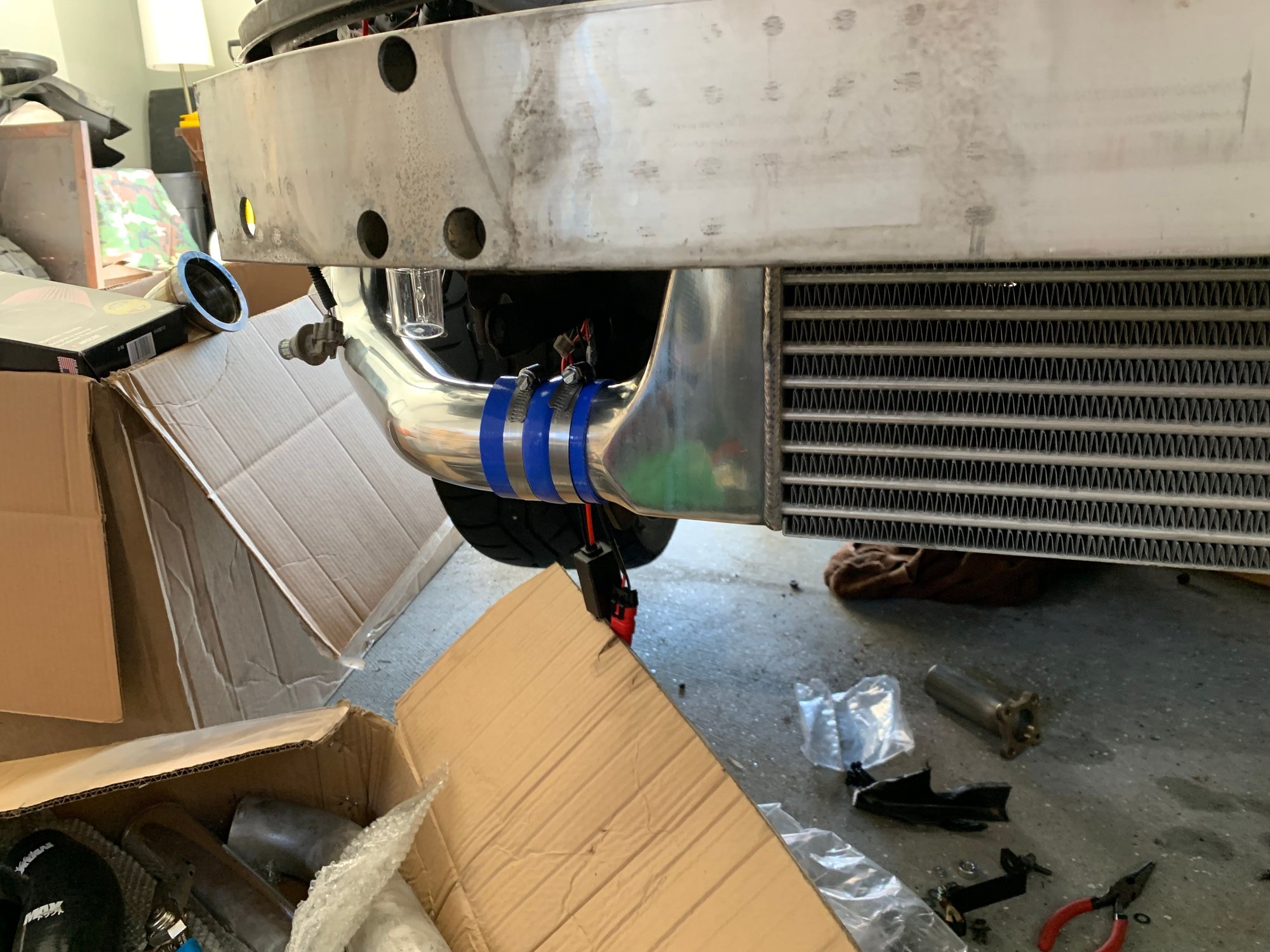

Finally got the Greddy FMIC kit installed. Just missing the final pipe to the single turbo exit which will get fabbed up once the turbo is in it’s final resting place. I love how hidden it’s going to be. Keeps it looking as stock as possible.
Hopefully getting more work done on Sunday!

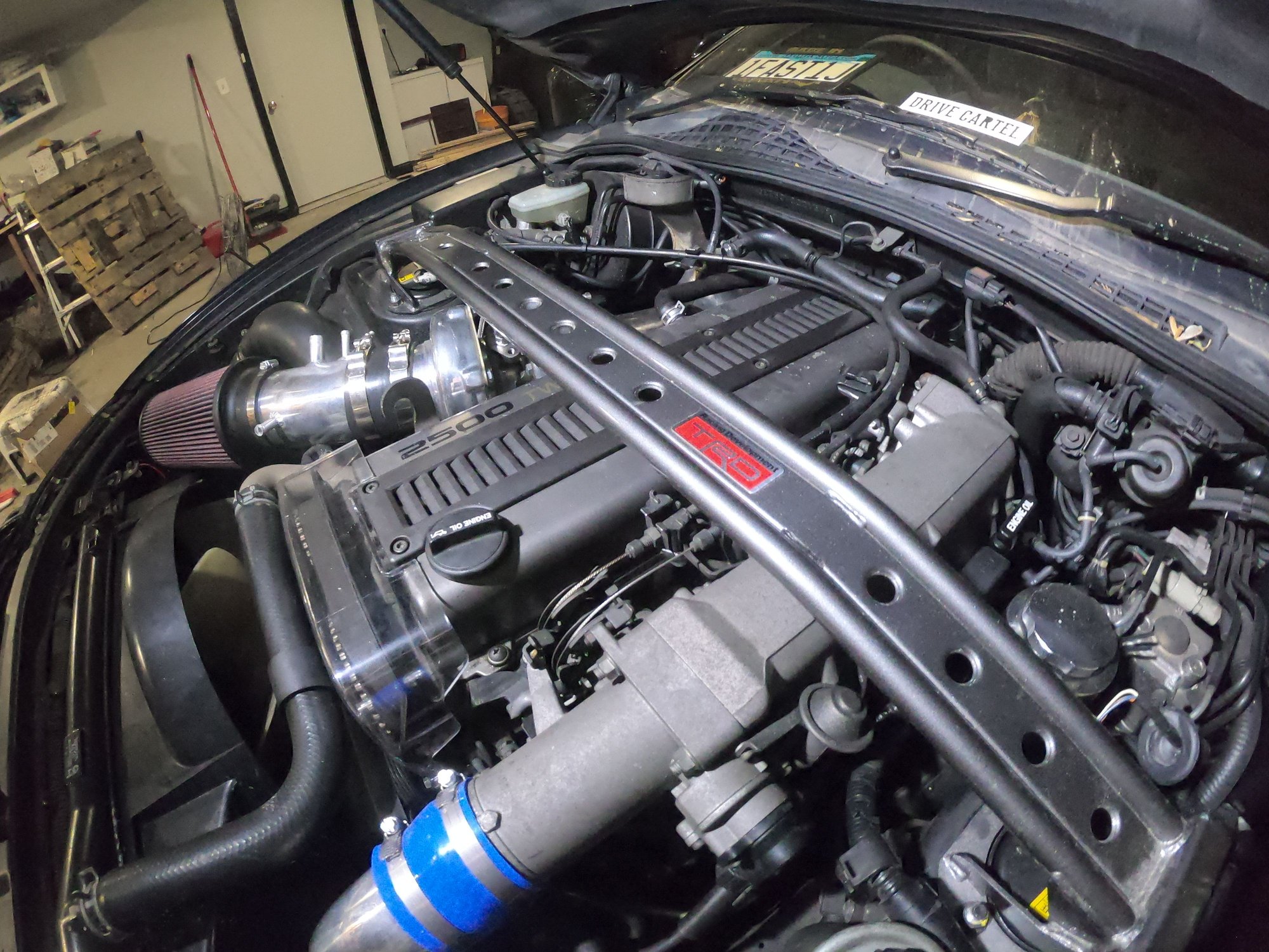

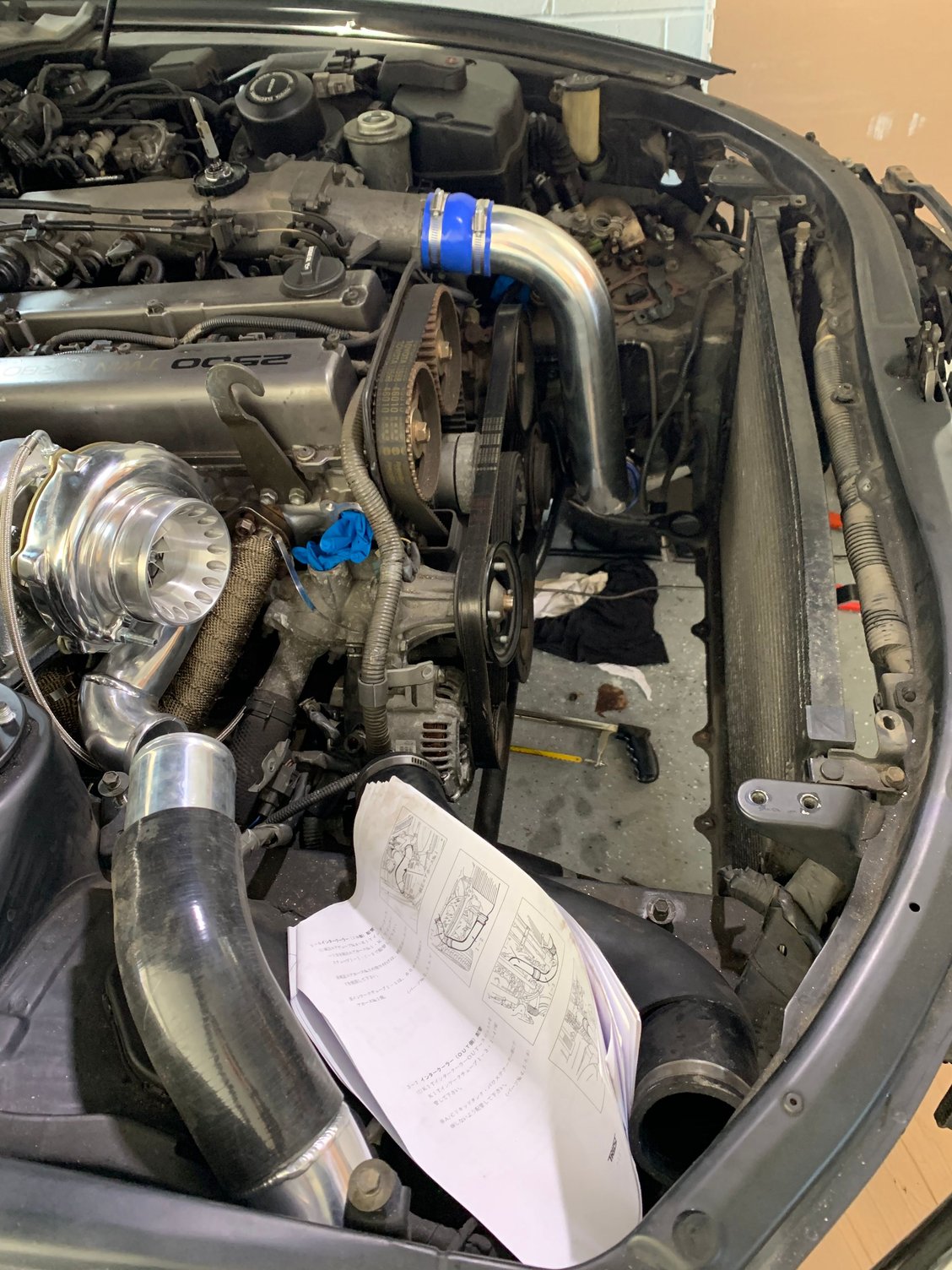

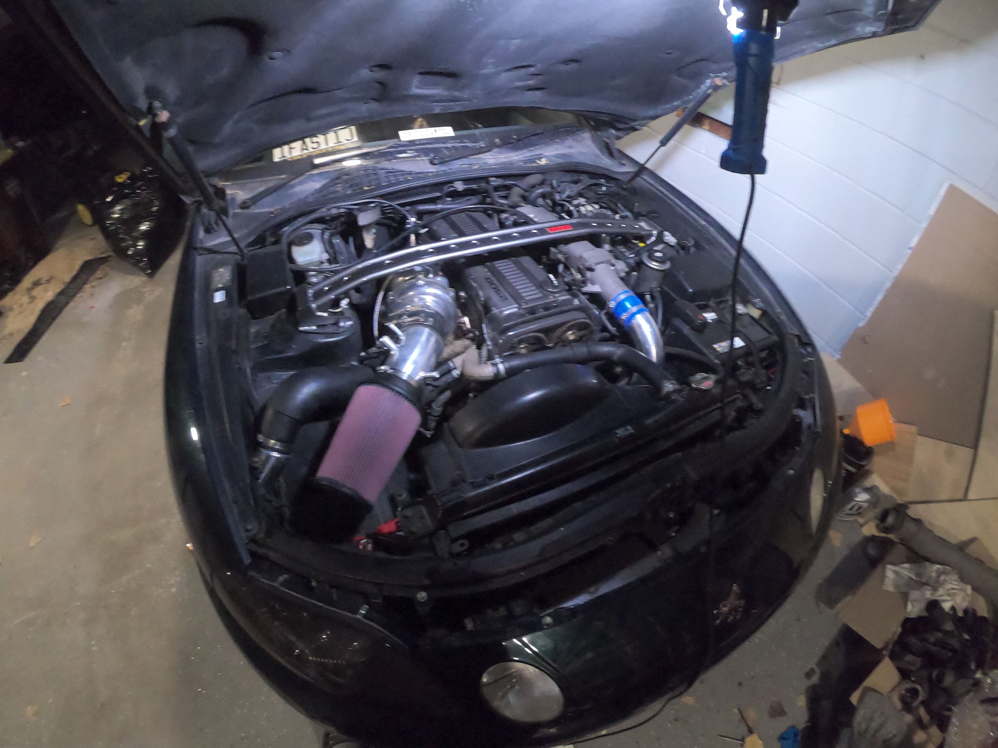

Love the engine bay with the TRD strut bar.
Got my tinted tails on!
Now that it’s running and driving I am taking it to get the rest of the front lights tinted to match the headlights.
A LOT has been going on and I haven’t been updating this. First some progress pics!

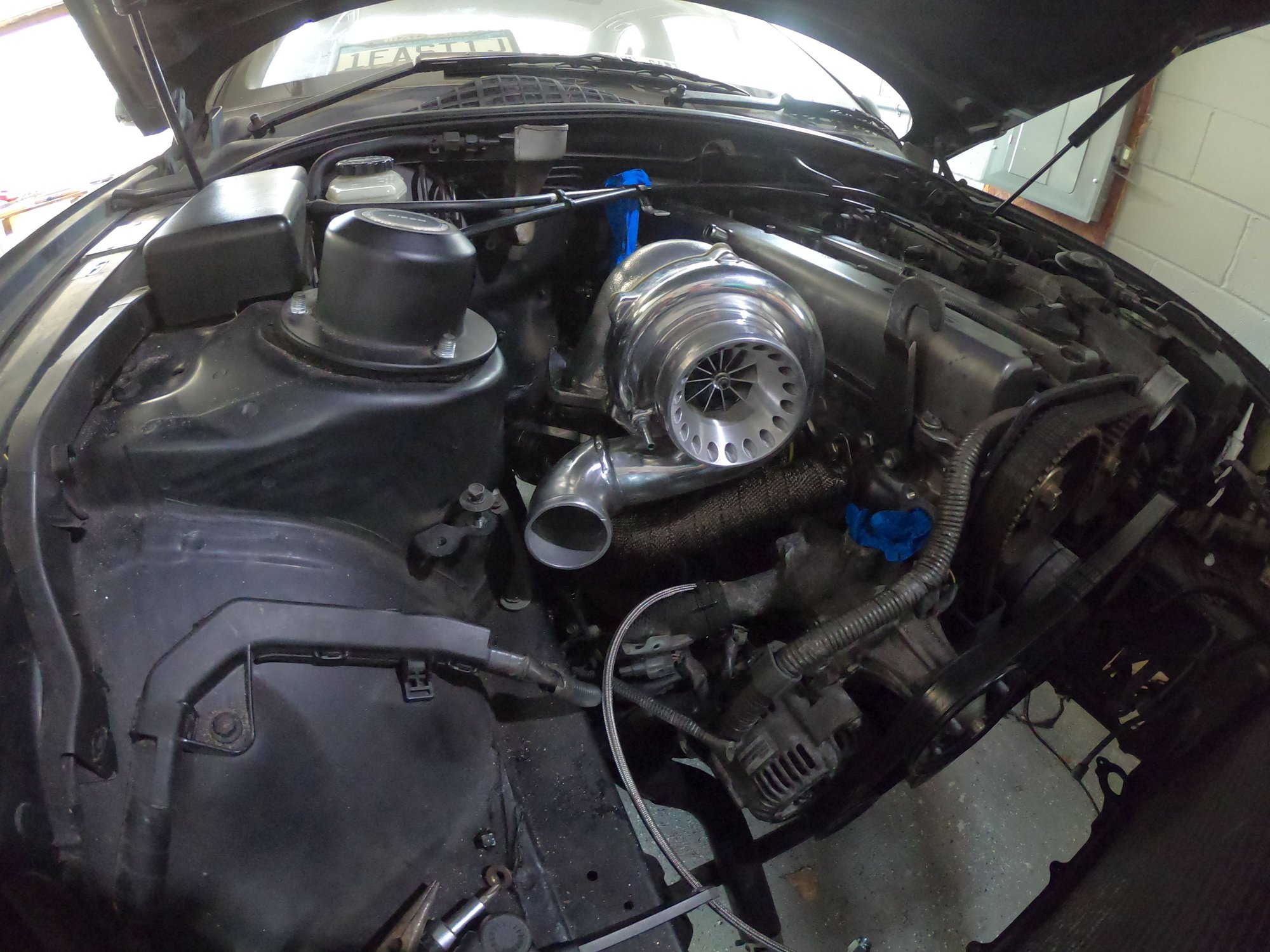

Okay I've gotten her up and running for a bit! I'm on stock ECU, injectors, and clutch. I run 14.5-15 AFR's when cruising and get down to 10 or so under boost (11 PSI). It sounded amazing with the downpipe only for exhuast once it hit about 3k but the idle was a little choppy. I got my exhaust done monday and finished my lights getting tinted tuesday. I ran 3" all the way back with no cats and only a muffler, I'll put a couple short youtube clips on here too. I love the way it sounds with no BOV as well. Just got my radium fuel rail, waiting to pick out injectors and such still.
This is the first startup video after a few months of not running after getting the Driftmotion 6262 kit installed.
This is downpipe only (3")
This is with my full exhuast and muffler installed.

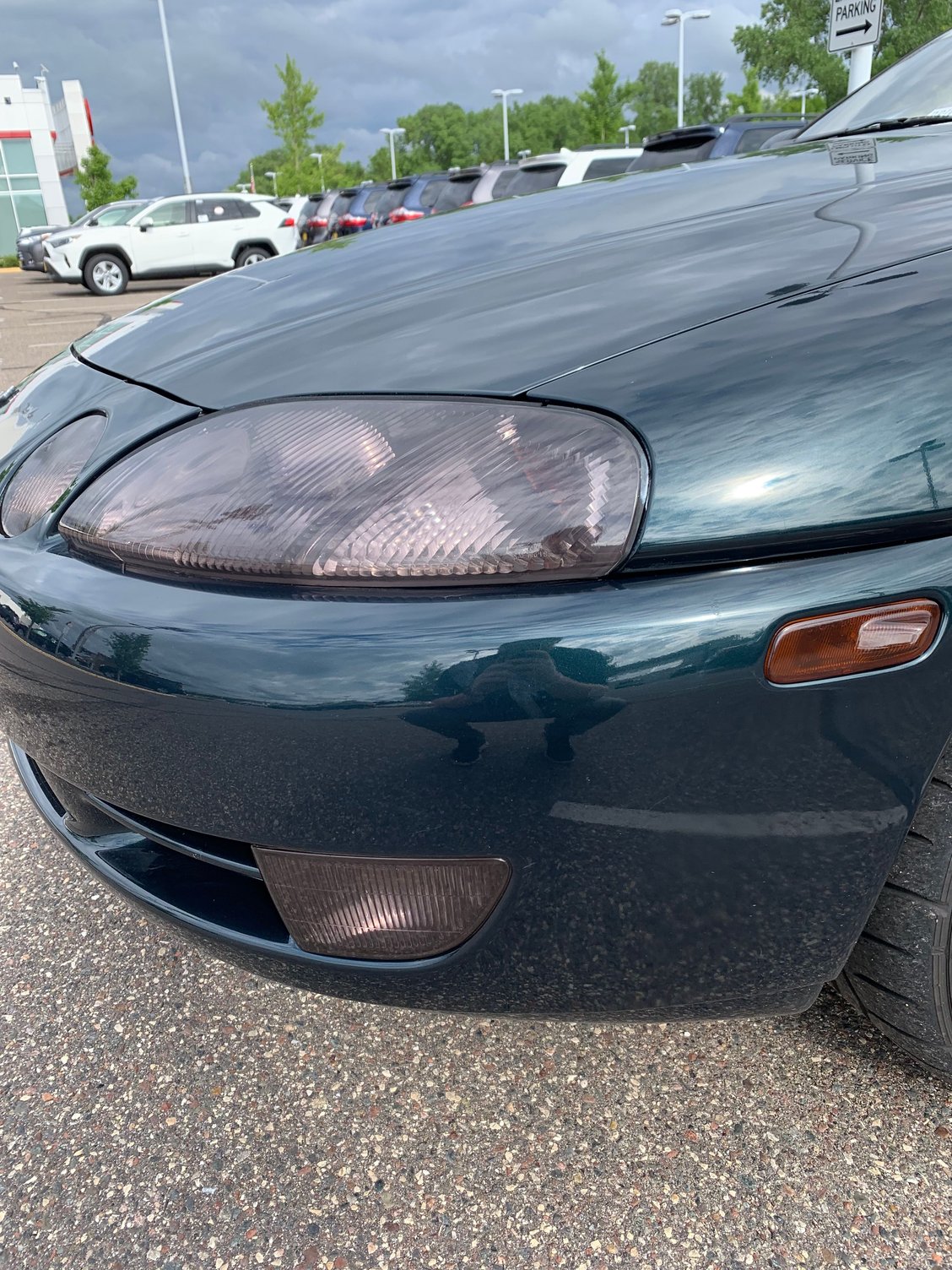

Here are a couple pics of the tinted headlights!
I love how aggressive the front end looks now.
The side markers were tough but my guy nailed it!

Awww yeyeah glad to see this coming together! Usually not a huge fan of the tinted lights, but that hue on your color looks killer. Keep it up!
Thanks! Yeah I agree with you there, I just had this vision on the tinted lights haha! I thought it was worth it to give it a shot but it doesn't look right with every color. Now I just need to find a way to match the powdercoat color on my wheels for the plastic center caps and I'll be about done with the outside.
