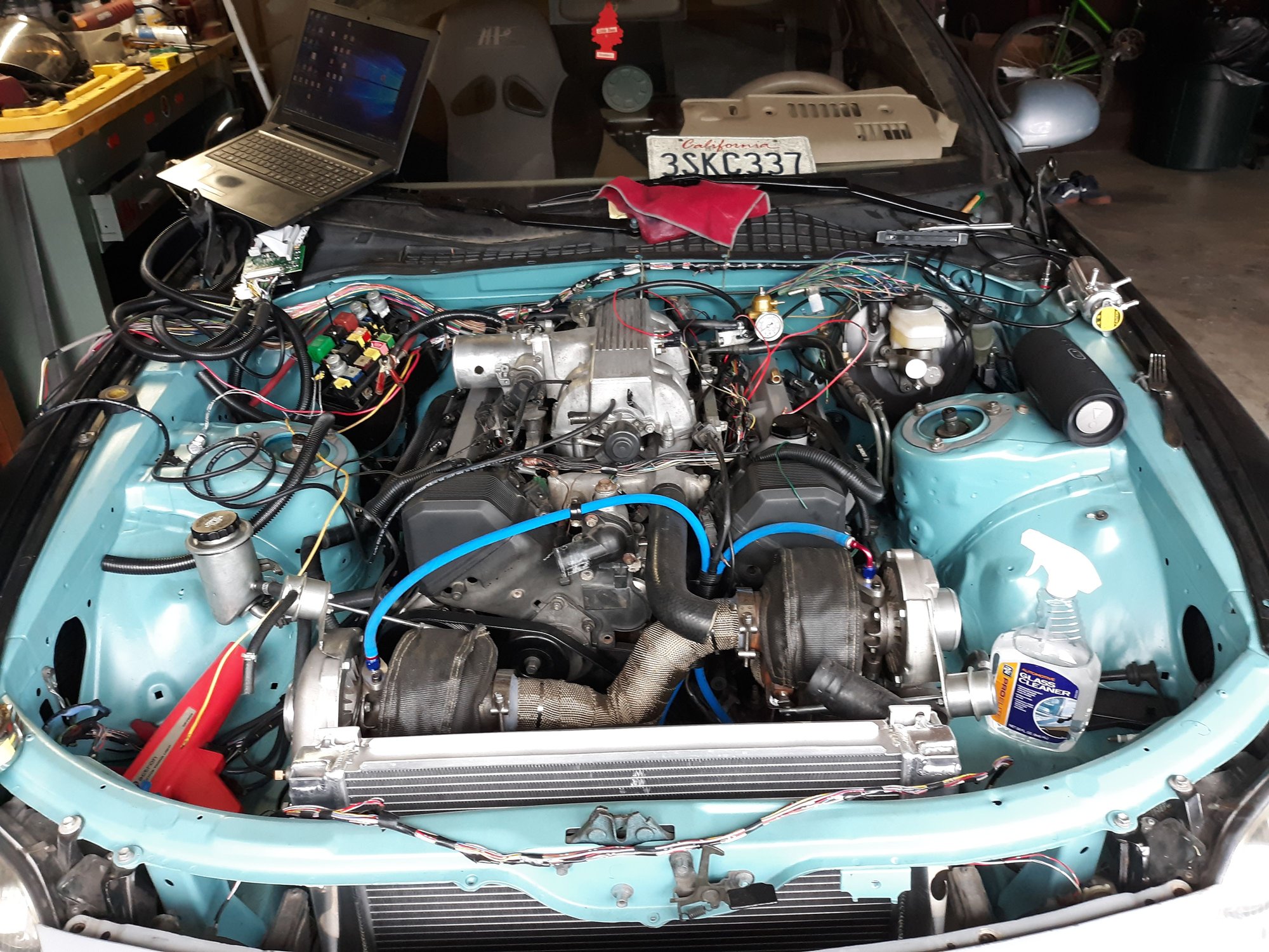

Got the New calipers and rotors installed.
Got the radiator partially mocked up, still needs top mounts and a crossbar.

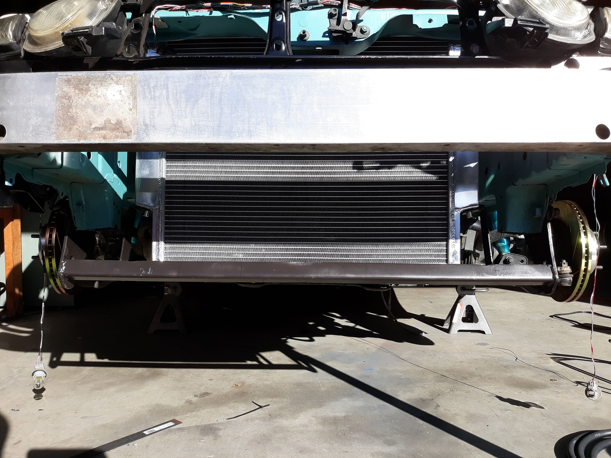

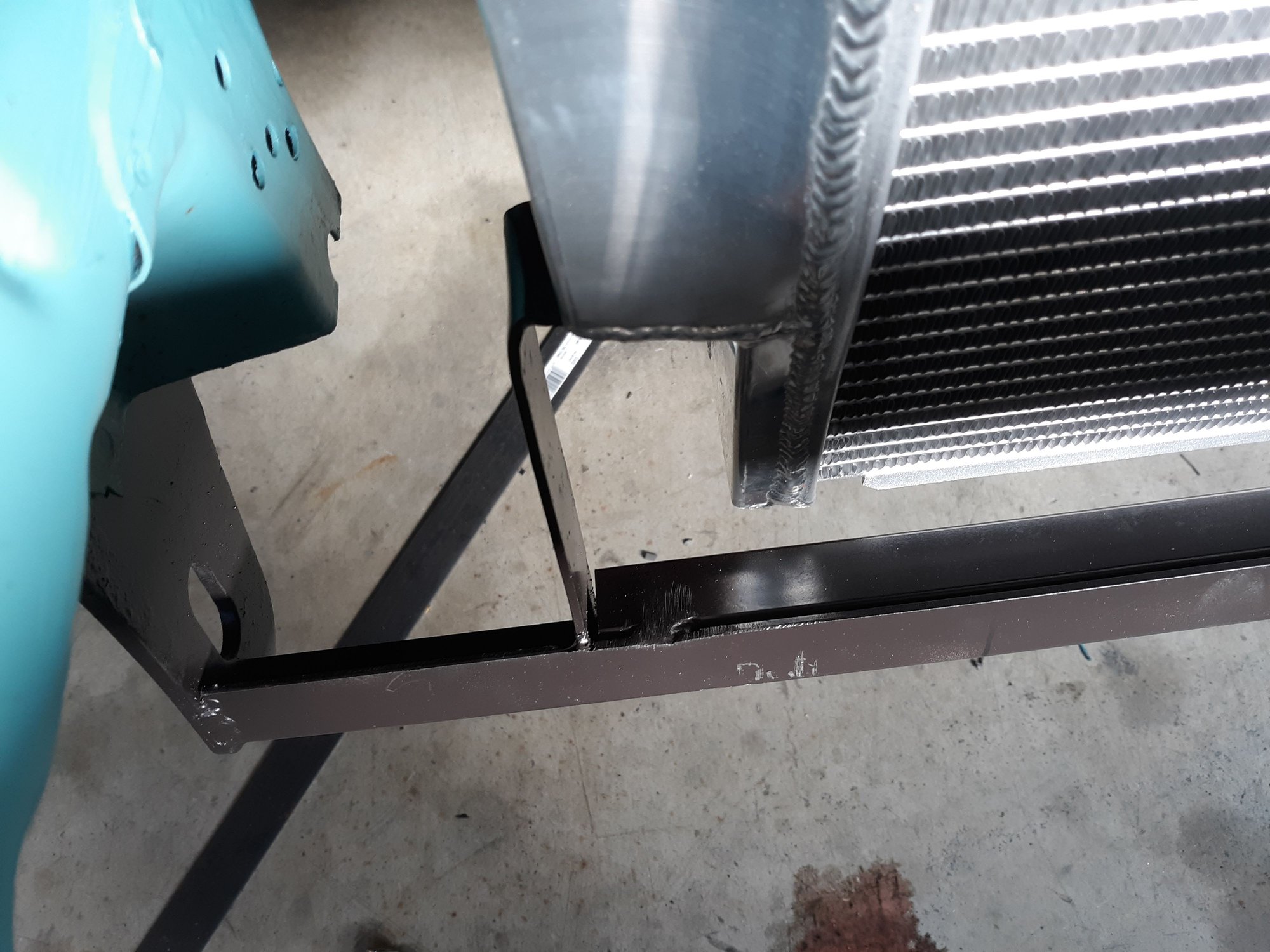

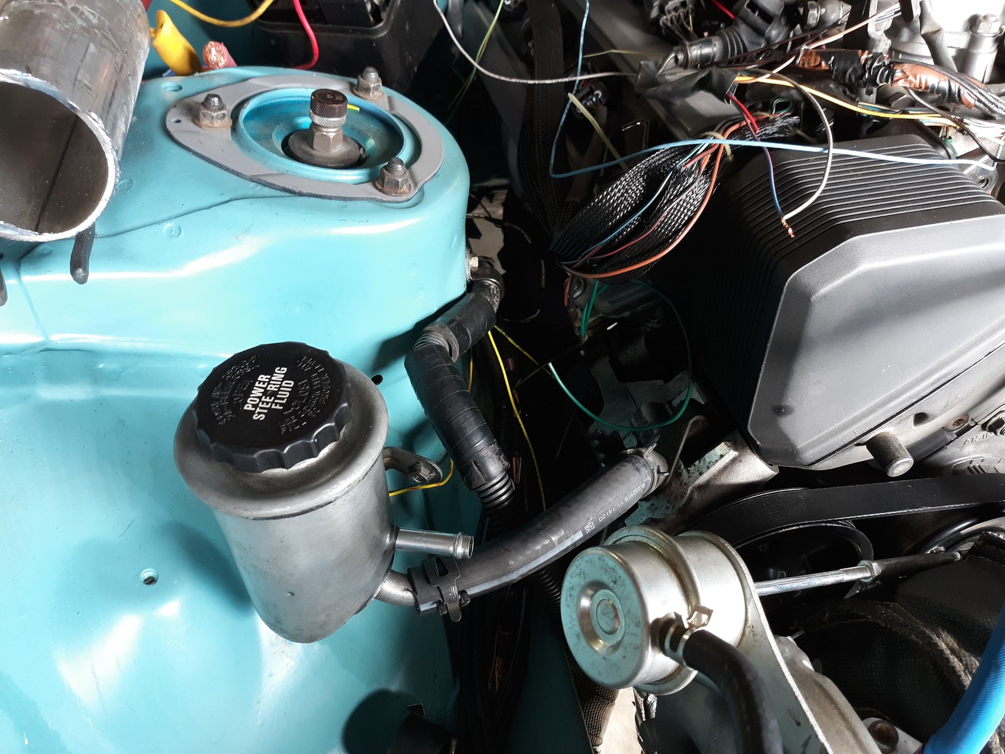

Remade the radiator mounts more conventionally then before. The crossbar is crude but is only there to act as a support for the radiator/ intercooler and to provide protection for the radiator. Also began getting the powersteering system hooked up.
All the ms3 wiring is hooked up enough to do a test start for verification before its all heat shrunk and cut to length. But cant do a test run because my computer wont talk to the tuning cable and couldn't figure out the drivers(for the usb to usb cable). I've bought a serial to USB cable that comes with a driver install disc so I can attempt a start when that shows up.
In the mean time I will get the clutch pedal set up, make tabs/mount the intercooler, and get the fuel pump going
this gave me an idea for mine, my radiator support is completely crunched and the radiator is shifted back and up so instead of trying to straighten it i'm gonna cut it out and weld a new piece in like you did.
Excited to see what it looks like when your done! Main benefit I see is that you can unbolt it when you want to pull the drivetrain and subframe as a whole with just jackstands(instead of a lift). Also clearly it's a piece of angle iron but there is also square tube tacked into the center otherwise it will bend too easily, so maybe a rectangular or square tube across would be best to start with?

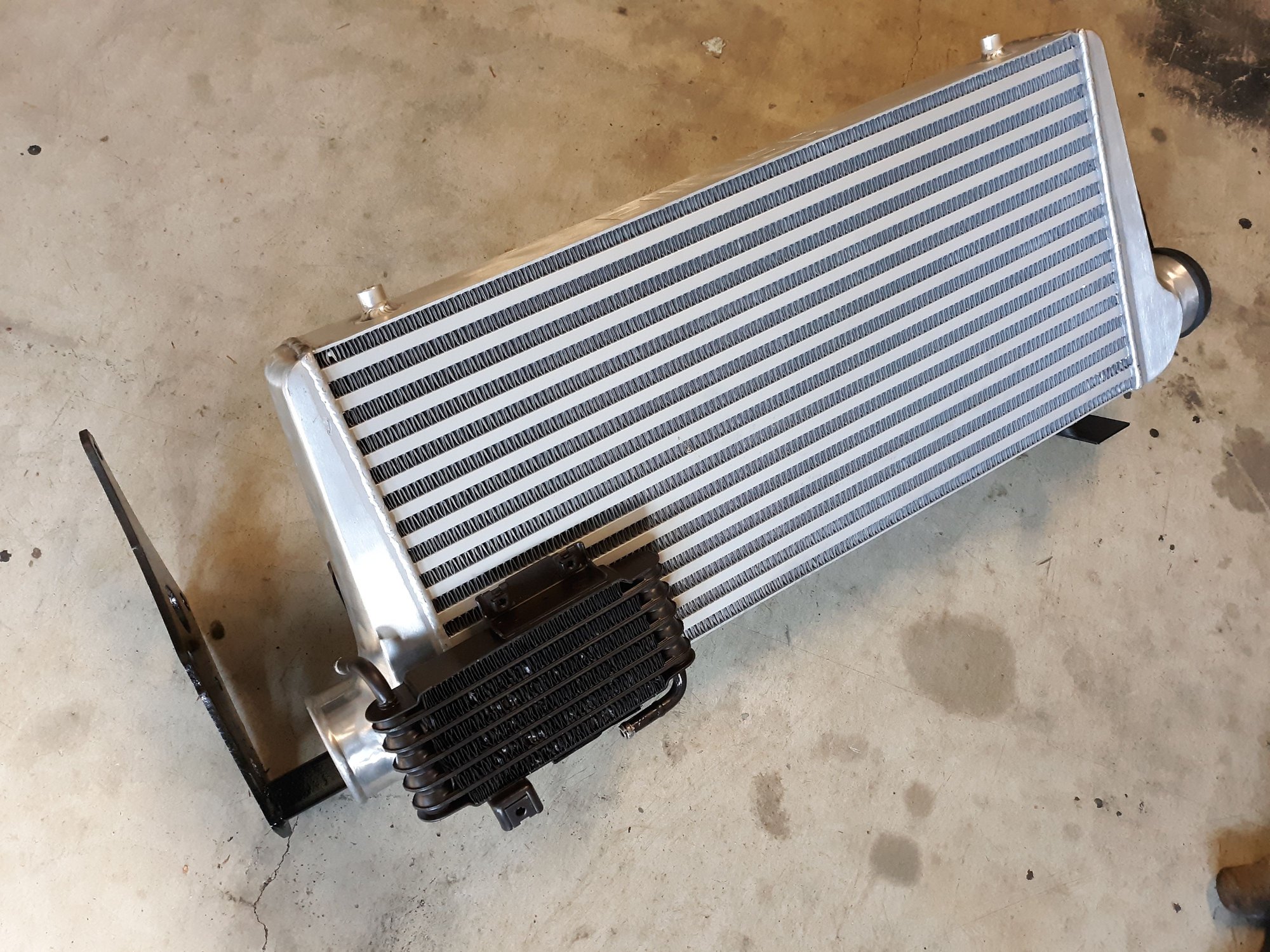

Made intercooler and powersteering cooler mounts.

Finished the clutch setup, used a Collins 3an Clutch line to a Vibrant 3an banjo that ended up being too small and getting drilled out to fit.
Properly made all the sensor connections (beside cam/crank), tidied up the loom deciding how everything is routed, dealt with the clutch, filled the transmission, ran Powersteering lines, and made all the heater hoses.
After some critical help with megasquirt settings from a fellow CL member and fiddling It started! Idled pretty good, revved decent, and has relit the motivation to finish this project. Just powerbought all the chargepipe and exhaust tube/mufflers.

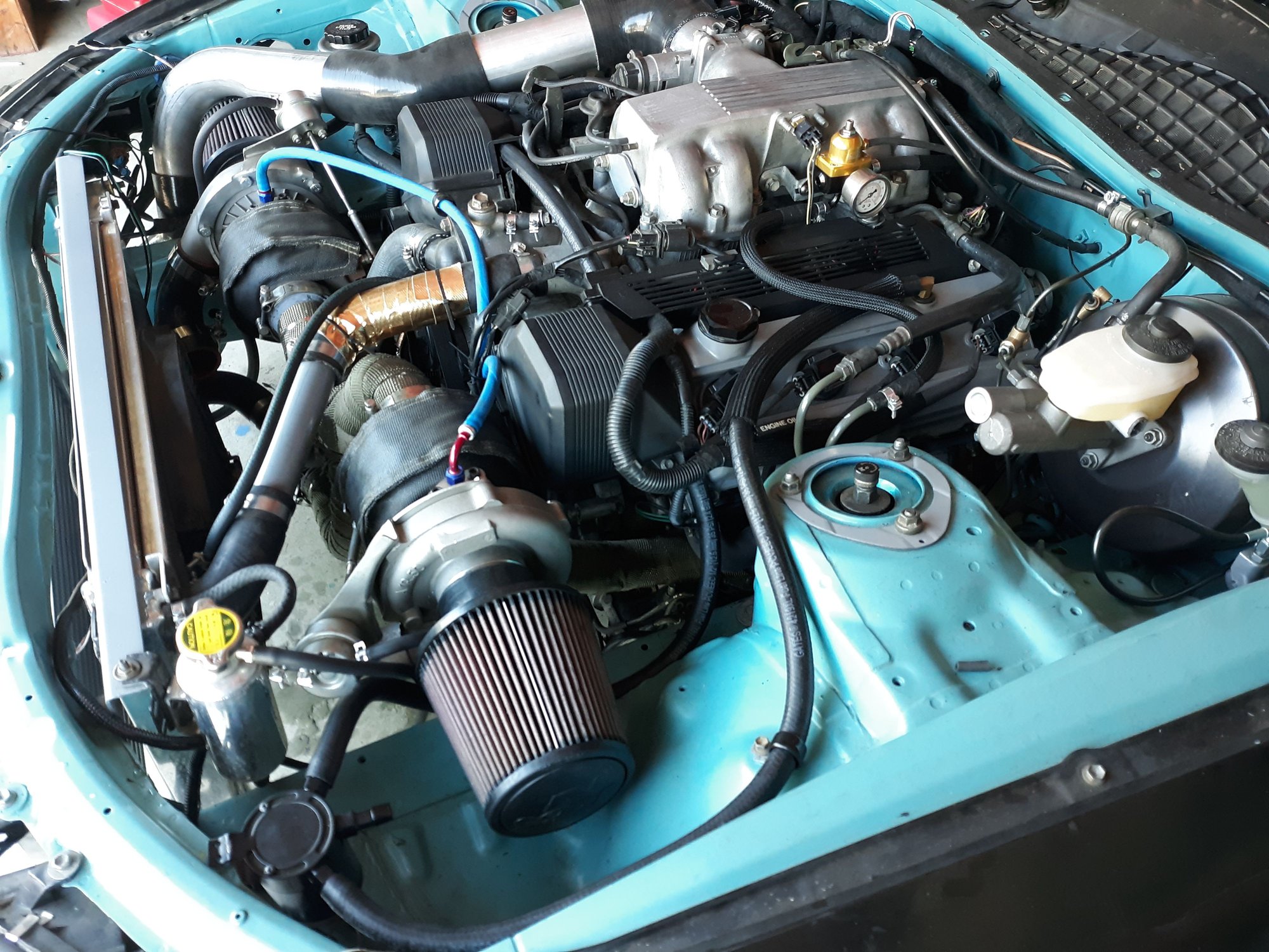

Routed all the radiator lines and made an upper mount for it.
Got the car running on wasted COP with 0°s and sequential injection then after attempting to set the timing I realized I was 360°s off. Timings still needs to be fine tuned before I can continue but the car now runs with sequential injection and timing. Currently only the afr gauge is wired in but soon the boost and knock gauge along with the fan will be too.

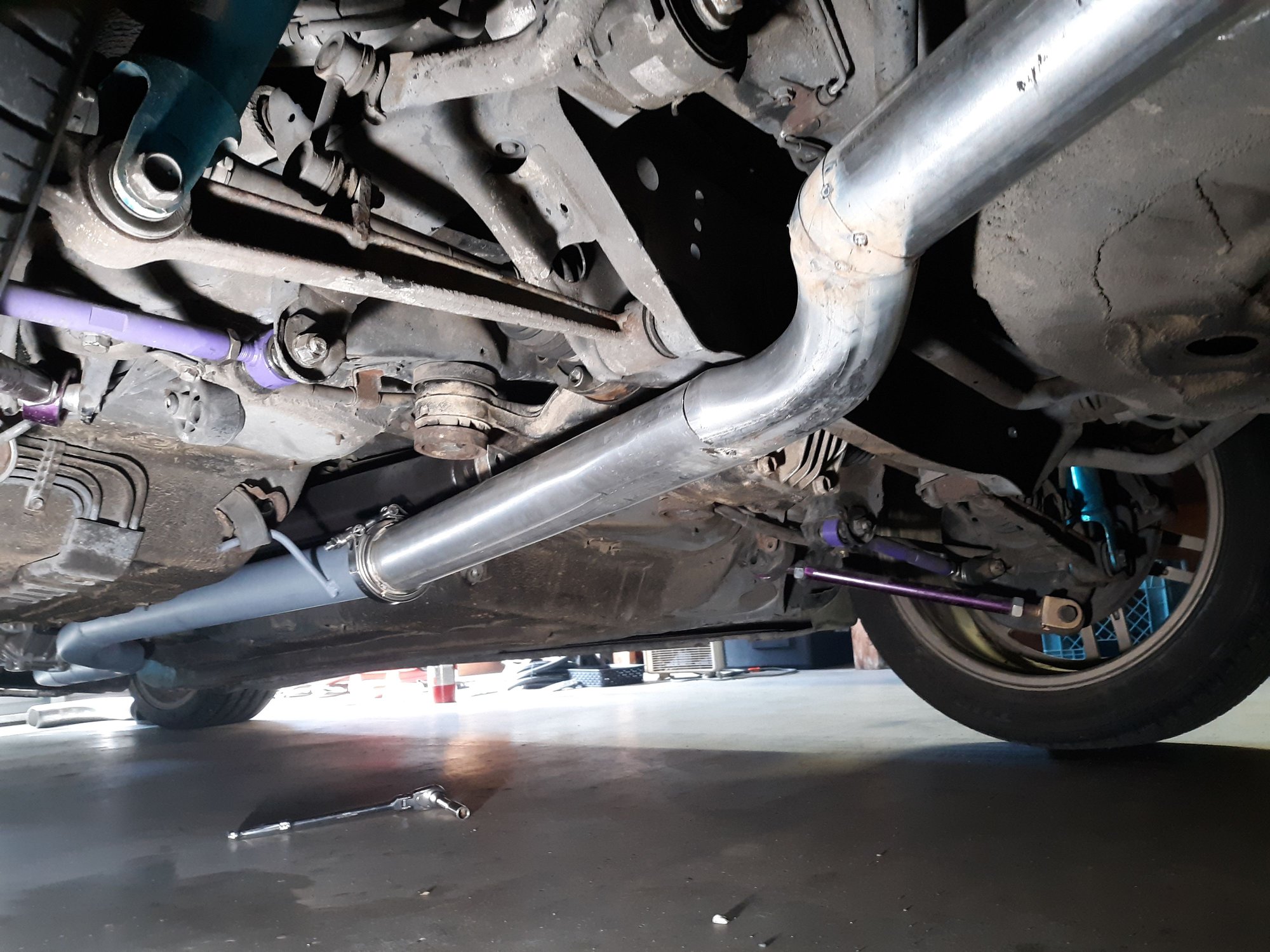

The exhaust was finished using scraps from the local muffler shop and some straight lengths from Summit. 3" was too thick to fit without ride height issues so most if the exhaust has been ovaled to about 2.25".

Scheduled dyno tuning next week, for now its keeping it out of boost while test driving to iron out kinks. Here are a few things:
Evidently the sump is leaking oil pretty heavily, I must have used the wrong gasket maker or torqued it down wrong. So I'll need to pull the motor at some point.
The turbos are also burning lots of oil which is no surprise considering their previous life.

Have you tried a restrictor on the turbo oil feed? It solved the oil burning issue I was having.
