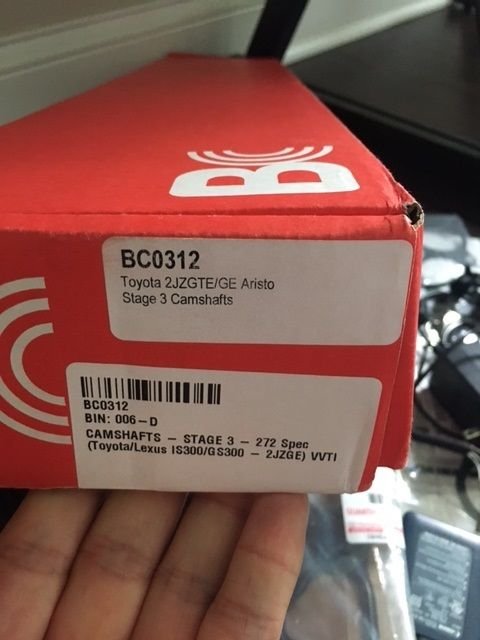

Exchanged the BC 272 GE non-VVTi cams for the 272 GTE VVTi cams. Everything else for the build should be the same between the two motors.
Waiting on the GTE motor...more updates soon.
