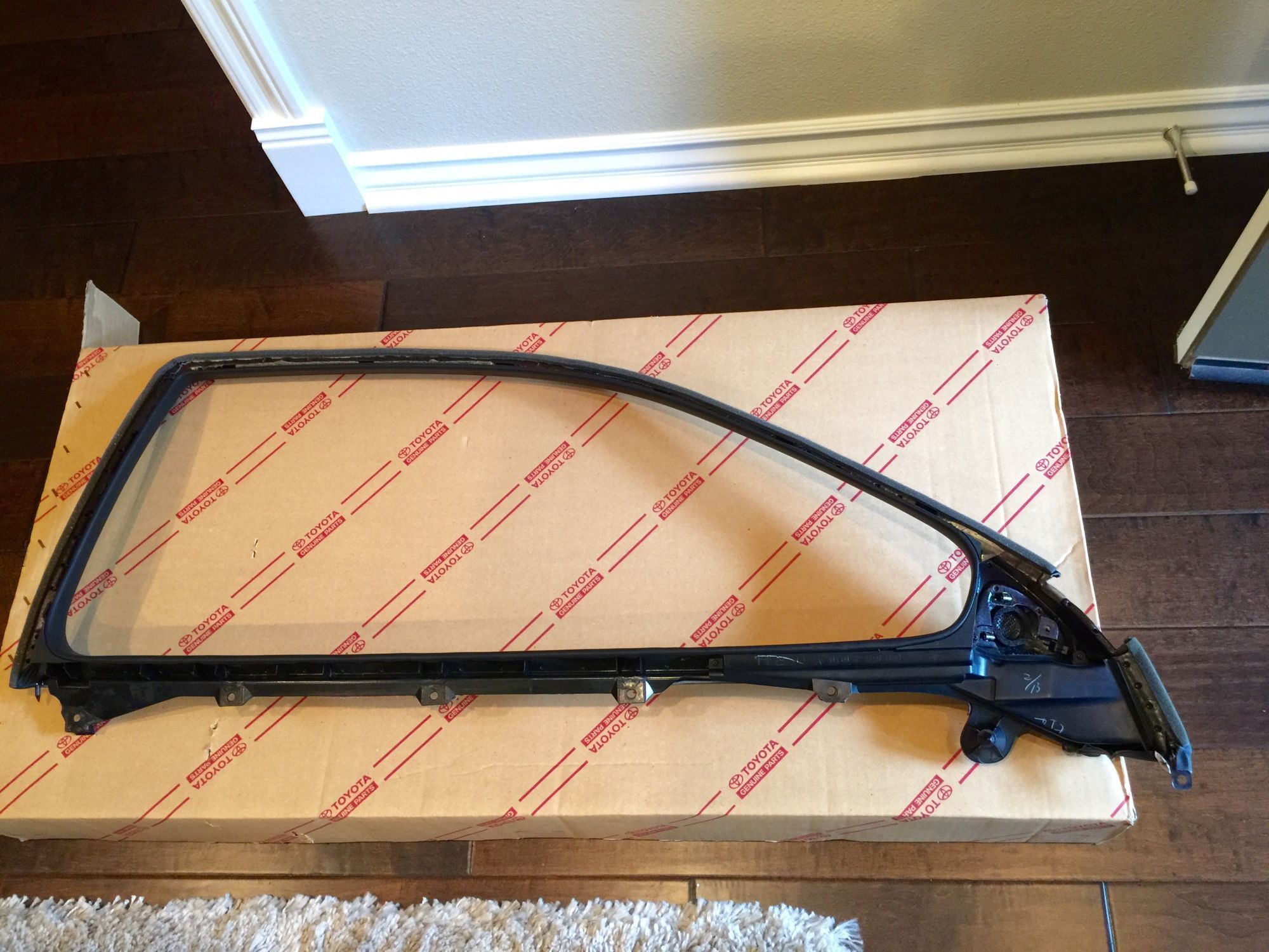

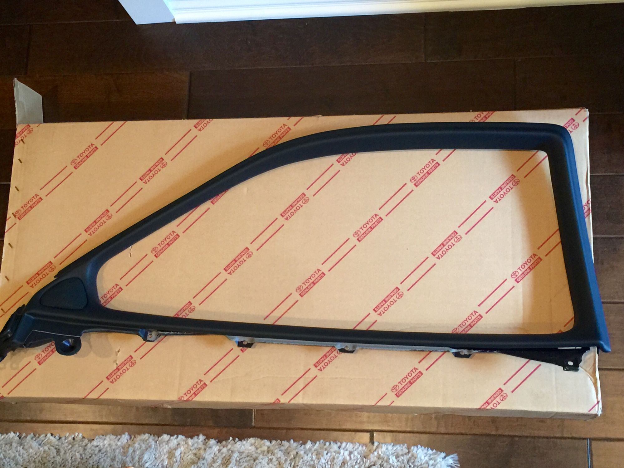

You need to remove the door panel first. There are also some screws that hold the trims in place at the bottom.
Here's a pic of my new ones I replaced not too long ago. Take a look along the bottom of the trim.
