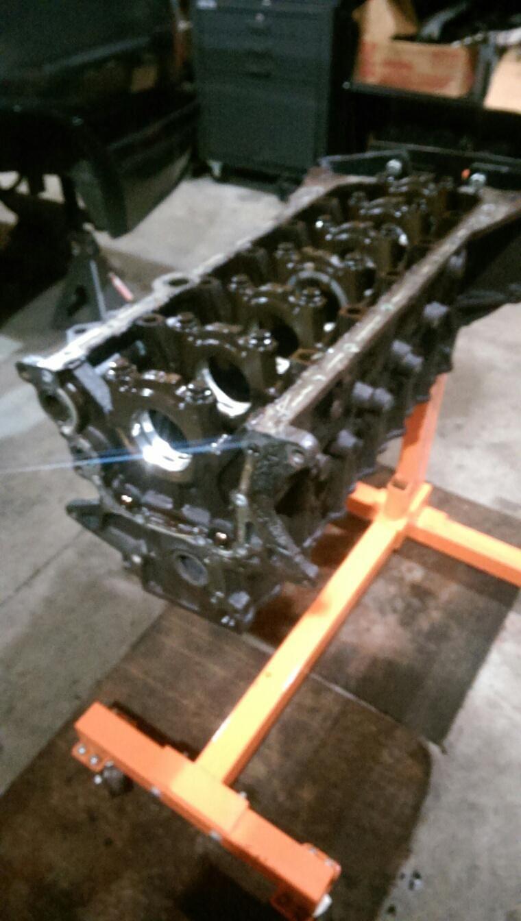

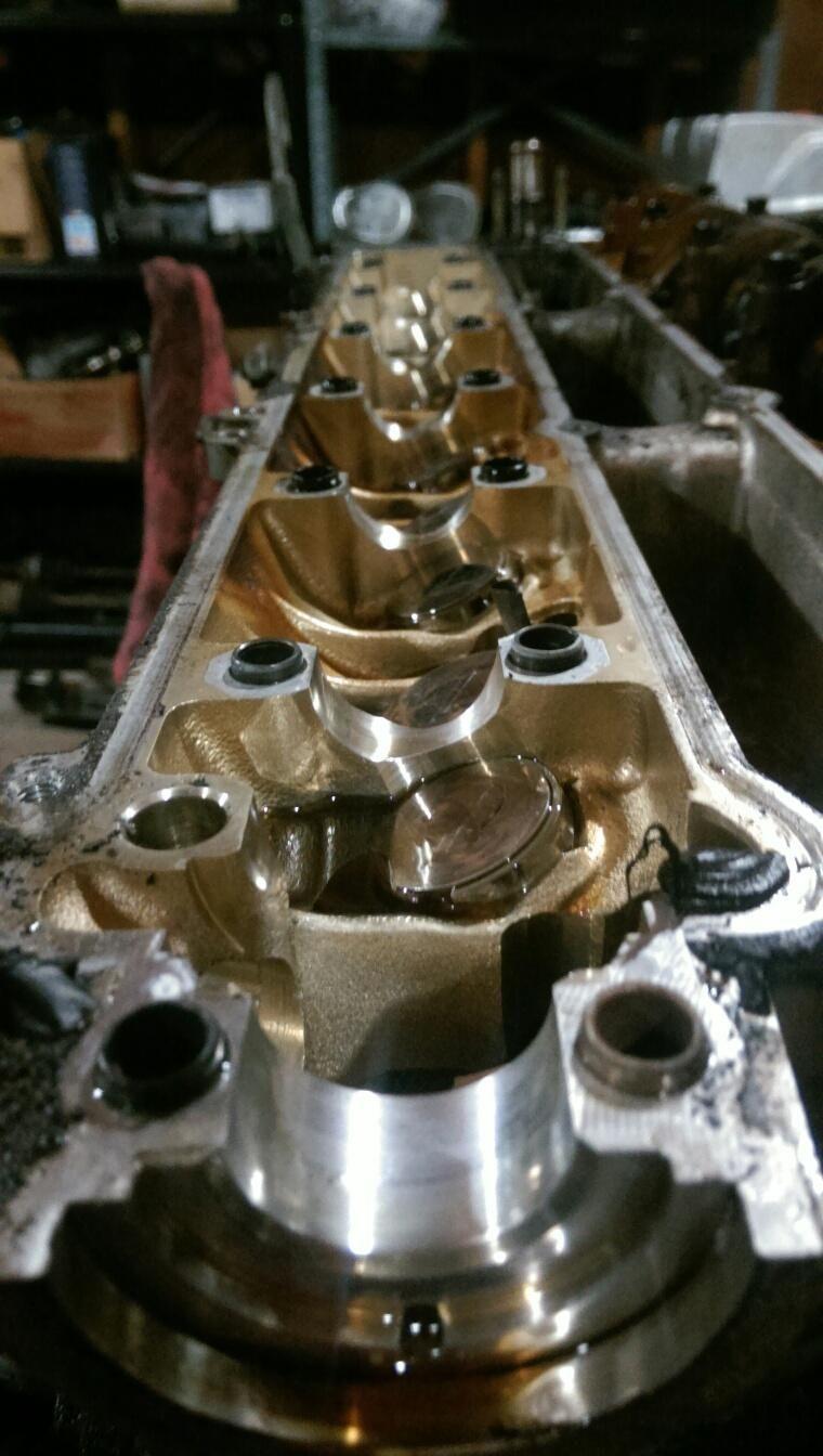

The block has been fully disassembled and is ready to go to the machine shop in the morning
A better shot on the condition of the main bearings. These things look beautiful as well do my cylinder walls
The crankshaft looks mint....Although I did find some scoring on the connecting rod bearing for cylinder number one...Nothing serious
