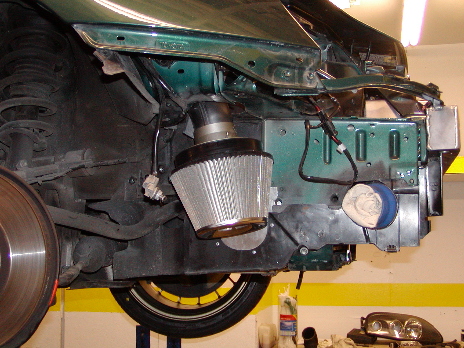

You could also just cut a hole in the passenger side fender and run a pipe down in there and stick the cone in the passenger bumper side.
Sort of like this picture except I would tuck the cone up much higher.
That's basically what I did by modifying the snorkel to scoop air up from that location, but with less likelihood of the filter getting soaked.

Here you go...
It's real easy to use a cone filter and isolate it from the bulk of the engine bay heat that way. You can still pull air in via the same source(s) as the BFI or stock snorkel. Whether it's any better than the fairly large surface area of the stock filter is debatable, but it looks cooler and generally sounds better.
