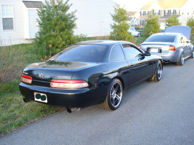

With those offsets you do not need fender mods. And you will look something like this..
These are 18x8.5 +35 , 18x9.5 + 35, Any lower offset under 30~ you are going need fender mods (rolling fenders is really not that bad or hard), or to start stretching.
