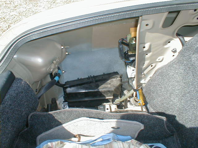

Lightbulb If it's the sunroof drain hose, it should be easy enough to keep that hose clear....
Here's a pic of that area. This is the driver's side. The amp is on the passenger side, but the drain hose and the black "ventilation" box it passes through look the same on both sides. You can see the clear drain hose entering the lower right corner of the black box. Accessing that area just involves removing a few black plastic nuts and popping off the trim panel. It's hard to imagine that hose getting clogged with debris from above, so maybe the tire is kicking up mud from below (in which case you can fabricate a "shield" to protect it in the future).

Actually what has happened on BOTH cars is the hose is coming unclamped at the lower/bottom end somehow and just drains into the area where the amp is mounted. My friend rigged up some kind of a beefier clamp to secure the hose in place....seems really odd that this would keep happening on the two different SC's he's owned in the past four years...

Try to use a small heater hose clamp to secure it better. All auto parts stores sell them.
