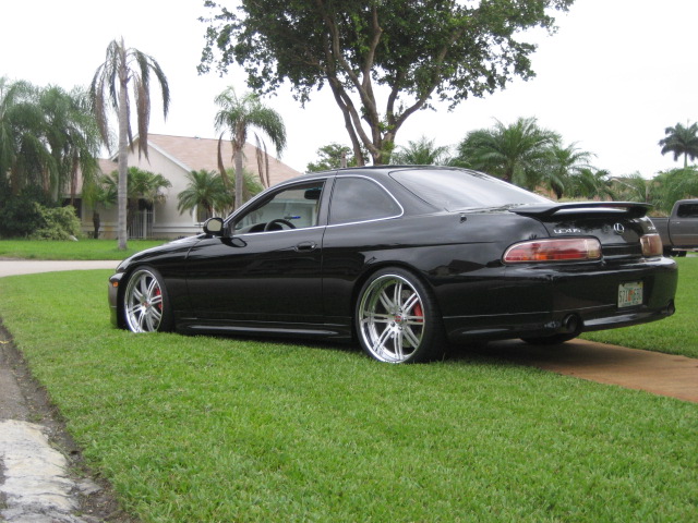

as mr wicked has stated its all about proper offsets
20x9 front with 20x11 rear on 305/25/20

Originally Posted by UR2klose
that looks PERFECT!
do your wheels scrap at all in the back? i have 20x10 and mine rub a little even with the fenders rolled
Thanks! No, no scraping/rubbing at all.. Again it's all about the proper offsets..

Originally Posted by Wicked SC
As a matter of fact my boy's SC //LRD, in the pic below had 20 X 11.5 in the rear!
Thanks for the mention Rome here's another
20x12's

Originally Posted by k93
well wicked what is the offset for your 20x 11?? and 20x 9 ,,, also what size/type tire you running??? and by the way you set the standard!!!
Thanks for the compliment!
The front are 40 and the rear are 42...
The tires are 305/25/20 and 245/30/20
Wow! You fit 305's pm the rear? Does it rub and did you have to do anything besides shaving the fenders to get them to fit?
Old Oct 2, 2010 | 10:01 AM
Wicked SC's Avatar
Wicked SC
Joined: Jun 2008
Posts: 3,208
Yes, the inner lip on the rear quarter was shaved for fitment.
