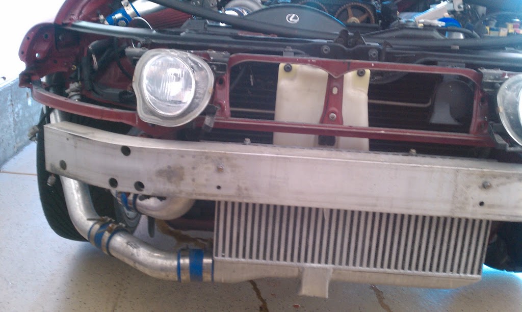

bumping this old thread mecheng10 was asking me if I had more pics of the same side piping.
I then remembered I took some pics when I had my bumper off doing my first FFIM like a 1-2 years ago. this is the old setup same side I used to run.
The top pipe curls down to get under the frame as you can see, then it curls around in the fender and under the frame again where it pops right into the engine bay.
From there it goes up and to a 90 on the turbo (not shown).
Most people run their charge pipe this way cause then the pipe does not sit below the cross member, so you wont hit it if you bottom out.
If your intercooler piping is hanging lower than the crossmember, then something has gone wrong.
more of an overview of the whole piping.
The bottom pipe goes through the OEM hole on side of engine bay as you can see.
To fit the washer bottle I just bend the tabs back a little towards the radiator.
I never remove it I like the factory one in the factory spot so it stays there.
