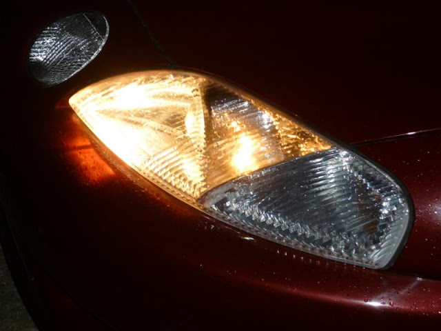

Today, i changed the oem bulbs to Narva white Power lamps. For the low beam, i made the HB3 Mode to have 60Watt low beam
OEM low beam
OEM high beam
OEM headlight
Pictures with the installed Narva lights and HB3 mod for the low-beam
Narva low beam
Narva high beam
Frontlight
greets
Boergsn
