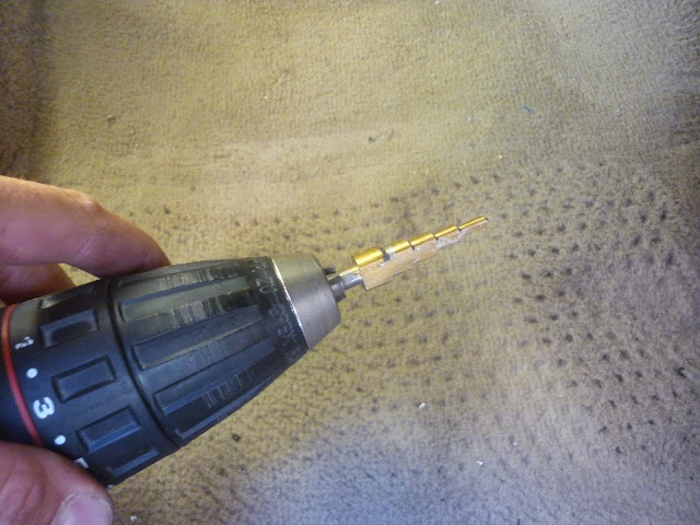

drill the holes, start!
bigger holes

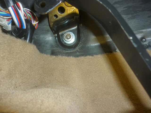

only the steering wheel ecu needs a new place under the dashboard. the original bracket have no space more with the clutch assembly.
screw lower position
screw upper position (under the dashboard)

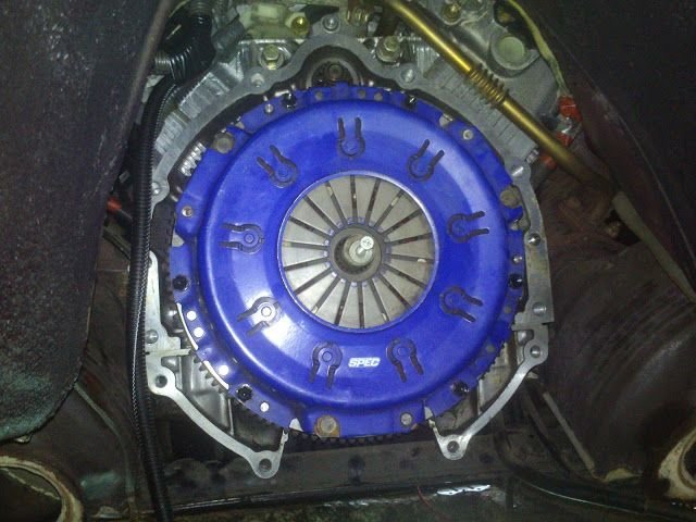

Flywheel from Bolt Perfomance installed, 9kg steel, no Spacer from the flexplate!!
pilot bearing installed, around 15mm put in the crankshaft (1cm on backward from the bearing, 8mm bearing itself)
centering pin and Spec Stage 3 Clutch

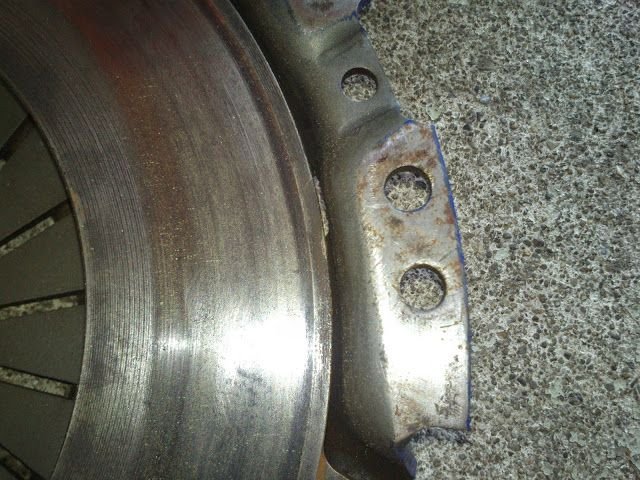

here was the first failure from my car, the pressure plate was over 1 year in my garage, like new, but little bit rusty on the bolts for the centering plates, ands my car shakes after starting, tranny removed, failure found, rusty bolts, pressure plate not centerd
FAIL:
one side
opposite
i used rust dissolver and a rubber hammer to fix the problem

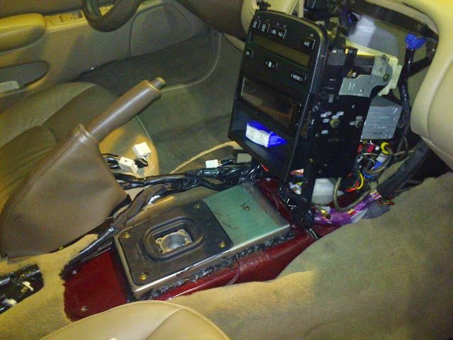

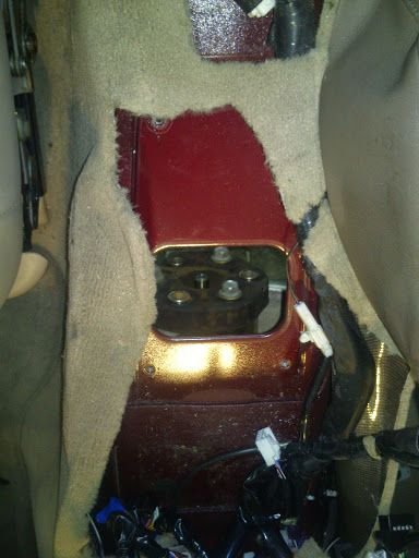

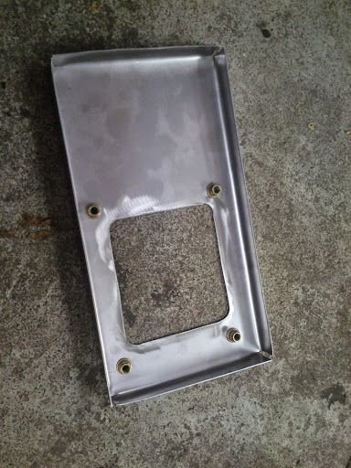

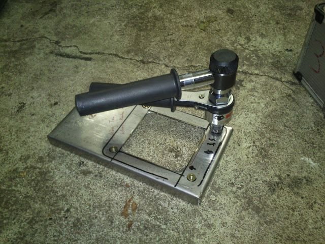

hello tripod! but the tripod had contact with the tunnel... ok.. cut the metal and make a own tunnel cover, the original metal is not more available
MY Friend Robert makes me this stainless steel plate
a look from the bottom

tunnel is ready to use

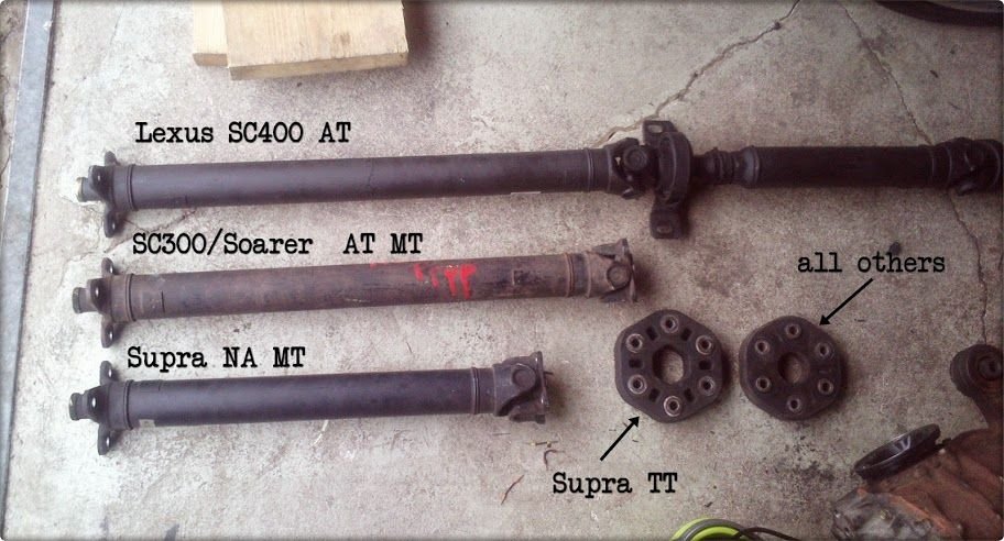

next step, modify the drive shaft, my first idea was, to use the oem SC400 and weld on the front part from the MT, is possible, but not good, the front part from the SC400 is sliding, not good, driveable, but not good. i orderd a used front part from a supra and from UKa soarer rear part.
clutch line bleeding, its not difficult, with a good vacuum pump is this in 5 minutes done
driveshaft installed for first testdrive
its ok for a test, but i changed to the right combination of drivehsafts.

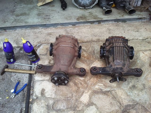

Supra TT Diff (3.77) with TRD 2-Way LSD ready for install
Diff is installed, next step, shortshifter from NST modification with the oem shifter to have the shifter in the center of the console, around 2cm higher for the best position to shift.

Supra driveshaft arrived, but rear part to short

okey.. all driveshafts arrived! ready for puzzle
The flange on the TT Diff was the big one for the Supra TT, but i need the small one for the SC/Supra NA) change on the car, and the flange tightened with 140Nm (toyota manual) ok!
installed, but in the winter, i will rebalance the complete shaft, i have minimal low frequency vibration on over 140km/h (you can here it later in my video)
