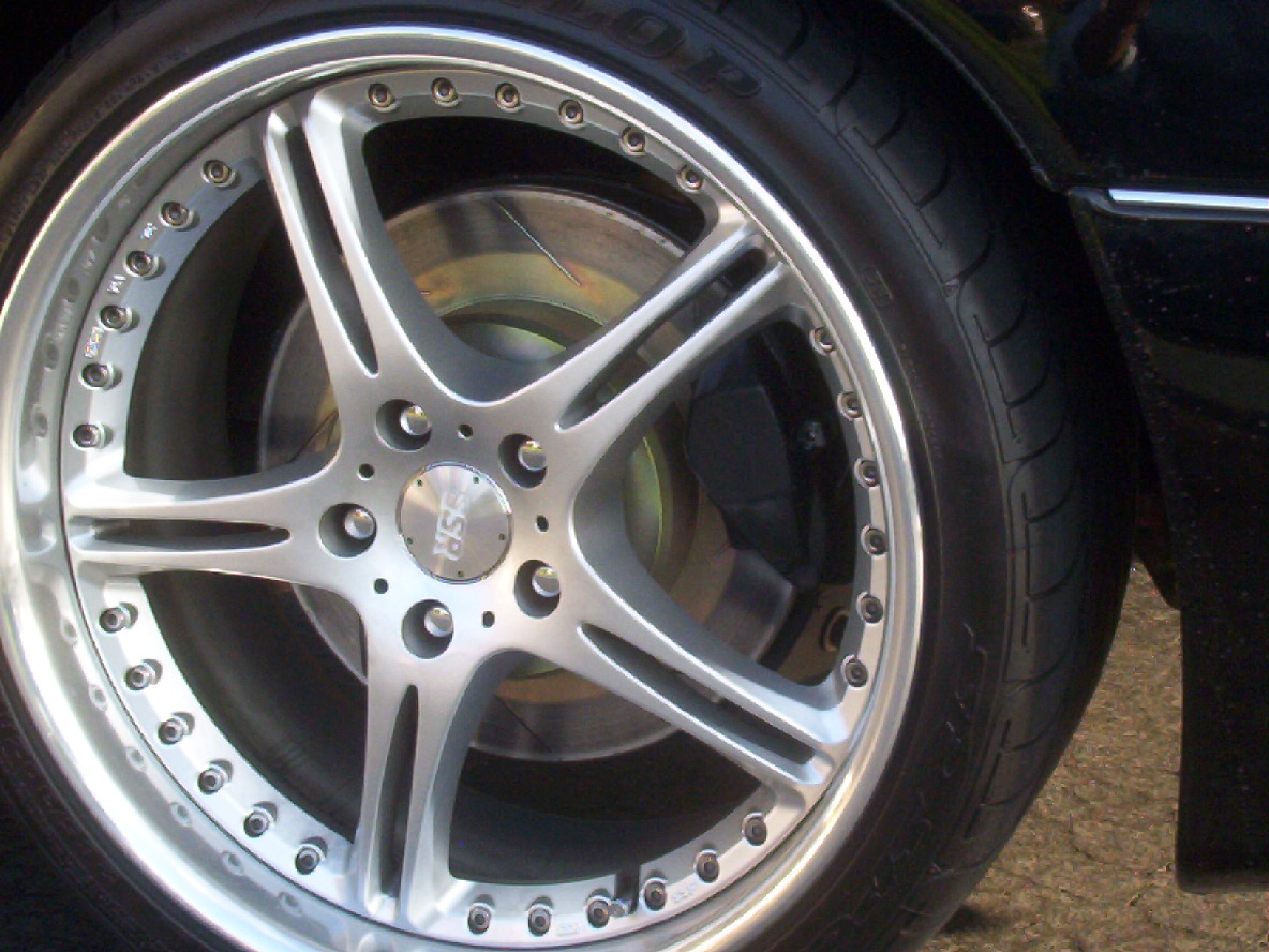

Here are some step by step photos
cardboard and it's many uses
here is how the template looks mounted
just to show you how close the mounting ears are to one another. If it wasn't for the extra 1.80in of rotor mass it wouldn't of work.
is a side by side of the rotors
a before shot
and the TADA shots
I hope this will plant a seed in your heads.If any of you who are thinking about do this mod.It's fairly easy

does those brackets actually withstand the braking power? it makes me feel weary like they can just rip off under hard braking.

it looks like ls400 calipers lol
if id didnt know the rotor size, that's what i would think.

those are the mach up brackets like he said. look at the cut out.
they are ls400 calipers.

Hey do you think with a 15mm spacer it will clear stock 18" wheels

dude you told me that right now with those rotors it is about 8" from center to our edge of the caliper. i went to measure my enkei wheels today and there is absolutely no way in hell that would work. with 19's it would but 19's are retarded for tracking and tires are through the roof compared to 18's...especially for r-compounds.
i think ill have to stick to my current setup and make brake cooling ducts to compensate for smaller rotor.
