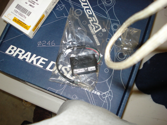

No, I don't have one of those installed. I didn't think it could be boost cut but this is just as plausible as my coil packs, thanks for the heads up...ill start looking.

if you are just 13ish psi, not boost cut...
guessing you have a good boost gauge.
Might not be coil packs. If yours aren't craked or anything, might just want to close up the gap a tiny bit.

ConSynx, I believe that 13 pounds shouldn't be a boost cut, but are you sure?

Mine was set to factory PSI, when I first purchase the car. Once I added the twin intakes, I was hitting boost cut. Apparently, the ECU sensed the change in air and adjusted accordingly. Once I intalled the BCC and had the car retuned with my Neo it's 99% eliminated. My Boost is set at 14 psi. But the boost guage will show that I have hit 1.02 bar occassionally at which point it will kick in. Your dyno graph looked like mine when it kicked in and it also sounded like mine too. Just a suggestion. I think you maybe the first with stock twins to hit 350hp on 13 psi. Someone correct me if I am wrong. Again, good job. If I could got that with my twins I would never go single.
like Nate said, the 1jz cut should be 15psi.
Some people rock the 2jz map sensor iirc, and get another psi or two. I never did that so i'm not sure about it, or how similar the piezoelectric(spelling error) voltage curves are.
Apexi is worthy of being correct.

Thats definatly fuel cut. FYI, boost and fuel cut are not directly related. You can be running stock boost theoretically and still be getting fuel cut.. Fuel cut is caused by the ECU seeing a large airflow value from the MAF which works out to roughly 100% duty cycle on the stock injectors. You were just flowing more air through the MAS than the ECU was programmed to deal with.
Try turning boost down first and see if you have the same issue, If you don't, you know its not the coil. If it does, then change your plugs if you already haven't. Then, if it still doesnt get fixed, check the wiring to all coils and if everything is still ok, then you can start ruling the possibility of a bad coil.

Sorry, since I don't know the psi limit for the different sensors, I suggest you search over at Supraforums.
I am pulling lots of fuel, so even at 18psi I don't see a cut, but with my twins I saw a cut barely over 1bar.
Also, 1jz is MAP.
Also, 1jz is MAP.
