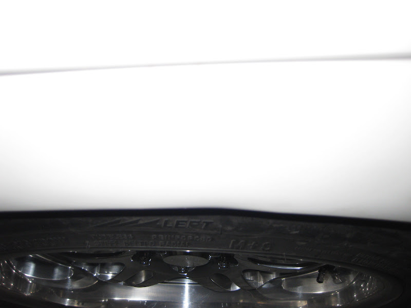

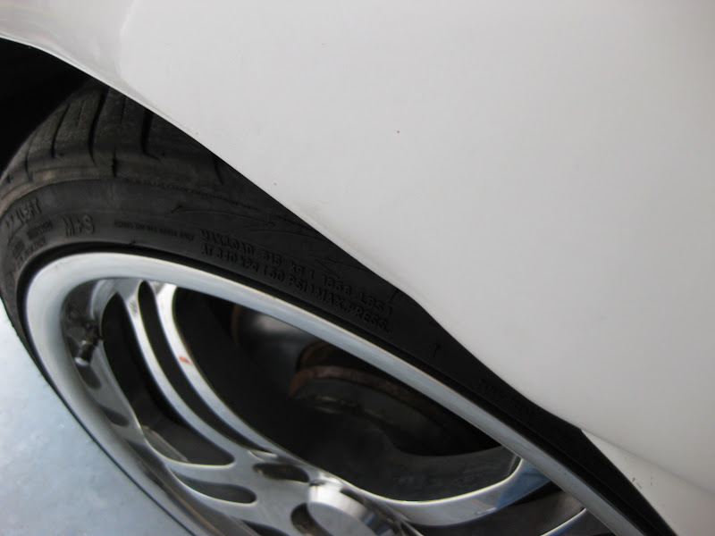

Old Oct 3, 2008 | 02:00 PM
craaaazzy's Avatar
craaaazzy
Joined: Jul 2006
Posts: 673
guys, here's picture of the wave on my fenders. i've been searching and the GS guys have the same issue. i'm going to be cutting mine where it was rolled and then massage those waves out.
