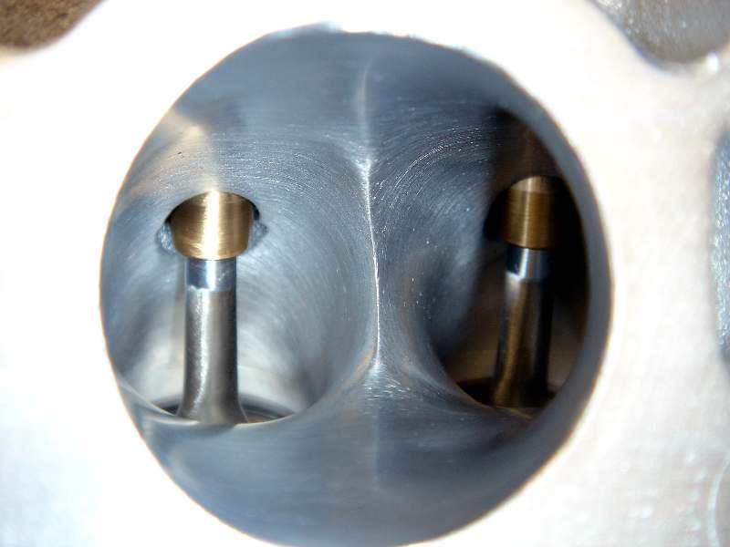

Well, I've been scouring the internet for a couple days now with no luck, so I thought I'd try posting a request. What I am looking for is a decent straight on picture of the exhaust port on a 2jzge and a 2jzgte, preferably minus the headers/manifold.
If anyone has these, or has seen them somewhere and can link me, that would be awesome.
EDIT: Figures, search for a couple days, ask for help, immediately afterwards, something turns up. I could still use a pic from a 2jz GE

Dont know if this is what you want....NA head with port and polish.

thanks for the pics, but I'm looking for a pic of the 2jzge basically identical to the one I have of the 2jzgte. Reason being that an acquaintance of mine has an extra gte turbo manifold that he's not using and doesn't care to sell, so I may be able to get it on the cheap. Not that a cheap tt manifold is of much use to me since ge and gte manifolds are not interchangeable. Of course this really depends on how different because If I can cut/weld the tt manifold to fit the GE, then I could save some cash on my na-t.

looks to me that the ports on a gte are oval and the ge are circular. think itd be easier time/labor wise to just buy a turbo manifold for the GE.

Yea, I noticed that too, I suppose I'll have to search around and see if I can't figure out the diameter of the narrowest portion of the oval and compare it to the diameter of the circle. It doesn't look promising unless the GTE ports are way bigger, which I doubt. One can always hope I guess.

GTE head is different from GE, it will not bolt up directly, the time and effort you put into it will end up costing more than one off ebay, unless hes going to give to you for free then dotn do it, just get one off ebay. if your trying to cheap out then dont even bother trying to turbo your car because its going to get expensive quick.

Yea, I know that it won't bolt up, that information ius everywhere, but what I haven't been able to find is why they won't bolt up. I assumed it was the bolt pattern, but as I see from the pictures above, this may not be the case. If it had merely been the bolt pattern, it may have been a relatively easy fix.
