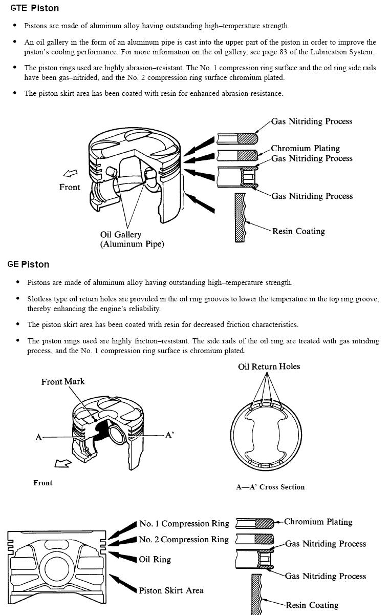

Yes Stock turbos on every good motor ever build suck minus a s15 sr. IMO I think a gte motor is just safer and once built has more potential than a ge motor. I dont like to play that lets see how long it holds game. Rather it be reliable since he has the cash too. Oil squirters for pistons and extra oil galleys and cooling couldnt be bad right? Im assuming that since thats what toyota did from the factory
Well since they have the same rods and crank, the only difference being the pistons. Both are cast and are probably about the same strength; but the GE pistons coupled with the thinner headgasket and a notch under the head chambers yield a higher compression ratio.
Stock GTE turbos arent that bad... the JDM ones are the ceramic turbos. Though when both are properly tuned/built you wont see a difference between the two. The GE has a potential to flow more air modded vs modded due to the head design. I wouldnt lay all of your faith on oil squirters
Hmm I think the Skirts are way thinner pistons are diff too. Rods probably are the same alot of turbo rods have these hole on the side tho for oil. I work on mostly nissan motors and they all have em. Yea I mean for stock pistons i would want oil squirters just because they would need that extra cooling. Unless you go some good forged pistons then it really wouldnt matter. But overall IMO Its easier to do everything starting with a gte motor more and better parts. Just less of a hassle I would rather have that tad bit of extra comfort lol.

But not a lot of facts. You really should get the New Car Features book for the '93 Supra, it would kill a lot of these speculative discussions.

Hahhaah even the pic you posted says the skirts have more protection. I only posted my opinions no need to have to prove everyone wrong and know everything

Skirts are resin-coated on both, pistons are almost identical but with higher compression on the GE.

HMM yea I see that now but like I said it is just my preferance
