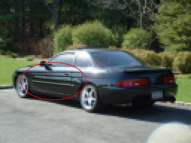

its the side skinny molds on the side is glue or its has insert holes cuz i'm planning on removing its....thanks-

It's glued on, you mean the one on the doors? They are disgusting and hideous. I was able to remove mine without any problem. Heat up the molding a little and use some fishing line to pry it up a little. Then you can peel it off slowly and continue heating it as you peel. The rest of the glue you can rub away with your thumbs. If it leaves a little staining behind around the outline, hit it with some rubbing compound, buff, swirl remover, buff, wax. That should make it like new.
before:
after:
