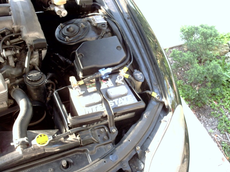

Here are the grounding points I used for my SC400
1) Batt Neg to to passenger side fender near stock air box
2) Batt Neg to ignition controller on driver side fender
3) Ignition controller to dipstick mounting point on engine block
4) Engine block to intake manifold
5) Engine block to firewall stock ground point
6) Firewall to throttle body/intake manifold
7) Firewall to passenger side valve cover/engine block

Check out what I whipped up today in a half hour. Its very simple, but the 4 gauge should do the trick. I was going to run a new pos. terminal -> alternator line but I didnt have enough wiring, and it looks like the stock wire is something like 0 gauge already
