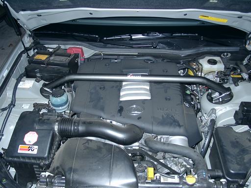

Strut bar bolts the tops of the shock absorber mounts under the hood together with a rigid bar so there's less 'flex' in the body when putting a load on either side (i.e., turning, or bumps).
Makes the car corner better and feel more 'tight'.
It's a good upgrade. I have a TRD one on my GS400. NICE piece.
Here's a pic (excuse my dirty engine!):

Also, you have to be careful when you install it. Make sure there is enough clearance between the bar and the top of the manifold otherwise you will hear and feel vibration when the engine is running. A few adjustments of the bolts to increase the space will fix that.
