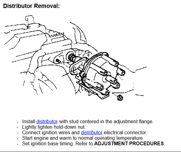

Question Question about Distributor location
I'm most likely just overthinking this, but when the distributor is in, does the procedure here account for the tooth moving? If I do it the way Lexus intends, the tooth will be misaligned with the marks by one tooth when placed inside. Is this correct? If not, I was thinking of putting it in one tooth off so it's aligned inside.

I'm going to assume that is a JZ engine, if so do this.

The only way to set the timing correctly is with a timing light. Jump the pins in the data port, sorry don’t recall which two but it’s on here somewhere. Move the distributor til it’s 10 degrees, lock it down, pull the jumper.
You are correct it will turn when you engage the gears but it should point to no1 plug wire when engine is on top dead center.
Correct, line up the housing as stated in the directions. Have the rotor pointing BEFORE #1 when installing the distributor so it is pointing @ #1 when fully seated.
