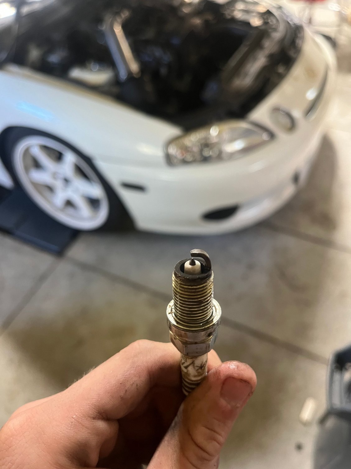

So today i went to pull my spark plugs to check their condition. At first i had my car idling in drive to let it warm up, and i noticed my middle coil pack was arcing onto my engine. Previously i had mentioned a clicking noise that i had suspected to be a relay but it turned out to be the electricity making that noise every time it arced. After closer inspection the connector clip was completely gone! The connecting wires were directly plugged into the coil pack with no clip supporting them. I unplugged my battery and took the coil pack and the spark plug under it out (pic below) and I bought a new clip at autozone and got the coil pack wired up correctly.
I plugged the battery back in and started the car and it started up amazing, my idle was sitting higher around 800 in drive as opposed to before at around 500, but right when i pulled off i heard my engine start to misfire worse than before i replaced the connector. as i accelerated it went away. I drove around for about 10 minutes and pulled into a parking lot to sit there so i could see if it was idling as poor as before. After sitting in d for about 1 minute the rpms slowly dropped back down from 800 to 500 over the next minute and i heard the engine misfiring. The bogging is fixed (every time the connector would arc my engine would bog) but the misfire is now worse. After that i drove back home and was waiting for a cel but none popped up yet, i drove for a total of 30 minutes.
I bought an infrared temp reader today and tested my exhaust temps and it seems like cylinders 1 and 6 are 20 degrees celsius colder than the rest.
I ordered a set of new spark plug wires from ngk, a set of new denso fuel injectors, and in a minute here i’m going to order 3 new coil packs. If anyone can help me diagnose this further i’m all ears
