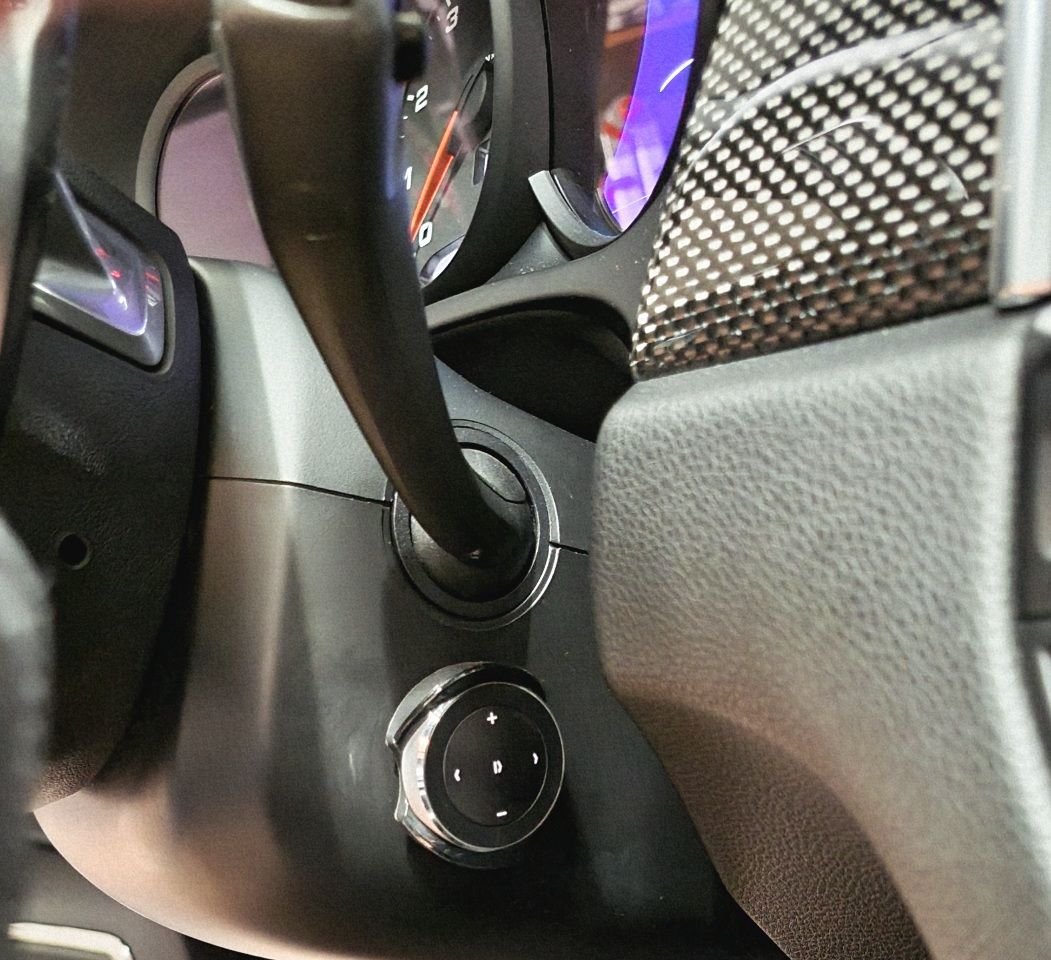

My Android phone was only paired for a short time before we decided to only keep my wife's iPhone connected, so I can't comment on my RX experience, but if you don't figure it out, you can always try a small Bluetooth remote that is mounted in a hidden location on the steering column.
That's what I used on my GS and now on my Macan which don't have native Android Auto but use the CarPlay input for Android Auto and also lack those direct controls.
The presentation was slightly cleaner without the mount but when it was directly double-sided taped to the column, it made it more difficult for battery changes. Not perfect, but still much better than using the touch screen to advance tracks while driving.
