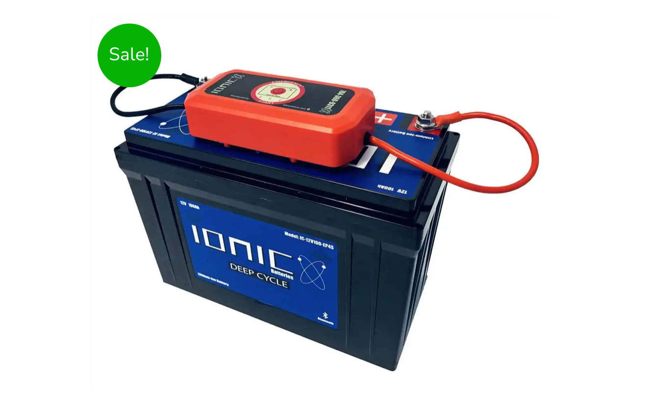

Default Ionic Emergency Battery Booster
Originally Posted by Carbuff2
We store our booster/jumper battery under the passenger front seat.
I store my Ionic Emergency Battery Booster attached to the 12 volt battery. It can be activated by a Bluetooth app on my iPhone from inside or outside the car, or by pressing a button on the unit if I didn't have my phone with me.
That's sounds like a smart idea. Have you tried the jump start yet? Do you mind to take a picture of your setup? How do you secure the booster on top of the battery? I assume you cannot close the lid after you put the booster on the battery. Thanks.
