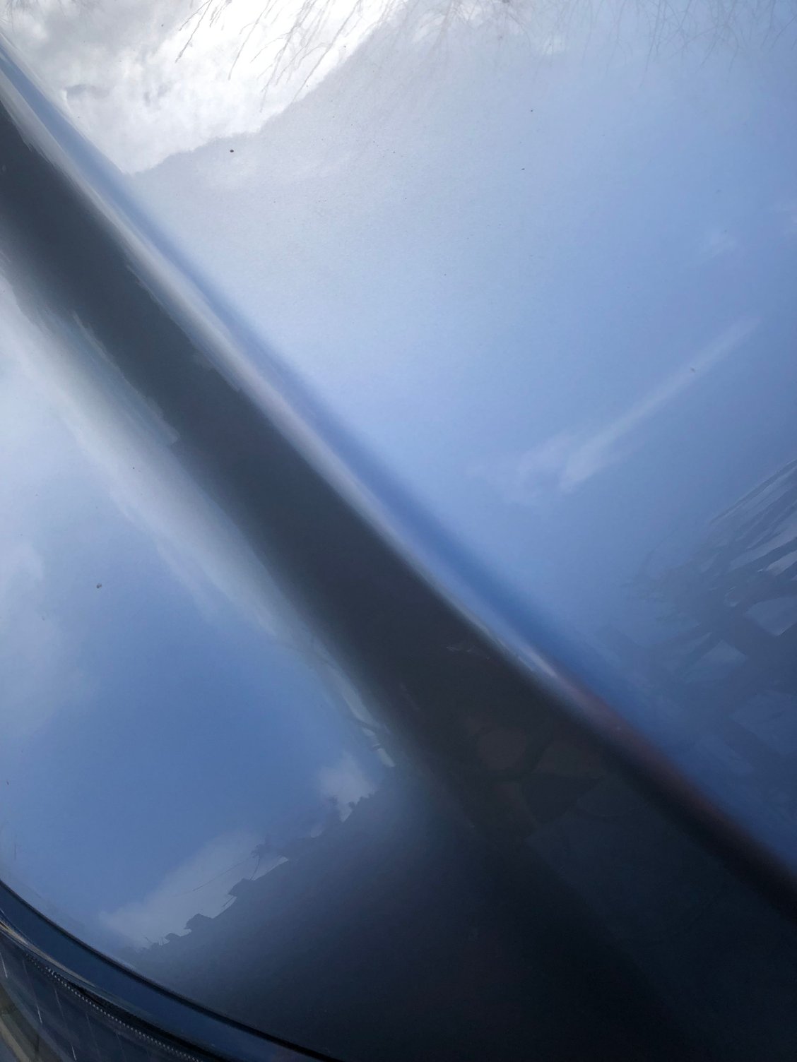

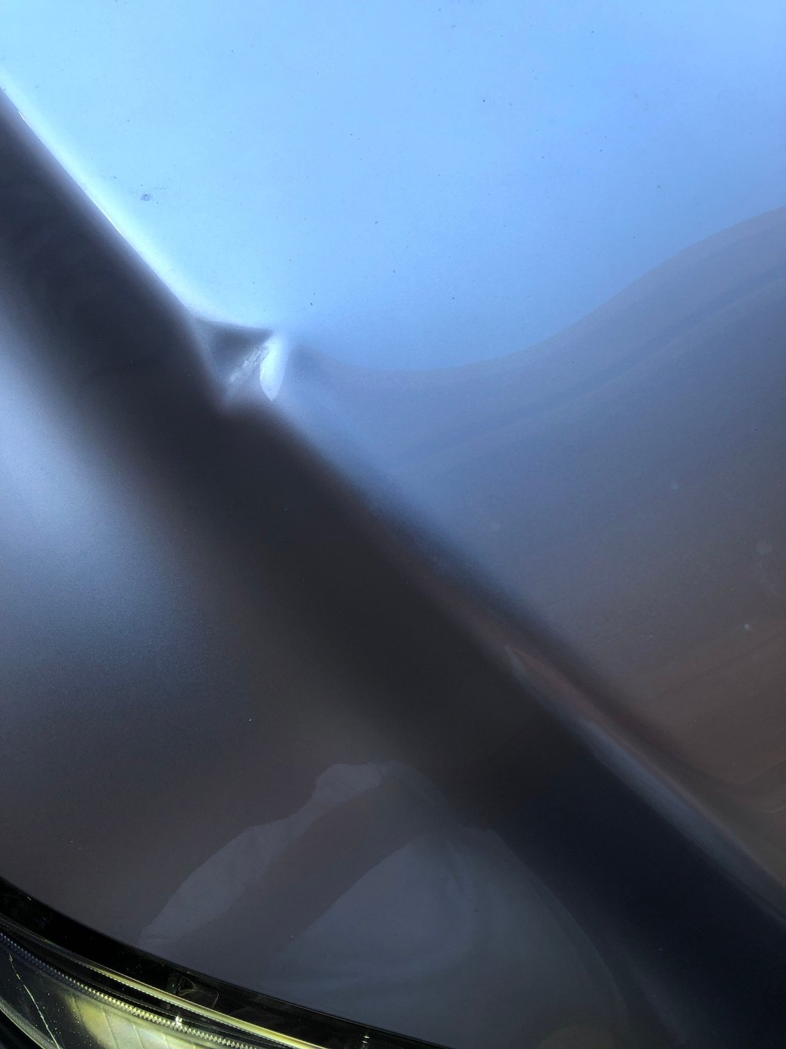

I recently had a PDR guy come to my house to remove a dent on the raised crease on the hood of my RX. I found him on Yelp with 98 five star reviews and not one single review below that. The dent was about a half inch deep and a tough one. Yelp sent my request to six different PDR people and five of them said, take it to a body shop, it will have to be painted. This guy showed up and worked for and hour and a half on this ding, using heat and a hot glue gun to "pull" the dent out with several other tools, in addition. I watched him slowly and meticulously massage the dent out. It was a bit amazing seeing this happen. The bill was $250. I gave him $300, as I think he earned it. I can only imagine what a body shop would have nailed me for re-shooting the hood. He now has 99 five star reviews on Yelp. I called him a wizard.

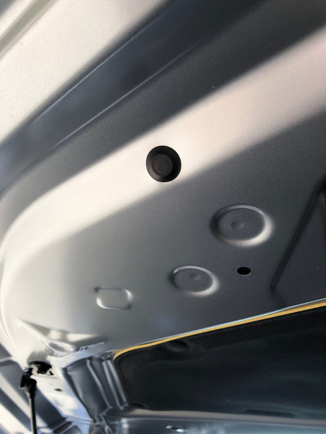

Cool...any chance you can send me a pic of that plug he put in?
thanks
Old Mar 8, 2024 | 02:05 PM
StefanoS's Avatar
StefanoS
Joined: Oct 2023
Posts: 436
Likes: 341
thanks
It's about 5/8" in diameter and pretty flat.
