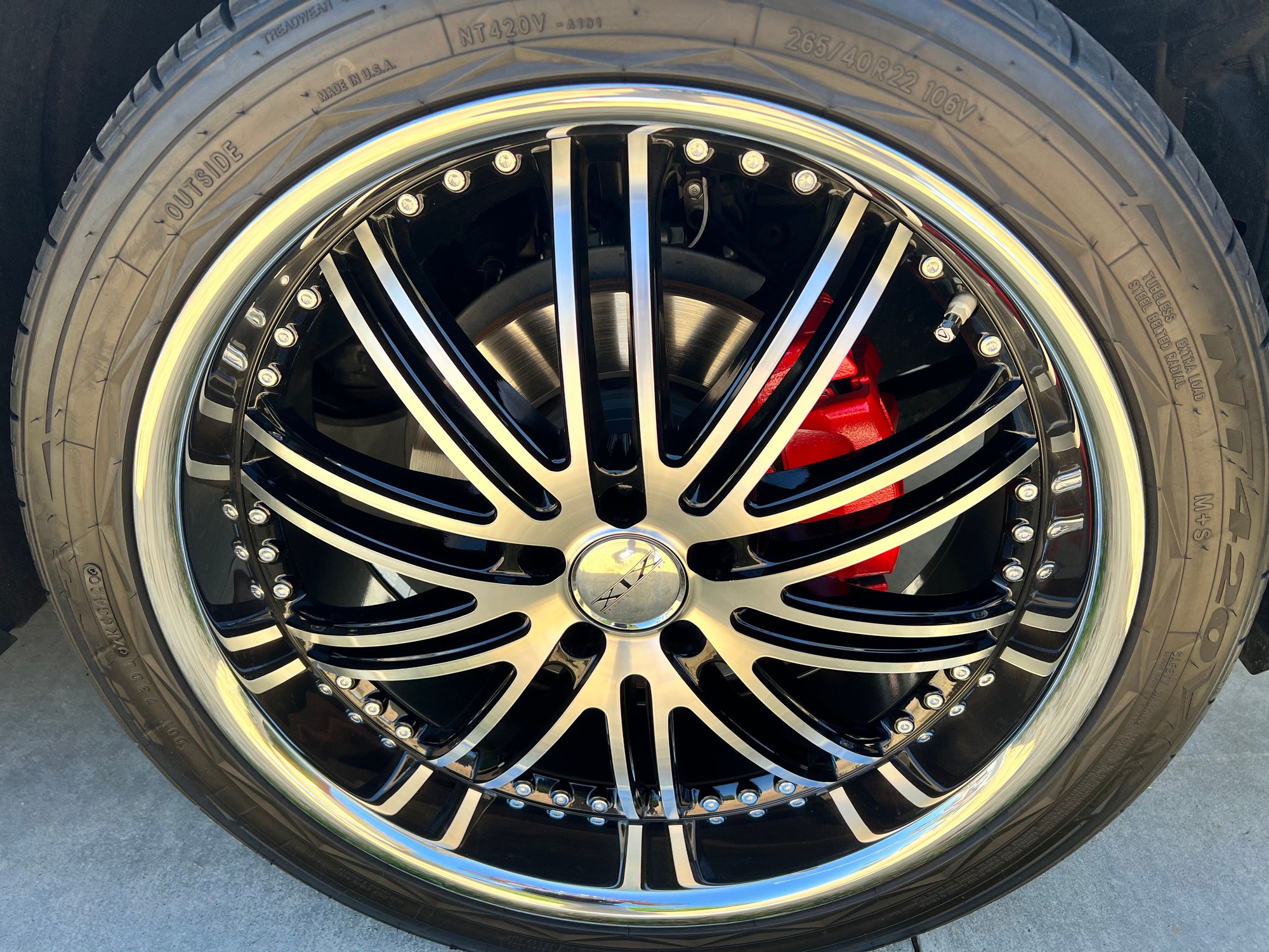

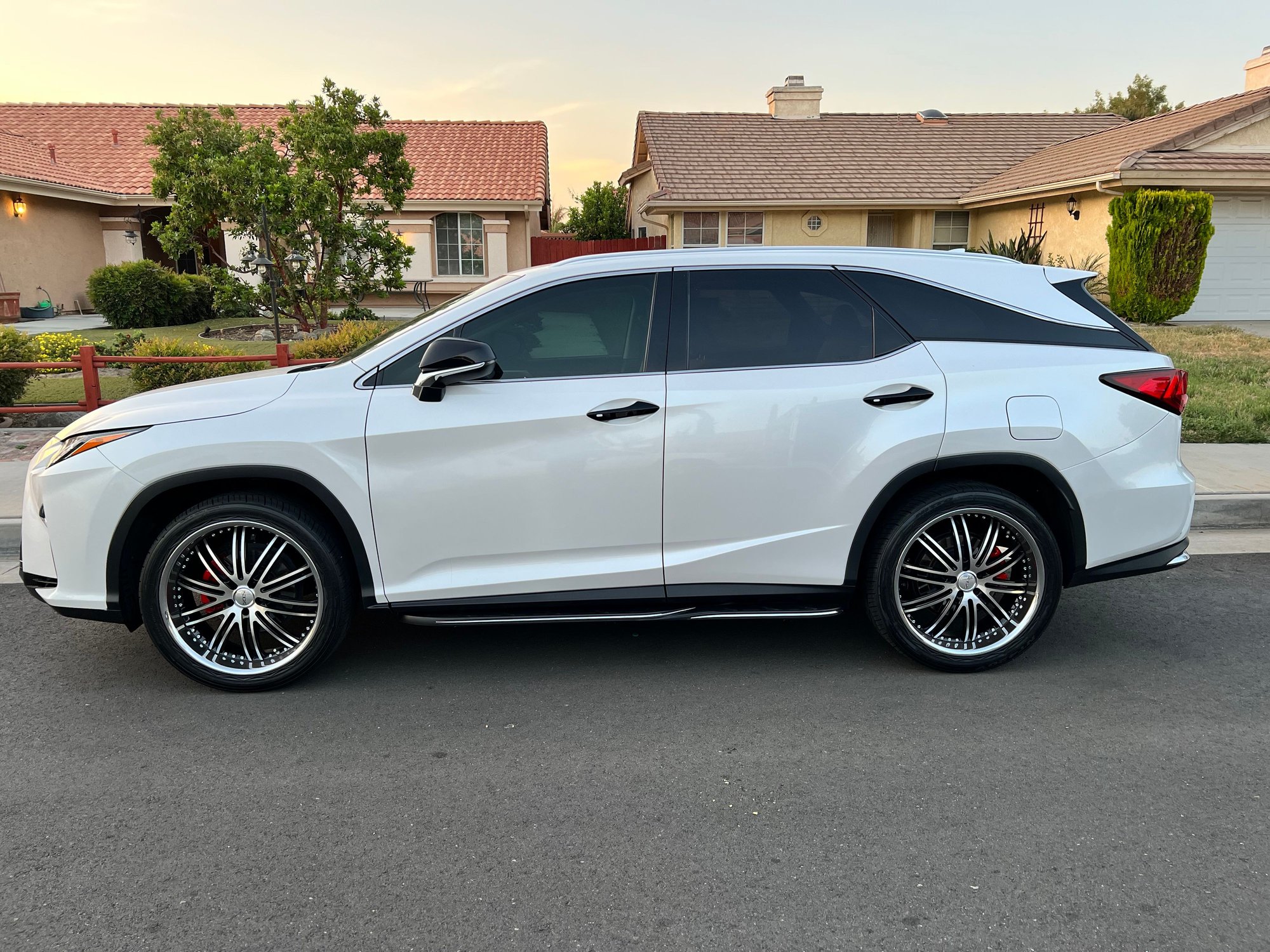

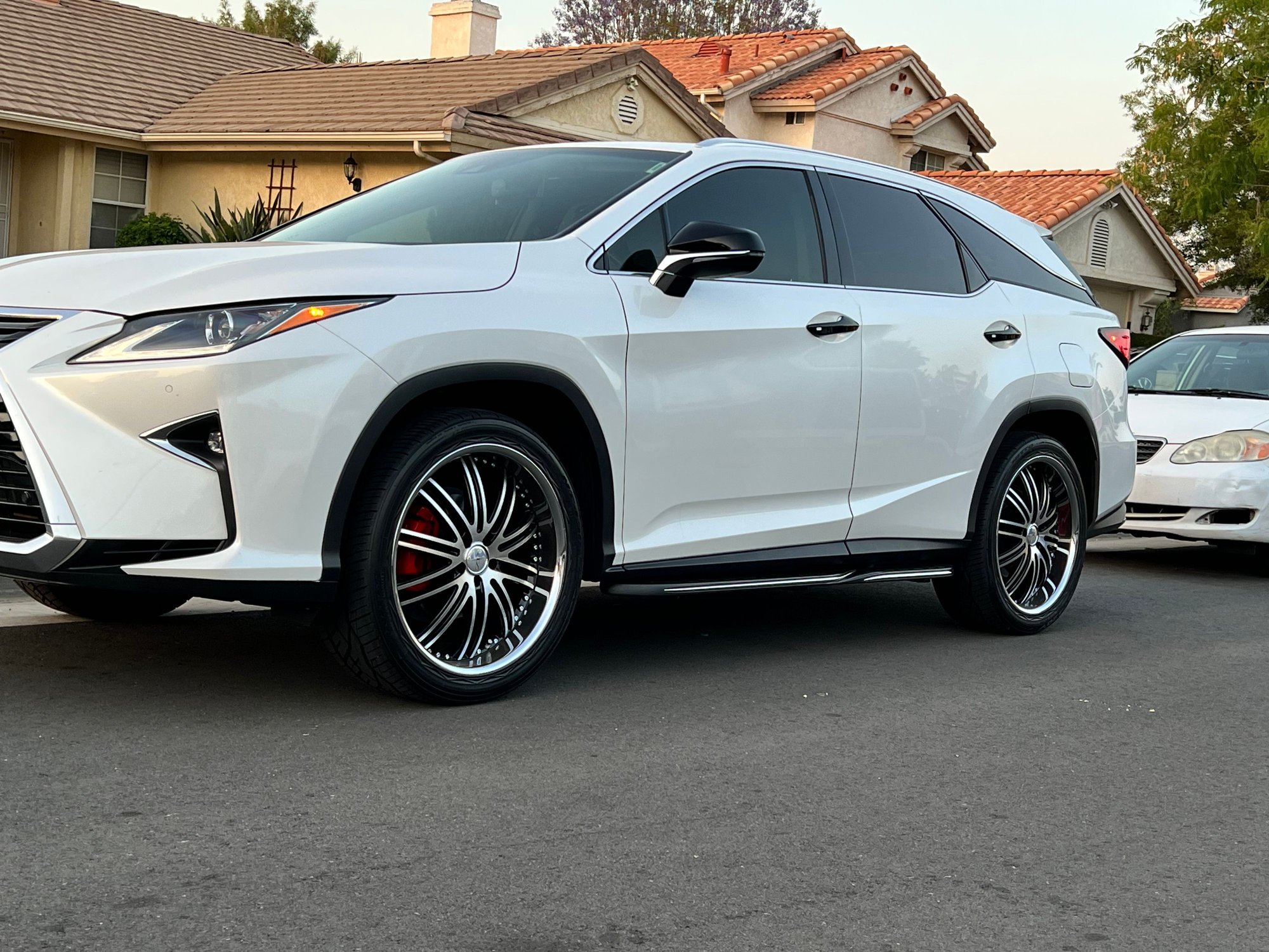

Hello, I’m new to the group but definitely not new to the Lexus brand. I have owned 3 different GS models, RX350 and now an 2019 RX350L, premium package. I have always upgraded various accessories to my taste. I am in the process of creating my own black line edition. So far I have painted the front grill gloss black, install gloss black mirror caps, gloss black door handle covers, black running boards (aftermarket), 22 inch chrome aluminum lip with black/aluminum face.
I am looking for assistance on removing the roof rail to paint them gloss black. I have also ordered a gloss black trunk spoiler to complete my black line. Anyone know how to remove the rails? Hopefully, this does not involve removing the headliner.
Black Grill
22 inch XIX23, 265 40 22 Nitto NT420V
Running Boards
Black mirrors and door handle covers
