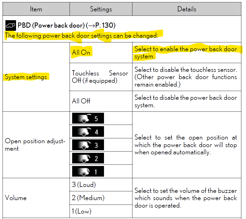

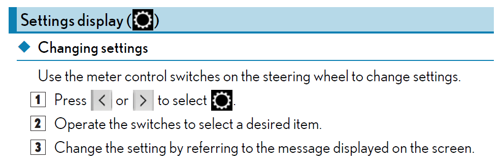

There is a specific setting to turn it off from the menu in instrument cluster.

A couple pics from the manual for the setting referenced by @toyotaman7
