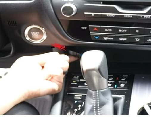

Here's the picture where to install your mouse cable. the red is where you route the cable back to the radio. The video doesn't show you how to remove the mouse. you will have to remove the side trim on the center console and then use a trim removal tool to pry the mouse up
mousepad
