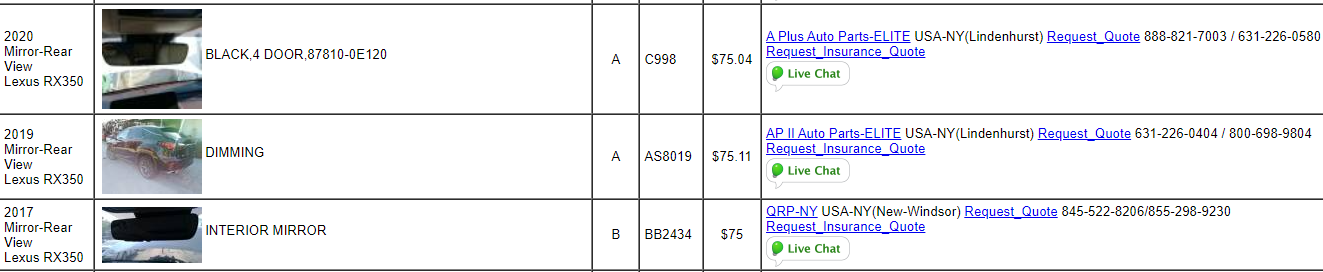

$800? Yikes! These can be had for as little as $50 or even lower from junk yards.
Use this website to search local junk yards under "Mirror, Rear View": https://www.car-part.com/
Here is a rear view mirror for $75: https://imageappky.car-part.com/imag...ck%23%20BB2434
Hope this helps.
