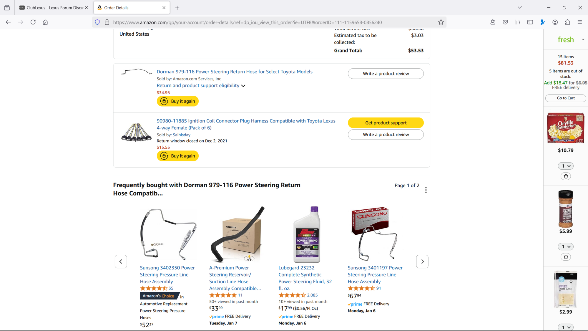

I will be changing my spark plugs soon on my 2015 RX350 and will just remove the intake manifold so that I can get a good look at the rear valve cover gaskets. I will also change out my rear coil packs for new Denso coil packs and save the old rear coil packs as spares for my front coils packs. Hopefully, my rear valve covers are not leaking(or weeping); if so then I will change out my rear valve cover gaskets as well. I will also change rear the VVT sensors as well.
If the spark plug coil pack connectors break so be it as that they can be easily re-pinned with new cheap plastic connectors. I had to re-pin two of out three spark plug coil connectors on my 2007 Highlander 3.3 V6 on the rear bank. I still have left over spare connectors that may work on the RX350 3.5 V6 spark plug connectors as well. You just need a very slim pick tool to push down the wire pin lock in the connector while pulling on the wire. I just swapped out one connector wires at time to ovoid any mix ups.
The Denso rear coil packs are still working in my 2007 Highlander 3.3V6 four years later. However, to be honest the OEM front coil packs are still working as well 18 years later; so the OEM coil packs are good quality long lasting units. The rear coil packs were still working as well when I swapped them out and are now my spares for the front bank. So the rear coil packs probably do not need to be swapped out unless they do fail.

Where are you sourcing your coil re-pinning connectors from? Back in 2018 I had to re-pin a VVT pigtail connector on my wife's 2006 Jaguar XK8 after I accidentally broke one of the factory ones while removing the factory alternator for refurbishment. I believe I found the VVT pigtail replacements at Rockauto.

To be honest just some cheap Amazon sourced units. They are still working or has not fell apart four years later on the old Highlander. The plastic seem to as good as the OEM connectors or good enough, however the cheap connectors will probably break when trying to remove them the next spark plug change( in about 6 years or 10 years total). I removed(unpinned) the cheap wires that are included and just use the plastic connector housings with the OEM pinned wires.
