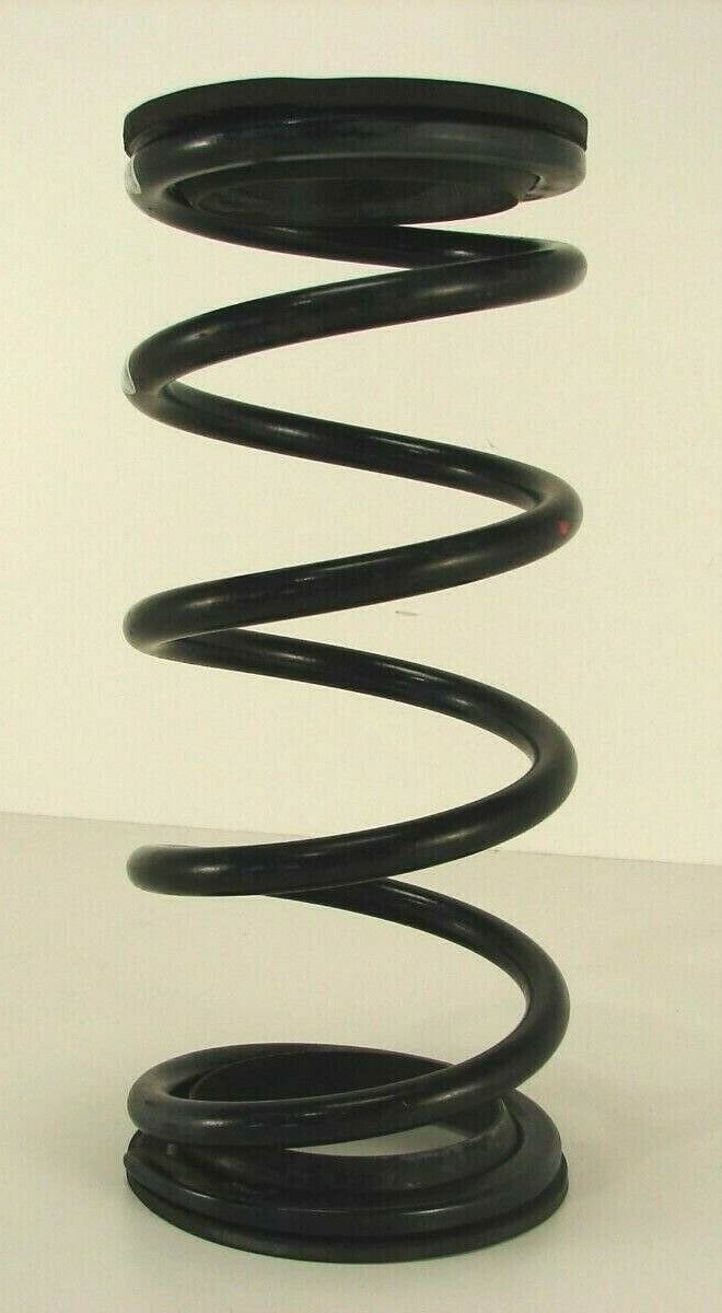

I have been driving on my B6 rear shocks & front struts and have noticed that while the ride and handling has improved, the rear is feeling a little on the softer side compared to before. This may be due to the fact that the 2014 Highlander (which the shocks were sourced from) could have stiffer rear springs than my F-Sport. I wonder if we can put the rear springs from the RX450h on the back to help stiffen up the ride. Part numbers indicate that the rear sway bar is the same between all models unfortunately (it's 21mm thick). Just recently, I added 3rd row seating springs & a 24mm Lexus NX300 (2mm thicker than stock) onto my friend's 3rd gen RAV4. The following parts helped stiffen up the rear and cut back on the enormous amount of understeer that the car was originally tuned for. Motor Trend claims that the 2nd gen RX has a 55/45 weight distribution, which is pretty impressive for a non-sporty SUV. I'm sure the AWD has a big part in this as well. Now for the 3rd gen RX, it does feel more front heavy compared to my Highlander, and definitely understeers a ton more, as lift-off oversteer is possible on my Highlander after all of my mods and brackets I have made. I really want to get my RX to handle like it, the RX F-Sport is very comfortable but a boring vehicle to drive in comparison.

I am sure you can get some used RX450h rear springs from a junkyard or eBay if you wanted to experiment with them.

So some good news! The RX450h rear springs share the same rubber spring insulators as the 350, and have an extra coil for added stiffness! Appears almost identical to how the 3rd row seating springs replaced the originals - an added coil for extra stiffness. I will be picking up these springs as soon as I can find them for a decent price, they're extremely expensive on eBay! One spring cost me more than the Moog ones that I got for the RAV4!
2010-2015 RX350 Spring (AWD)
2010-2015 RX450h Spring (AWD)

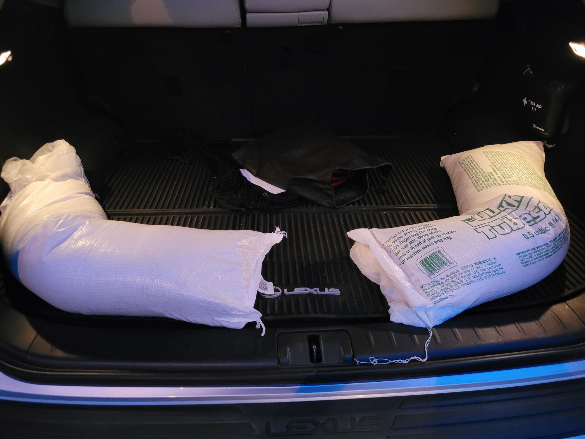

Updates: --
I have now completed following items: -
1. Added 2 tube sand bags in back of the trunk. 60 lb weight each. Adjusted locations couple of times. Attached photo
2. Changed tires from stock Dunlop to Michelin Premier LTX
--Observations:--
1. After both step 1 and 2, there is a Dramatic improvement in the quality of ride. On great surfaces with only minor imperfections (highways or interstate), the Lexus absolutely glides, almost gives the proverbial 'riding through the clouds' feel. road noise is minimal to non existent. On bad concrete hard roads with plenty of imperfections (suburban interior roads etc), the ride quality though not quite as good as highway, but so much softer and quite than before, it is almost pleasant. The lane change paint and tiles and minor bumps are felt, but not nearly as harshly as before, just a slight vibration, which is fine.
2. Bottom-line, my saga of 6+ years of nightmare ride quality is about getting to an end. and it all took is $16 ($8*2) tube sand bags and change to Michelin premier tires.
3. For about 4 days i only had sand bags and old Dunlop tires, and the ride quality had very noticeable improvement even then. But depending on the position, the car would feel sluggish if both bags were across the width of the trunk at very back or not big improvement in quality if both bags were along the length of the trunk on both sides. So, i found this optimum (maybe) by placing them a bit along length and bit across width.
4. To summarize, I feel the improvement is more than enough to not have ride quality at back of my mind all the time, and now I almost look forward to driving the car instead of shivering at the possibility of it.
5. If there is a next step to this, then changing the rear shocks would be it.....thanks !
