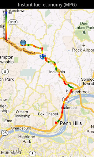

I installed an OBD II BT dongle to my 13RX350 computer port (near steering column).... all works well, but it seems tire pressure does not register on any of the Android apps I downloaded. Anyone know how to access the tire pressures?
For those unaware, its a dongle you plug into the computer port of car, and your phone or tablet, can display nearly all pertinent data on a dashboard that you design for your liking, example screen below...
