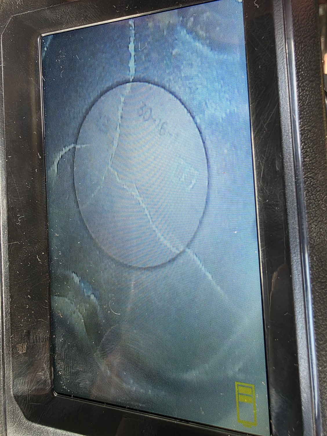

Old Sep 16, 2025 | 08:12 AM
FrankFl1's Avatar
FrankFl1
Joined: Jan 2024
Posts: 39
Ok so i tried to turn it by hand and dont go forward. Only a quarter of a turn to the left on the crankshaft. I took out the spark plugs and inspected the cylinders heads on the front of the vehicle and dont see any damage.
Could it be possible that the chain broke? This is weird asf.

If after the spark plug removal you are still stuck the next step should be to open up the valve covers and see if the top end is moving. You can be relatively less or more lucky by just opening the radiator side valve cover [it is easier].
Salim
PS: Sorry for being the harbinger of bad news.
Based on how you shared information I made the best guess after eliminating battery, wiring, starter+solenoid, and control signal to the solenoid.
