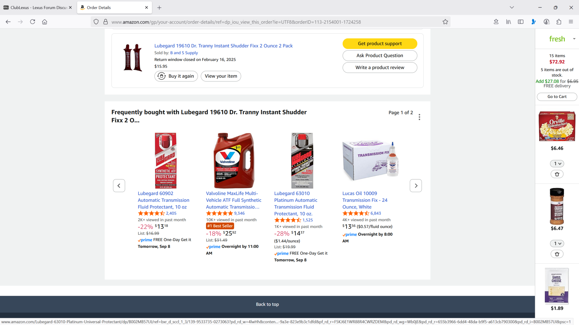

Quote: Thanks Carguy, which LubeGard product do you find works best to add to oem fluid to eliminate slippage. I see some for torque converter shudder and LubeGard red bottle has recommendation for high mile transmissions, https://lubegard.com/products/red/
I do not know which version is best, but I buy the Lube Guard in the red tube that prevent shuddering. Both versions basically seem to be anti-slip additives that help old worn clutches(torque convertor or gear set) bind to each other for better shifting or engagement. I tend to use Max Life fluid that has that type of additives in the Lube Guard high mileage version already so I just add the Lube Guard shudder tubes to treat my older transmission every so often if they have a dip stick.
I added some of the Lube Guard (one tube)to the 2007 Highlander early this year(now with over 230k miles) since it has been a while since the last transmission fluid change and it smoothed out the transmission a bit more especially in the reverse gear. Valvoline Max Life and Lube Guard is keeping the old transmission running smooth.
I like the Lube Guard because you can just add it into the transmission dipstick tube(or fill hole on cars without an transmission dipstick) without performing an entire fluid change.
