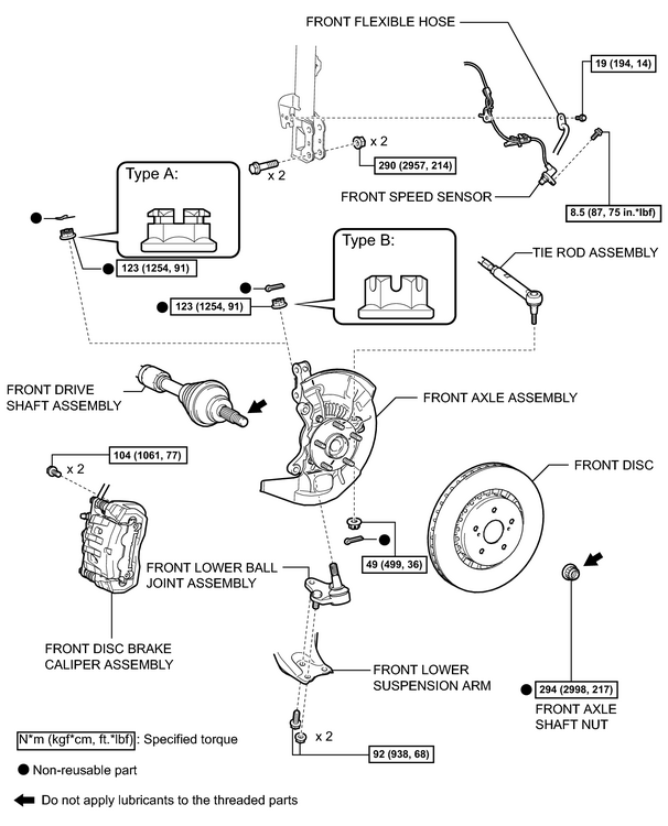

I am replacing front struts, sway bar links, lower ball joint on my RX350 AWD.
I cannot seem to find the correct torque specs online. Would anyone have them? or recommend a link that has the correct specs.

Thank you for the information, greatly appreciated!
