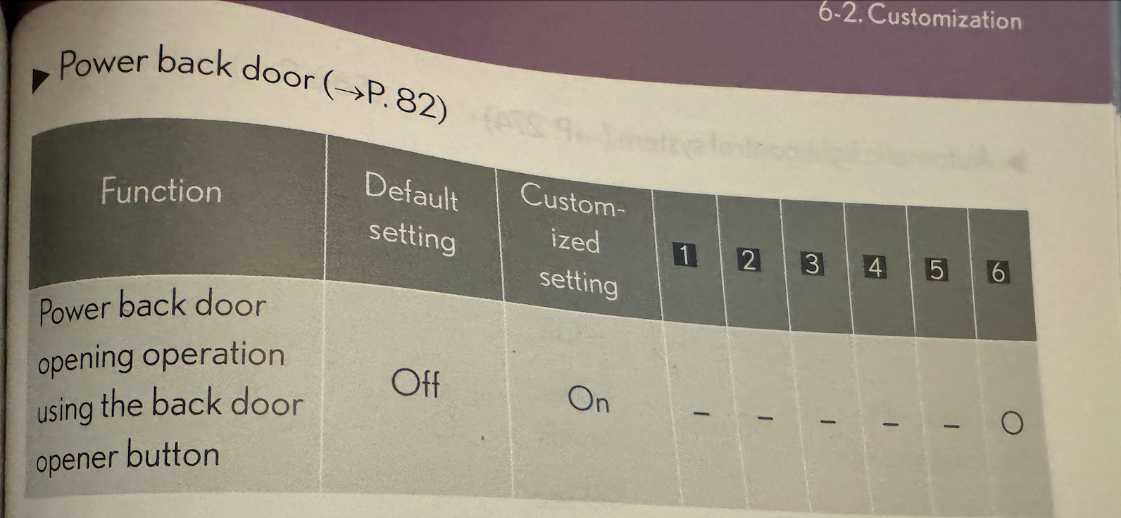

Happy to help. Bear in mind this is from a 2013 RX450h / RX350 manual. The Customizable Features list clearly states the setting can be changed by your Lexus dealer, and it's what I intend to use if and when I go to a dealer for some unrelated maintenance. I'll be sure to update this thread, but it probably won't be for some time.
Page 82 identifies the power back door. It describes the button in question is in fact the one on the door and not some other button (glove box, key fob, dashboard, etc). That page also describes its function (manual vs. powered) as a setting that can be customized by your local Lexus dealer. I did not take a picture of that page but it reinforces the information on the photos below:
If you are unable to find a corresponding reference in your 2010 manual, your chances of success will diminish considerably In that case I would agree with what salimshah wrote: "The thing you are seeking does not exist."

Here you go: https://assets.sia.toyota.com/public...f/OM48765U.pdf It's for the 2010 RX350 which I think is the one you're asking about.
In that manual, I can find many many references to the power back door, but not a single one that describes any ability to customize how that button can be programmed to automatically operate that door. All it seems to be able to do is unlock it so that you can raise it by hand.
Check my work: start by reading section 6.2 "Customization" which begins on p. 612. The customizable feature in my manual described as "Power back door opening operation using the back door opener button" is absent.
Sorry
