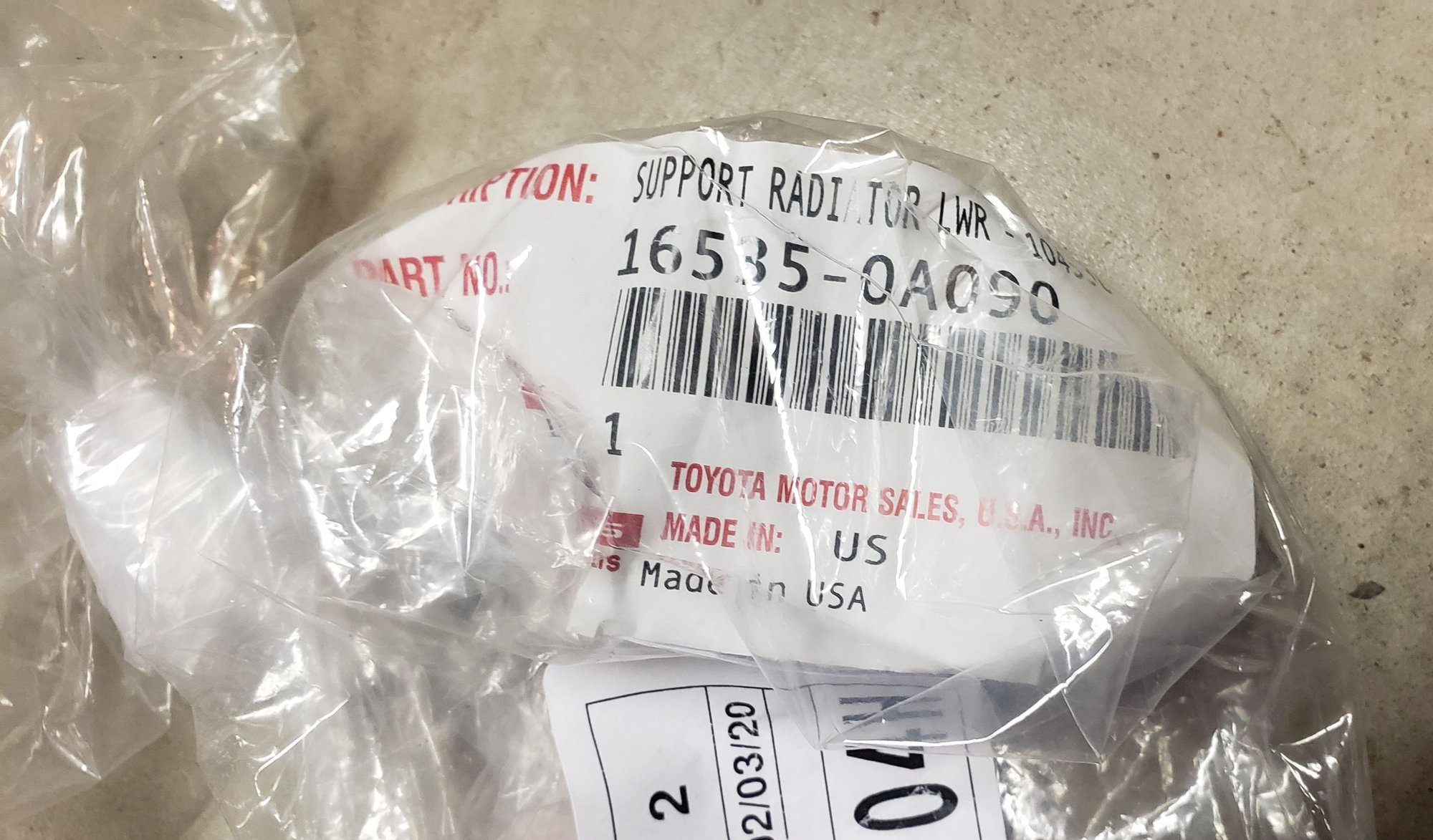

I removed the shroud radiator and condenser as all one unit I had to buy new bottom mounts because the screw was rusted on there. Here is the part number for them
Just go into amazon or ebay and type in 2004 RX330 radiator it will show you both towing package and non towing all aluminum as well the ones with the plastic end tanks. I replaced mine as it had the normal RX leaky radiator from the coolant eating the aluminum.

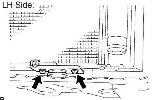

There is a HUGE improvement on the RX350 for this repair that makes a big difference.
In the video at 22:30 there are 2 bolts that go thru the lower bracket holding the condensor to the radiator and they can be removed with a phillips or a socket as seen in the video- and he ratcheted them off with ease in seconds.
This is not the way it is on the 2004 RX330 because they used plain phillips screws on my car with no way to put a socket on them- and they rust out bad.
Because mine were ruined, I had to drill the phillips screw heads, mangle the brackets, and reach in with an aircraft wrench to remove the 2 hidden screws on each side between the bracket and radiator.
My only other choice was to evacuate the refrigerant from the AC and pull the condensor out with the radiator as one piece.
>> The black arrows(below) show the hidden screws that are impossible to reach when the bracket screws rust out.
Without these issues this is a gravy job.

Yupp same issue I had that is the parts I posted pics of its the rubber bushing and those brackets. The top screw that goes through the radiator condenser and shroud is the one that wouldnt come off for me so I had to cut it off and buy new ones.
