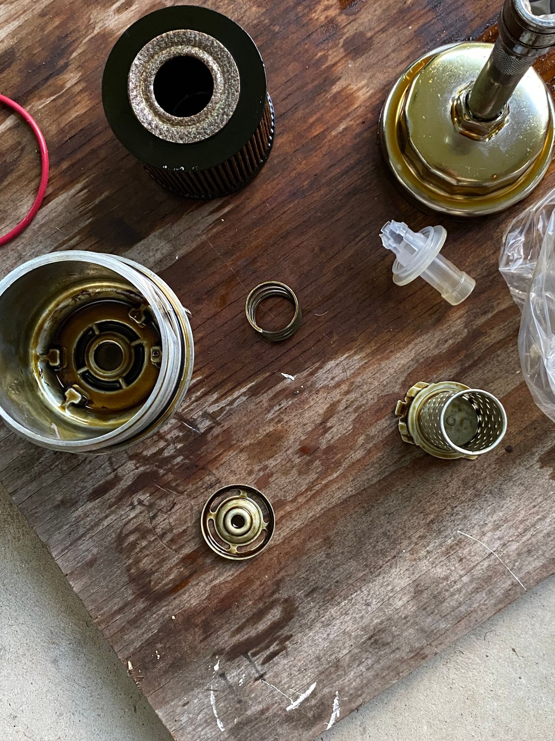

Hey guys!
I'm new here and I’m having a little trouble with my routine oil change. I was taking the oil filter out and the canister assembly came out in pieces. I tired to find something online on how to reassemble it with no luck. Any help would be great, as my fiancée and I both have work in the AM. Thanks in advance

Dorman #917-016 which is a great replacement for the oem one, as its a one piece & all you'll need is a 3/8 drive extension & ratchet......
