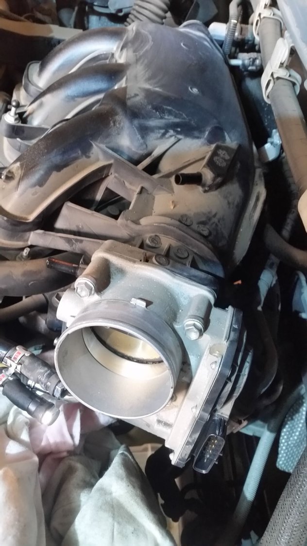

Do I need to remove the INTAKE PLENUM to replace the power steering pressure hose?

I don't think so, but space is tight. There are 2 places where the hose is attached to the engine as it comes up and around it between bank 1 and the firewall. 2 small bolts will need to be removed. The black pipe with twisty protector in pic is shown without the "surge tank" or the windshield wiper cowling, but it may be reachable with in on.

Here is a pic with surge tank on (but wiper cowl off), and you can see the black pipe and silver bracket behind the surge tank.
