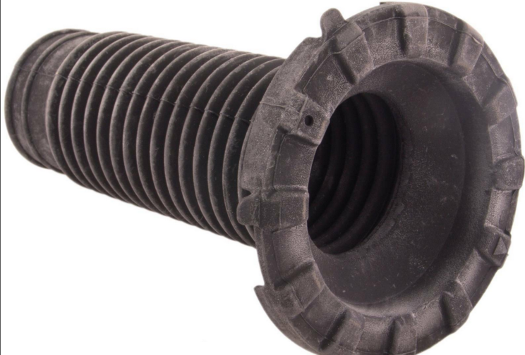

Upper Insulator and Bellow all in one.: Febest PN: TSHB-ACU30F on ebay.

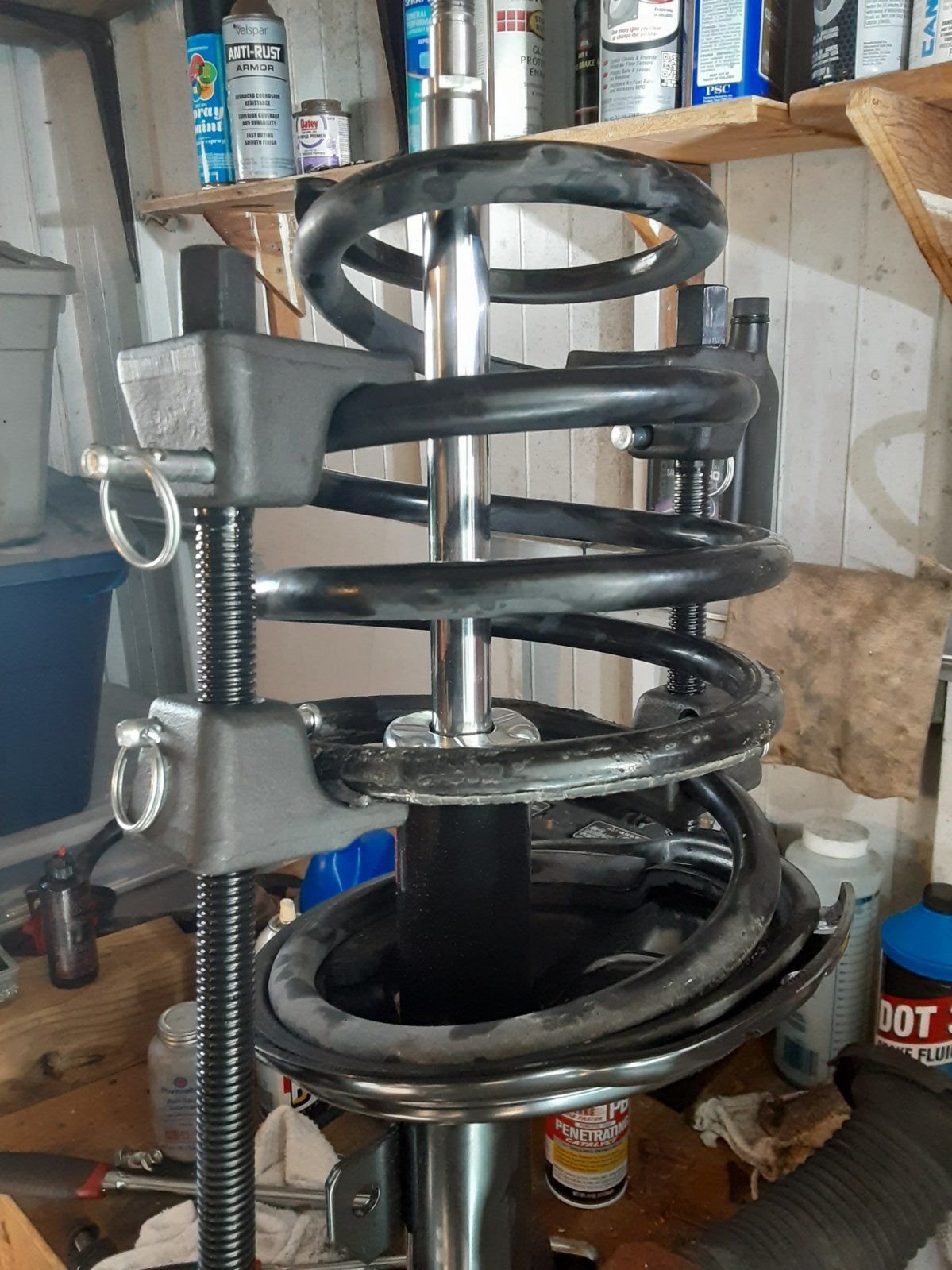

Lower Insulator: Recondition and reused- see pic below.

Febest Upper Insulator and Bellow one piece like oem.
Reconditioned Lower insulator using PB Blaster Silicone Spray.
Squeezed em with my Harbor Freight Coil Compressors.
