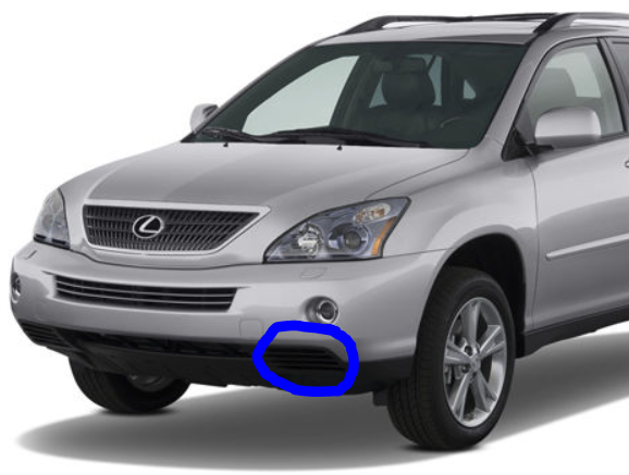

The hitch didn't guarantee anything, any new car that had one installed was a dealer OEM or aftermarket option from new regardless of the package or not. The easiest way is to find the transmission oil cooler on the driver side near the fog light. You will see a little "radiator"-looking unit there if it has it

AI OverviewThe easiest way to confirm if your 2008 Lexus RX 400h has the factory towing prep package is to check for an auxiliary transmission oil cooler mounted in front of the engine radiator (visible through the lower front grille) and a heavy-duty radiator.
Use these specific methods to check your vehicle:
  • Check the Front Bumper: Look through the lower front grilles (often near the driver's side wheel well) to see if there is an extra, smaller radiator dedicated to cooling the transmission.
  • Locate Factory Wiring in the Trunk: Open the rear hatch and remove the storage compartments on the driver's side. Look for a factory white or gray female wiring harness plug attached to the wall or tucked under the trim; if this plug is present, it is pre-wired for the tow package.
