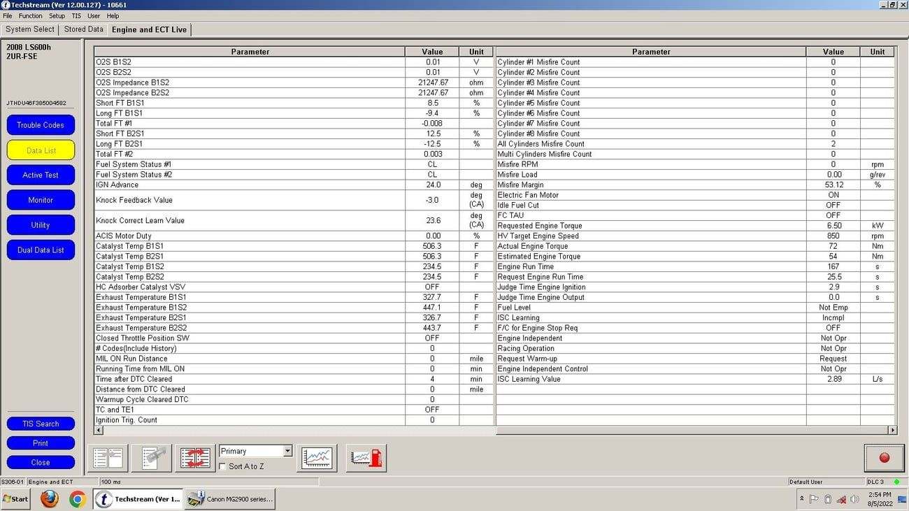

This is under Engine ---> Data list. Then scroll to the right. Note there are no misfires reported on the cylinders. This is not the best place to check. Unless you have a hard misfire that happens for an extended period you likely won't show any misfires here. Data list doesn't display minor misfires like the Monitor tab.

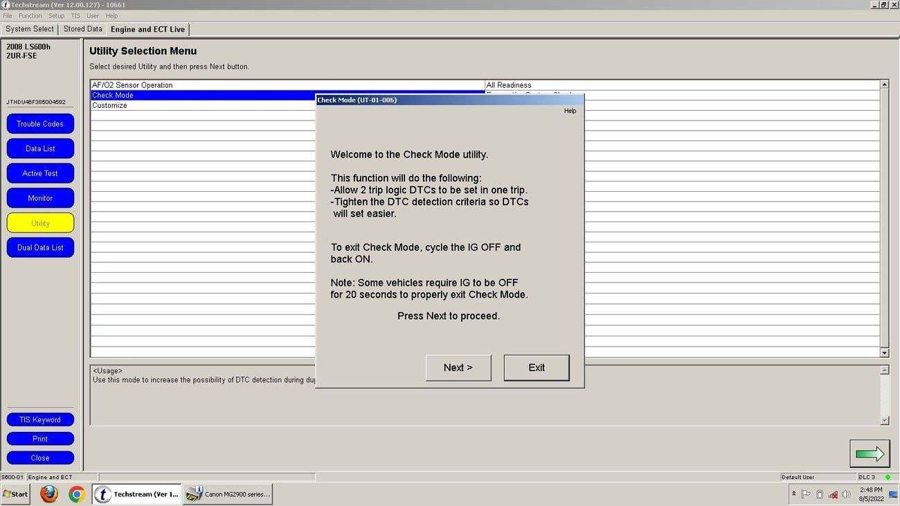

This check mode under Utility is another option that can be helpful. The criteria to set codes is reduced on some items allowing them to set dtc's when they normally wouldn't.
