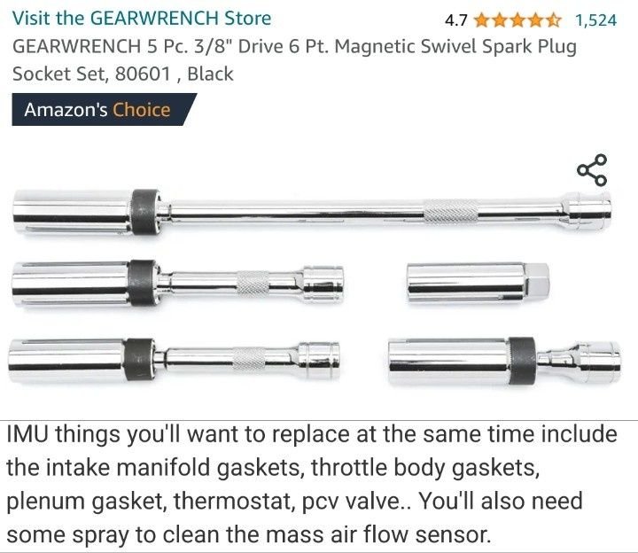

From the forums I've read I should try to tackle the following along with the Coil Overs and plugs...
"intake manifold gaskets, throttle body gaskets, plenum gasket, thermostat, pcv valve.. You'll also need some spray to clean the mass air flow sensor."

Suggested Tool set and consecutive upgrades

Did the same maintenace a couple months ago. I did not need the special plug wrench just a narrow regular one worked just fine, also didn't see any need for replacing any of the gaskets you mentioned. My PCV valve neede replacement badly, likely original with 160K miles. Front plugs took minutes, rear took maybe 3-4 hours but straight forward. You may also want to check all your vacuum lines a at least one of mine was old and cracked, they're cheap and easy replace them all. Engine air filter, spray clean your MAF, wipe down/clean throttle body. I drive pretty mild so average mpg with 2004 RX330 AWD on level ground is 22-27 seems to vary dspite my driving being pretty consistent
