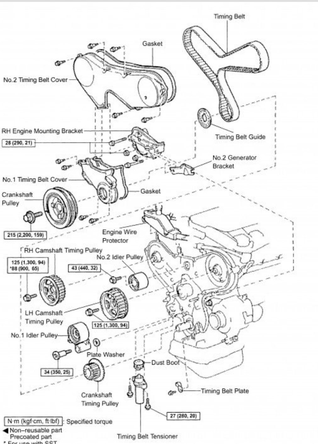

Originally Posted by tllee
the second post he mentioned cog is teethed wheel which is there for your crankshaft position sensor to detect the crankshaft. Almost nobody remove or touch that cog when change the timing belt. If you don't think so, ask Salim directly.
that “cog” you speak of isn’t in this diagram is it?
Because I removed the hormonic balancer, and then the plastic timing cover followed by the wheel washer which was the last thing touching the crank. But I did notice when I was putting the belt on, my crank was sliding forward and backwards, but not spinning because of the lil *** it rests on, but I didn’t pull it off, I just pushed it straight back into place. Could I have done something to that “cog?”
Old Jan 12, 2020 | 01:39 PM
  #36
salimshah's Avatar
salimshah
25 Year Member
Joined: Apr 2001
Posts: 16,570
Likes: 1,393
From: Austin, TX
It would be the timing belt guide or the flare behind the crank shaft pulley. The cog when it mover near the sensor, produces the pulses needed by the ecu to recognize crank position. If your engine fires up .. and you dont have any CEL then your crank sensor mechanism is working.
Follow the ECU status to trace the timing issues, else you will be following hunches.
Salim
